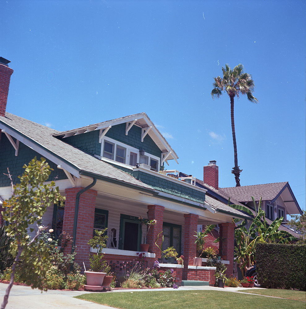

I'm struggling to get good consistent scans from MF negatives... here's a recent attempt that's especially disappointing:
This is on Ektar 100 shot with an old Rolleicord TLR, scanned with an Epson V500 using Vuescan and Colorperfect, following the procedure described here. The results are awful: murky foreground, streaky magenta sky, weird overall color cast. Gives the pictures a nice distressed, dystopian feel -- if only that was I was going for!
Every now and then one of my pictures will turn out great, but most of them look more like this. Any ideas what I might be doing wrong? There are so many variables that it's hard to know where to start.
-- Rob

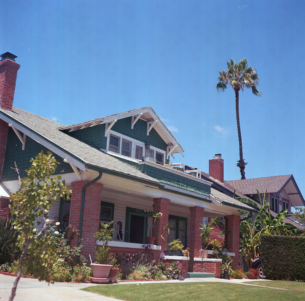

So here's one from another roll, scanned with the Epson software and not adjusted at all (the only post-processing was shrinking and jpeg-ing it in photoshop).
Same ugly vertical stripes,general murky appearance.
The outer surface of the glass is spotless, but I notice that there seems to be an uneven spotty haze on the inside of the glass. I think I'll explore cleaning that...

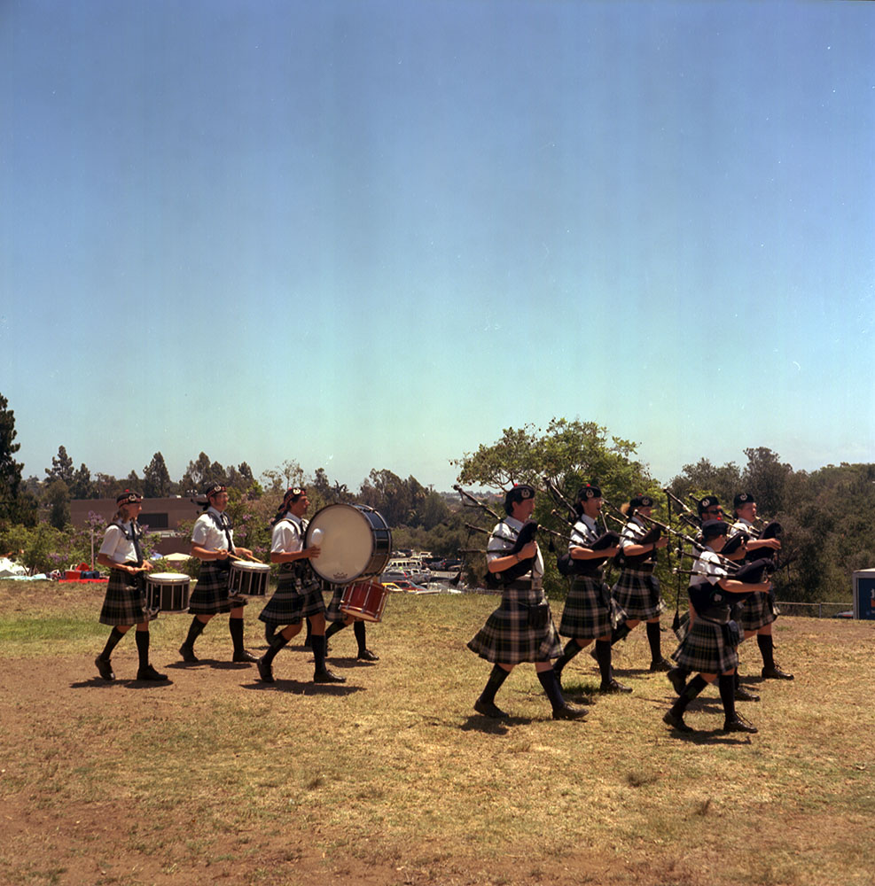

Woohoo! I cleaned the glass following the instructions here, and that seems to have cured the problem:
No more stripes!
