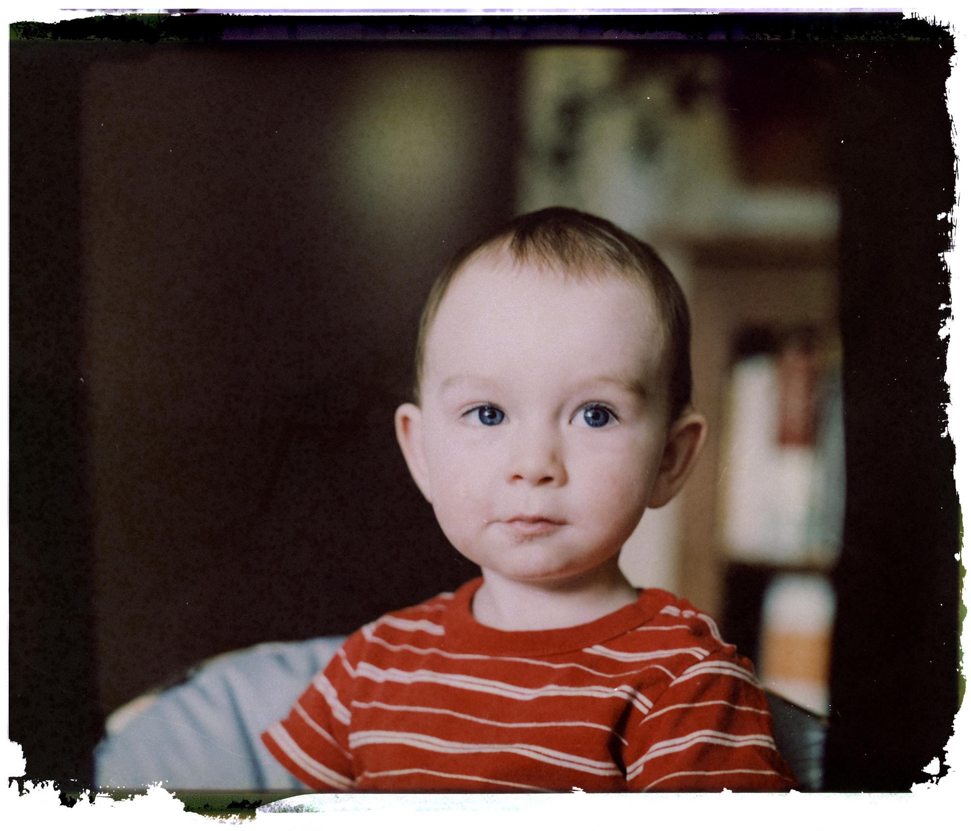

I just shot a pack of Fuji 100c instant film on my rb67, and I have reclaimed the negatives with the bleach method. I am wondering if anyone has any tips for scanning them? I have a v700 with the standard film holders and I don't think the film will fit in any of them. Will I have to use the film area guide or has someone found a solution?

I've long been intrigued by this. In my experience it is very difficult. The negative you get will be very thin and quite low in colour information.
Here's one that worked out OK:
Tortured Instant Neg Mamiya I | Flickr - Photo Sharing!
And here's one that wasn't so great:
Tortured Instant Neg Mamiya II | Flickr - Photo Sharing!
I always use warm water for the rinse part where I'm rubbing off the development chemicals gunk. It may be possible that if you use cold water (and a lot more patience) you end up rubbing off less of the actual emulsion and get a better result. Anyway, try it and let us know!

thanks Sam. I tried scanning a negative last night. With a little bit of trimming the long edge fit the short dimension of the V700's 4x5 film holder. I had to press lightly on the film to keep it from curling while I closed the edges of the film holder, but the negative remained pretty flat once it was locked in. I didn't find I had too much trouble scanning it the same way I scan other colour negatives. Attached is the file from the scanner - it has been cropped and resized but nothing else has been done (I will colour correct it and clean it up in LR). I scanned it at full scanner res (6400dpi) which made it initially a 552 MP file. It definitely still looks like instant film.
