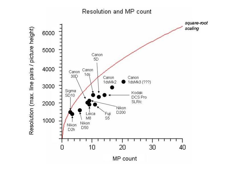

Enough has been said on the topic in my other thread titled "Is my Bronica SQ-A an 81mp camera?" that I thought it warranted its own thread.
So just to recap what's been already stated there (see previous thread):
- A dedicated film scanner such as the Nikon LS-9000 ED has a stated optical resolution of 4000 ppi, but an "effective" resolution (or "MMP" - meaningful megapixels) of only 3000 ppi.
- A Canon 5D has a 13.8 mp sensor, but an "actual resolution" of only 12.8 mp.
Effectively it would seem that a scan from a 35mm done on a Nikon LS-9000 becomes equivalent in image resolution to an image captured on the Canon 5D (considering comparable lenses). If this is true, it follows that whatever output (size/tone/sharpness) is possible from one is also possible from the other.
Does this statement hold true?

In terms of file size a scan of a 35mm made with the LS-9000 would give you a 22mp file, even though the useful information is only about 12 mp. That would pretty well match a file from a 12.8 mp DSLR in terms of detail or resolution.
However, the DSLR file has an advantage in that it has no grain, and if used at a low ASA, very little noise. Film grain will limit the useful enlargement of the 35mm scan.

I agree with Sandy. The thing to bear in mind is that there is signal and there is noise. Once you get into higher ISOs, the grain of colour film becomes a major detail and tonality killer. The newest DSLRs (including the 5D) do spectacularly well at high ISO colour. The noise that does appear is not grain and it can be treated fairly well by trading resolution for lower noise. Denoising can work very well but it always costs you some real information as well.
Disclaimer: obviously, many of us have strong feelings about the grain of b&w film. I love it, many of us love it. I know DSLR shooters who feel the need to put randomized, simulated grain into their DSLR captures. My comments about signal/noise do not imply anything about my allegiance to the grain and personality of b&w film!

I can't imagine how you can obtain FIVE TIMES the resolution from a 35mm negative then even the most exaggerated claims.
Daniel, let me correct you slightly! From the thread above, you have already seen how I feel about this whole issue, but this statement that you just made is not quite right and it is actually close to the source of why people get so bent out of shape in these discussions.
If someone says that they get, what, 100mp out of a 35mm frame, and another annoying person says that they only get 20 meaningful mp out of it, then actually that is not a fivefold difference in resolution, not even close.
The reason is that the lateral resolution goes as the square root of the mp count. It is simple to understand, but if you don't belive me, you can also prove it by going to dpreview, look up the camera of your choice, look at their tabulated and tested resolutions, and voila, you will see that a ~20mp camera does not have quadruple the resolution of a 5 mp camera. I drew up a chart to explain this simple scaling argument at a seminar that I gave some time back:
See the square root dependence? That is the source of so much unnecessary dispute on the net.
Aside: the dslr industry makes a lot of money off people's misunderstanding of what a meapixel is really worth, in terms of resolution :wink: But bit depth and dynamic range is the thing... or better yet, signal to noise ratio.
Back to the example at hand! A 20mp is, say, 4000x5000 pix. To double the resolution, you have to double it in both directions. That requires 8000x10000 pixels, or 80 mp. BIG difference in filesize, no? (And a much more expensive sensor if it existed!) But only a twofold increase in resolution. Not fourfold. So... bottom line is that comparing 20mp to 80mp, that is "only" a factor of two increase in resolution. Now I hope that you see why I am so blase about arguing that you get 20 or 40 or whatever mp from a frame.
I hope that now it is a bit more clear why reasonable people don't engage in pitched battle over debates about whether you get this or that mp count from a given frame.
