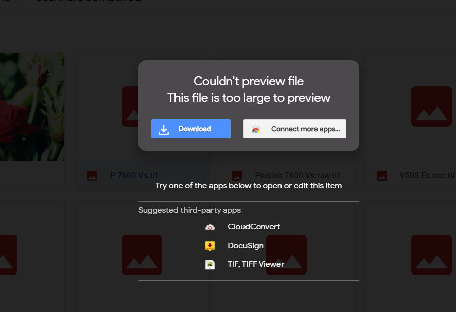

I get a "Couldn't preview file. The file is too large to preview" response when I try to view the files.

Which means that one has to download and install software to view.

I'm using Windows 10
Windows OS will not need viewing software.
The V500 should be the same as a V550 or V600 as the transparency area is all that changed and possibly a minor refinement in the software.
This is aimed at those looking for a scanner.
This is what I see when I click on a file:
For clarity, I'm reluctant to download the files themselves.

Once downloaded Windows viewer will open them, online I don't know what will work.
