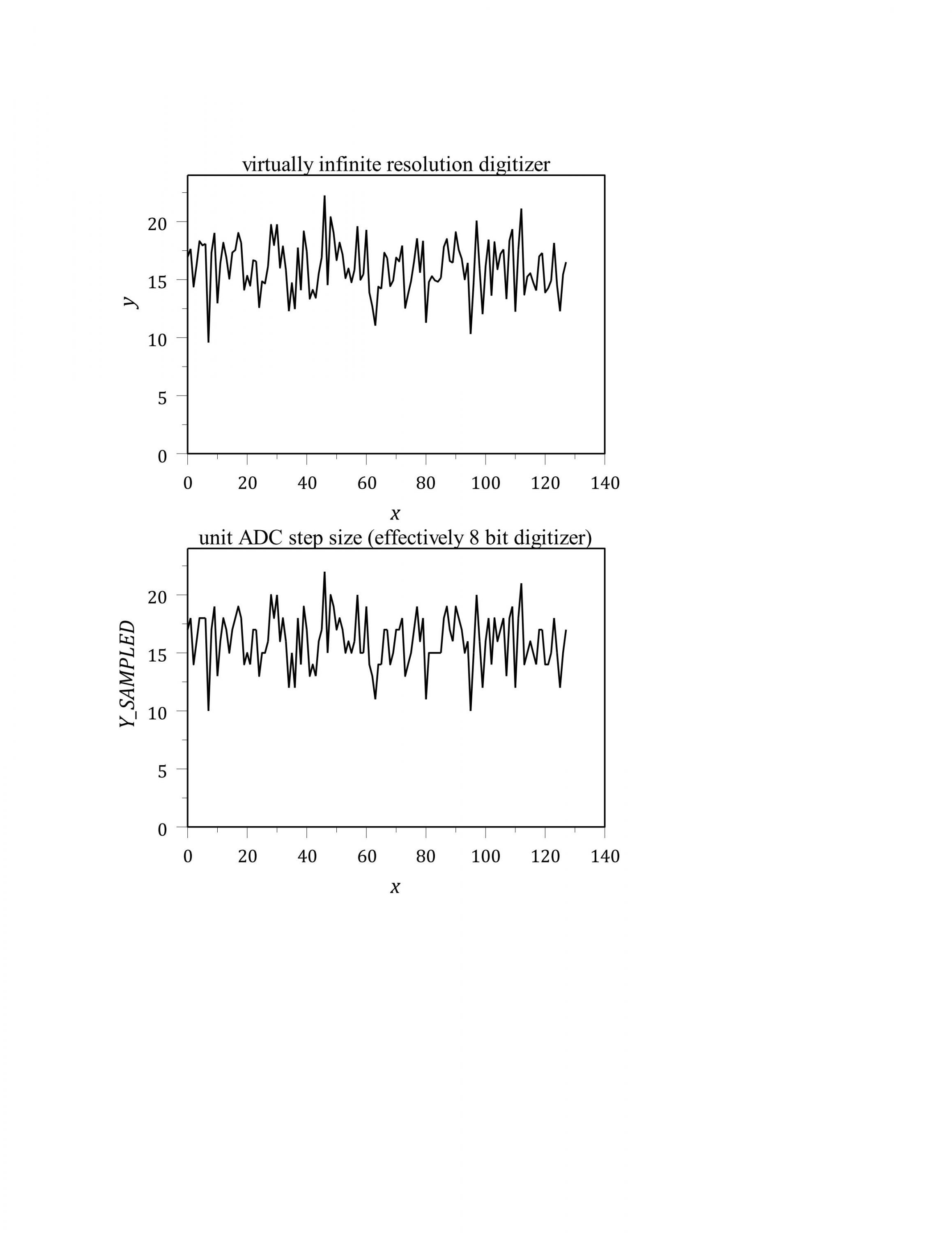

Maybe this will help explain what I mean. Assume that a trasmission through the film of 100% gives a detector signal of 255 mV.
Now assume a camera took a photo of a perfectly featureless object, such as a small patch of blue sky on a cloudless day.
Now assume that the average transmission on the developed film gave an average detector signal of 16 mV, which corresponds to a transmission of approximately 6.25%.
Now assume that because of the graininess of the film the pixel-to-pixel standard deviation on the detector of the scanner is 2 mV, which is 12.5% of the average transmission, or in other words the graininess is relatively mild.
Now assume that the sensor of the scanner is connected to two digitizers. One is an 8 bit digitizer, so a 1 bit step on the digitizer corresponds to 1 mv. At full scale this would be 255 mV. The other is a virtually resolution digitizer, but it is scaled so that at full scale it reports a value of 255 mV, i.e. 100% transmission generates an ADC value of 255. (This implies that the ADC is capable of reporting sub-mV gradations.)
Here is a plot of the output of the two digitizers for 128 consecutive pixels.
As you can see, there is no noticeable difference between the two cases. In other words, for all practical purposes, the 8 bit image is just as good as the infinite resolution digitizer, where "resolution" means amplitude resolution, not spatial resolution.

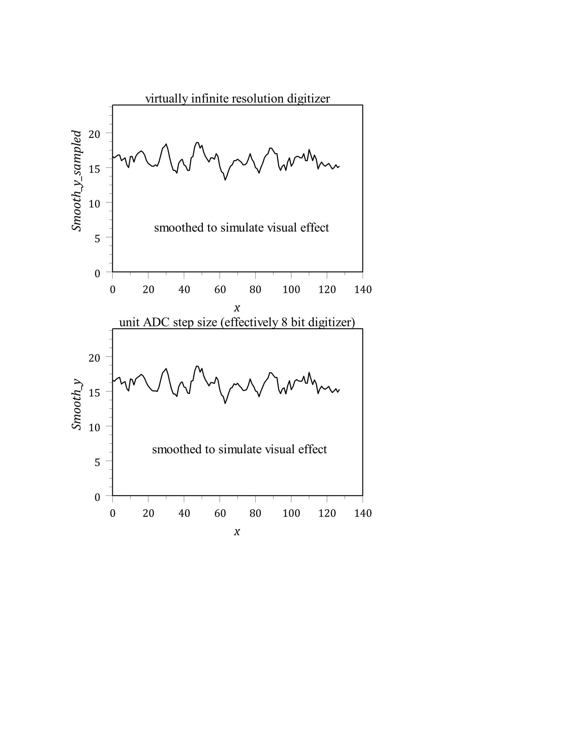

If we smooth the results a little to simulate the fact that at normal viewing distance one would not normally see individual pixels the curves look like this.
As you can see, there is even less difference between the two cases. This assumes that after digitization we have converted the files to a higher bit format (say 16 bits) before doing the smoothing, and we have preserved the relationship between relative signal and mV at the detector.
This convinces me that as long as the step size of the digitizer is somewhat less than the noise of the image then going to smaller step size (i.e. higher bit digitizers) does not gain you anything significant. This assumes that you do a conversion to higher bit images before doing any post-acquisition image manipulation.
