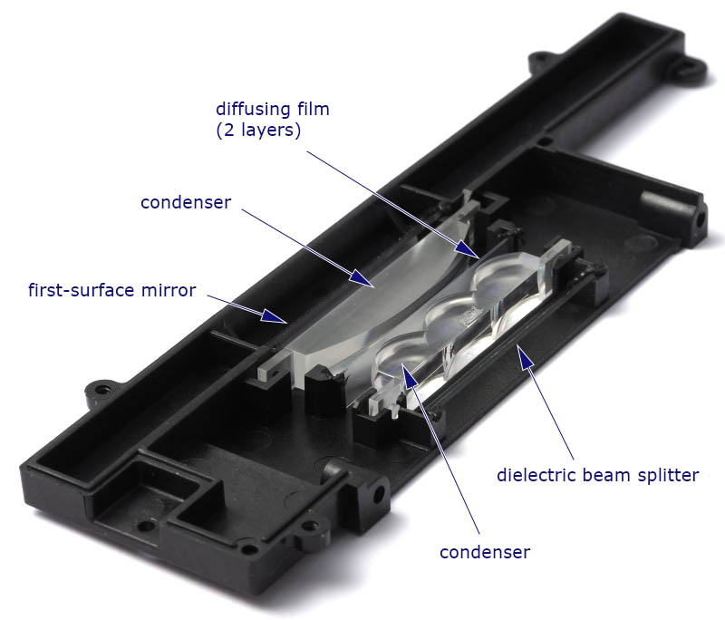

Minolta incorporated Scanhanser technology into the 5400 II, so adapting a Scanhaser product into the 5400 II is not going to improve your image output. I have used the full set of Scanhanser devices which came with my MF Minolta scanner, and it seems to work as claimed.
Actually Minolta removed it from the 5400 mark II. It was indeed present in the first iteration of the scanner but then removed when they moved to LED backlighting and released the 5400 II in 2005

Yes and no. There are some thin diffusion sheets in light path between lenses and the strongest sheet near output. But this scheme can't create real diffused light because too large distance from last diffused sheet to film . It only slightly softens direct light.
Scanhanser from other side should be placed directly in film holder as close to film as possible. This creates diffused light.
