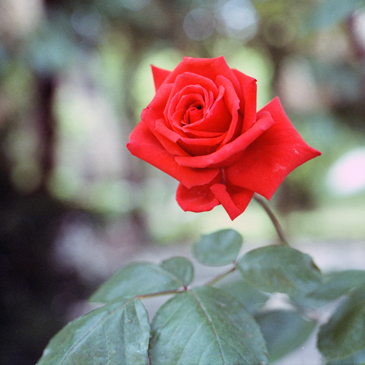

Today I processed one roll of Lomography rescale xr that I previously had respooled the right way and exposed as a normal negative. I didn't know what ISO to shoot it so I took some shots at 100 some at 200 and some 400. It came out overexposed, the best frames are this at 400. Now I come to the point, when I scanned one frame, a picture of a rose, it came out ok and the flower had a natural colour as I remember it, but when printing the same frame in the darkroom there is no way I could reproduce that colour and when the overall balance seemed ok the rose was much more deeper red and not as the real flower was. How is this possible??

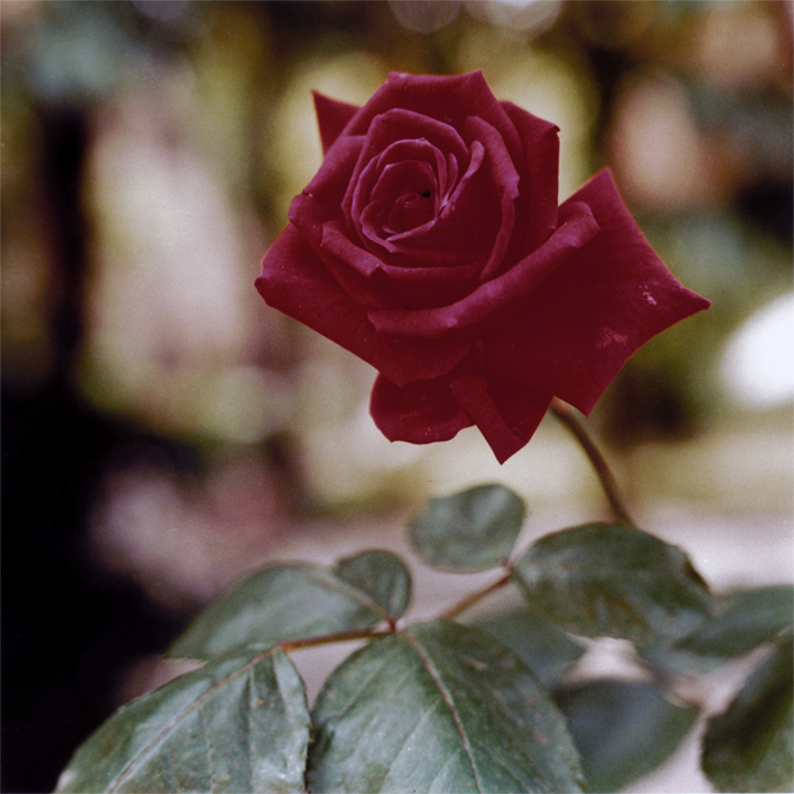

I only use colour balance in PS which usually behaves very similar to YMC filters in the darkroom, I understand that different paper may have different contrast, colour saturation and palette, but the overall look and balance should stay the same, right? T his two film were shot the same day in the same location and processed together, as you can see the first one looks exactly like the scan (the first one is a 135 Kodak Gold 200 whithin date) but the second comes out with a very different red to the scan and there is no way I could achieve that result in the darkroom (although I tried)
Kodak Gold 200
Lomography Redscale XR shot on the emulsion side, scan from neg.
my print

I must say the colour of the leaves is more accurate on the print, but the flower is not that colour!

I am not a good color printer, but my guess is that it's too dense (too much exposure) and you filtered too much yellow out (see how the green is more bluish and the rose got brown?).
Even though the photos were taken in the same day, same light and processed in the same way, the emulsions are different. Different emulsions may have very different orange masks.

I think something was wrong with the chemicals. I opened up a new batch and mixed some developer. I printed a contact proof and it matches the scan. I didn't have enough time to investigate any further so I will have to wait till tomorrow or next week to enlarge the negative.
I'll post the scan of the contact print as soon as I can

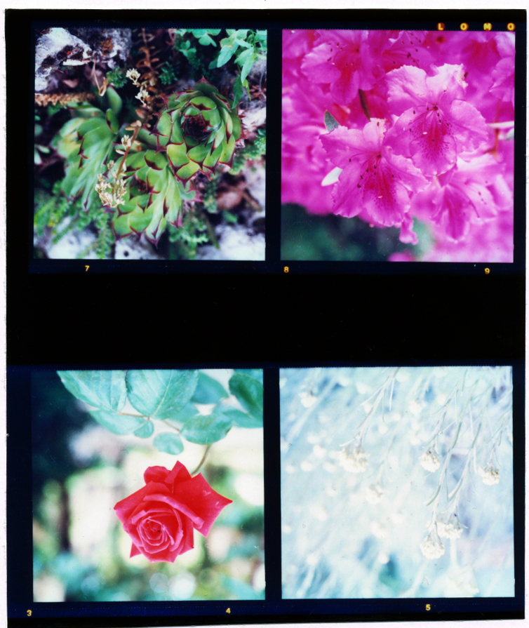

here is the scan from a contact sheet including the frame of the rose. Here you can see one frame exposed at 100ISO 200ISO and two at 400ISO
