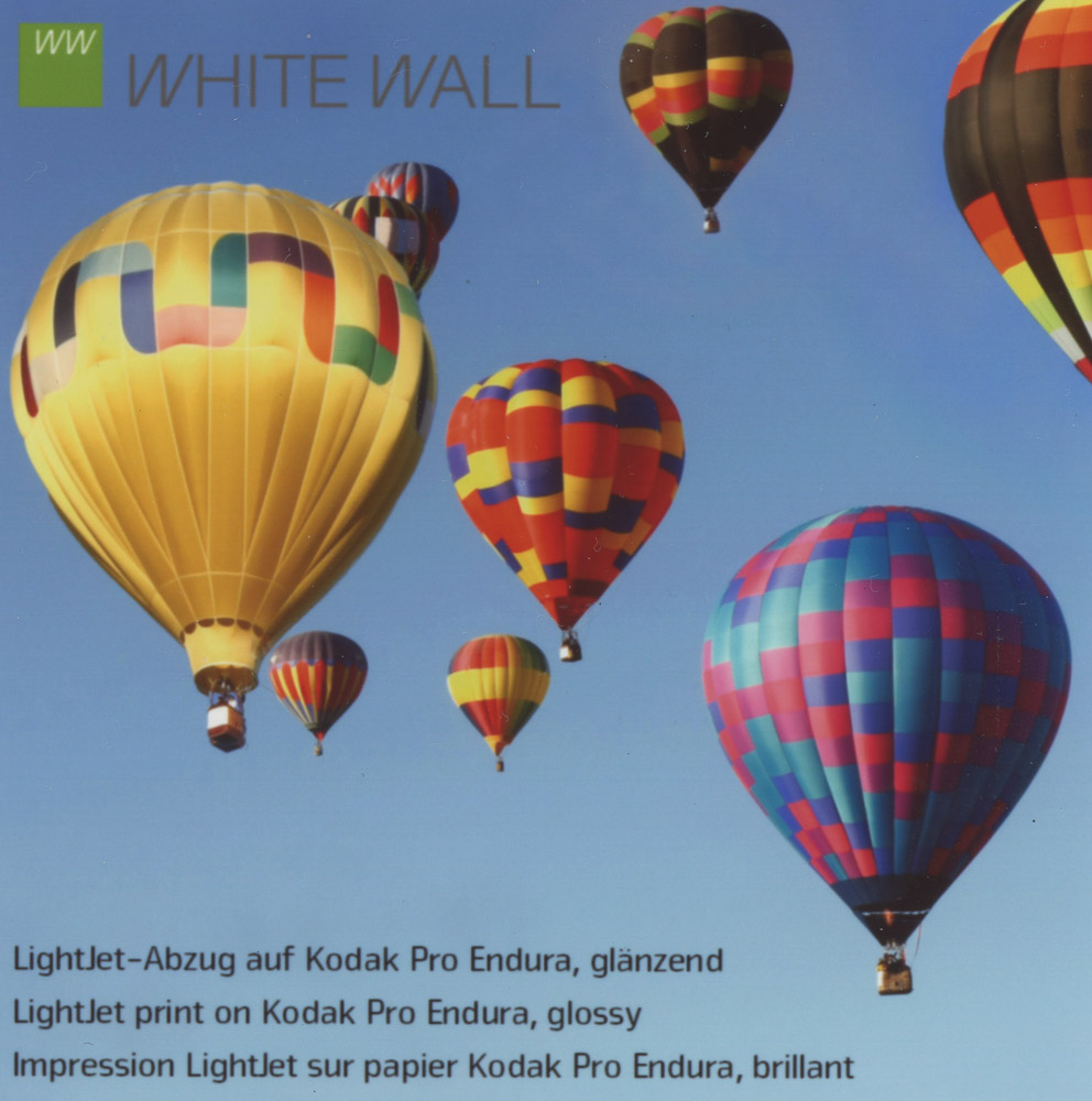

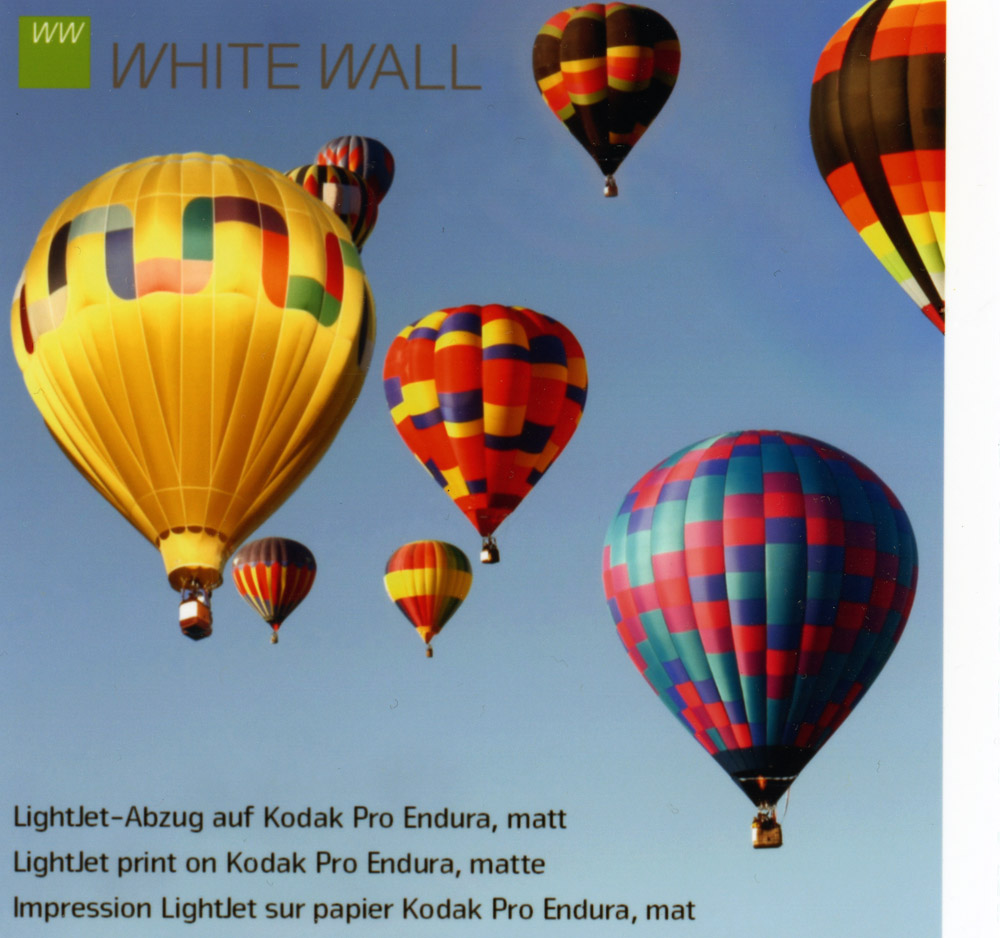

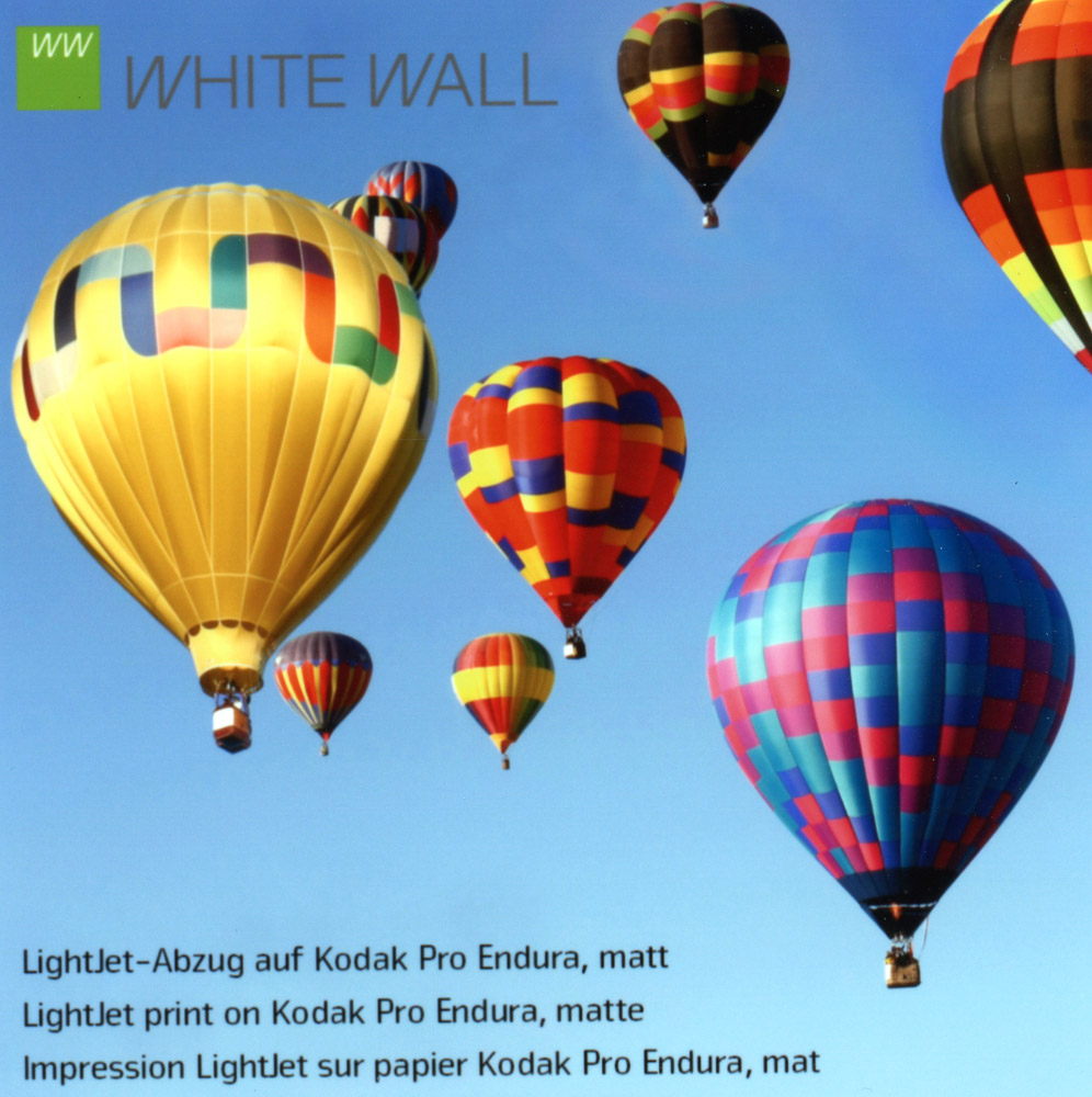

I tried to scan some test prints (10x10cm) just to see how my Epson V600 deals with different papers and restore color.
Keep in mind the V600 can use ICE on photo prints to eliminate, lessen, or correct damage like tears, wrinkles, creases, etc. It also color corrects faded photos.
