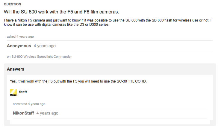

Could I use an SU-800 (SU not SB) "wireless speed light controller" on the F5 to control the output of the remote flashes? Or would that not work on an F5 for some reason?
reakeener1970
Mar 4, 2015
52
Nevermind. Just found answer on answers.nikon.usa: "... with the F5 you will need to use the SC-30 TTL cord."
