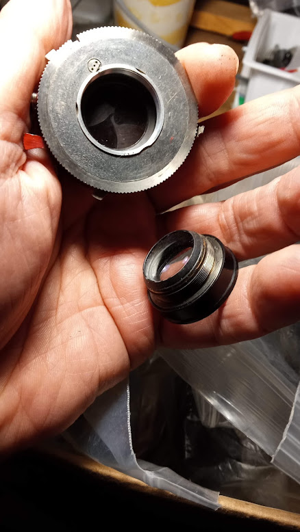

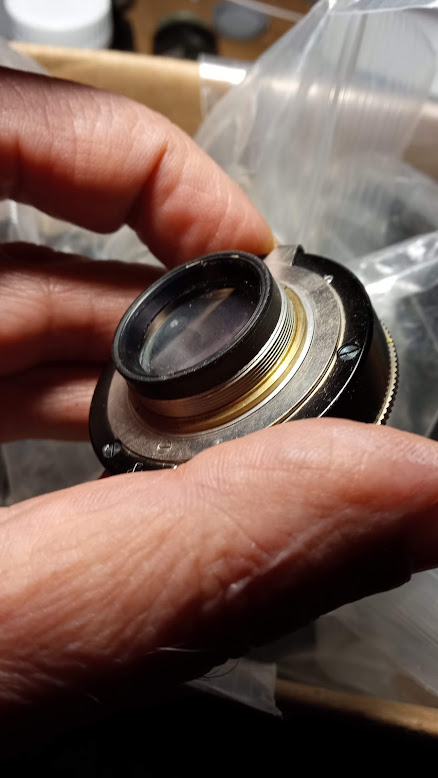

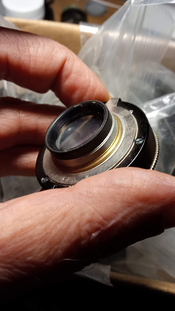

A heads-up: the most difficult thing about servicing this camera is re-aligning the two brass pins on the back of the front plate that control the aperture and shutter-speed settings. In general it's a pretty robust and simple design that is fairly easy to work on. I love shooting with it, in general I prefer it to my Rollei Baby. Here are a couple of pics....
