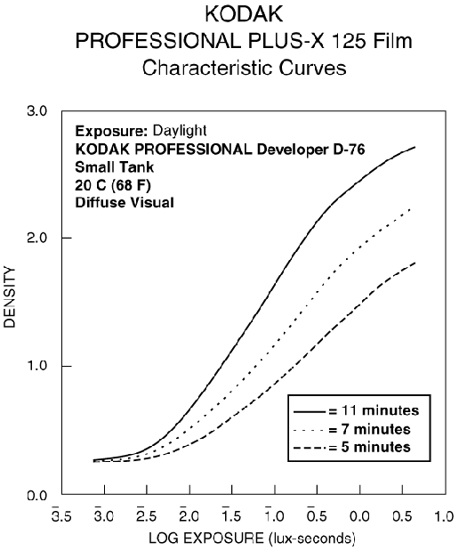

Most modern films have a generic response to changes in development time as shown in the attatchment. That lens, when used wide open, will have less contrast than when used at f16, therefore you may need to increase development time somewhat. This depends on the printing paper you are planning on using. In terms of your over-exposure, as long as the highlights are off the shoulder the negative may be printable to acceptable quality. When you print the pictures so the whites are white and blacks are black, you may notice that middle gray is too bright. That would be the result of the hight values compressed on the shoulder which was determined at the time of exposure.

Hi ic-racer
Thanks for the info about the contrast the lens gives at f4.7 as opposed to f16. I'm glad I asked the question...now I have an idea of where I'm going with this...I may do the first negative tonight and sleep on it before moving on to the second one!
