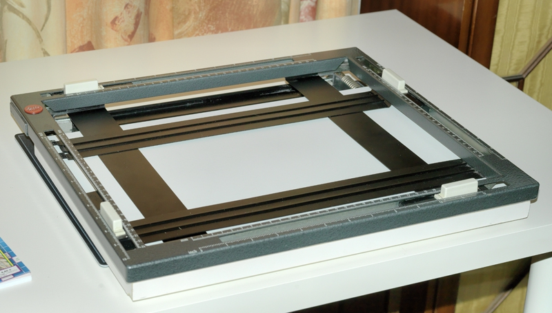

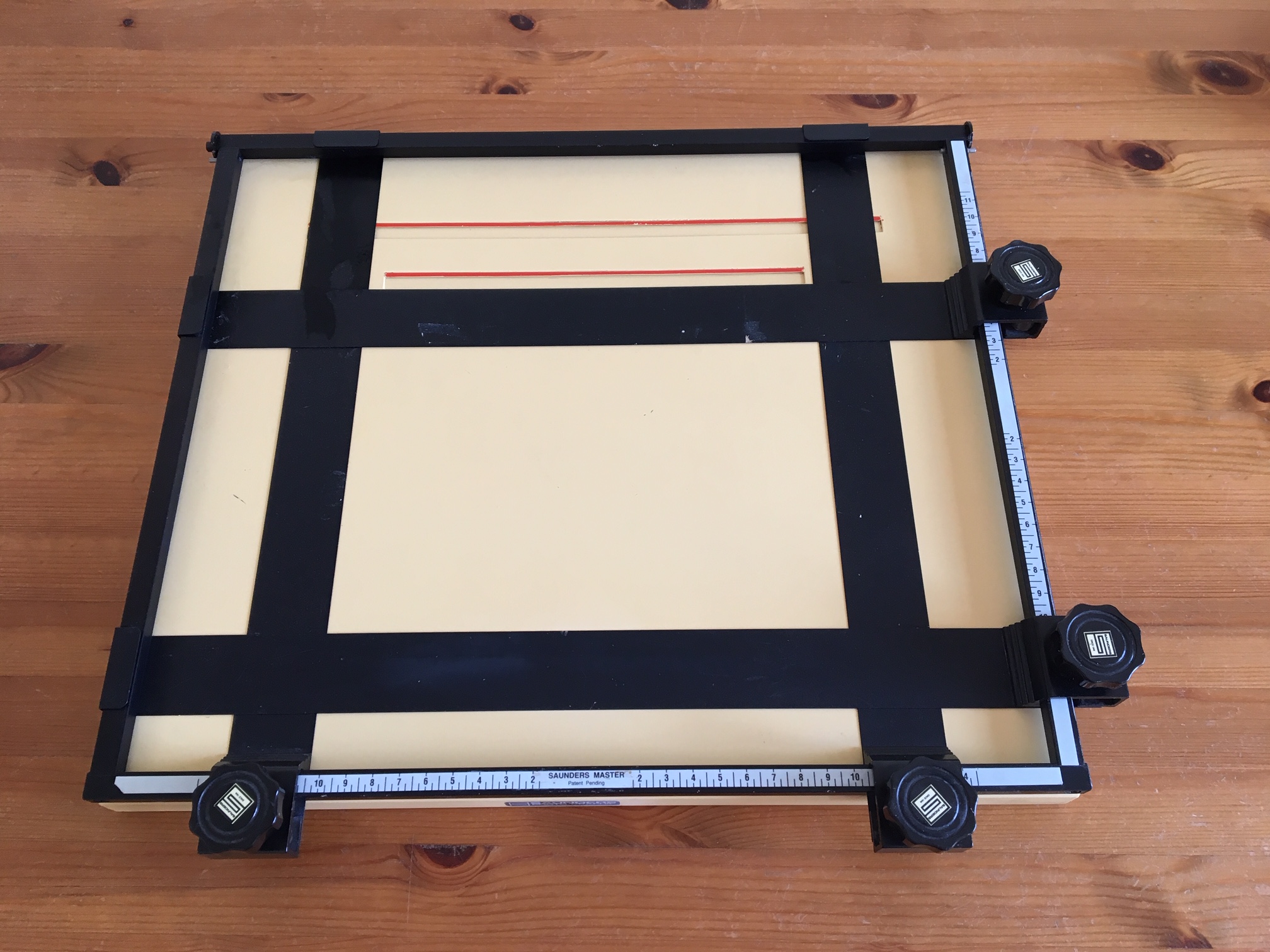

Hello there. I have the opportunity to buy either a Saunders 11x14 or a Leitz easel, both four-bladed, for the same price. Any reason to buy one over the other? Or will I be happy with any of them?
Here are some pictures of the easels:

I believe Leitz easels were at a fixed height for use with their autofocus enlargers, so if you have an autofocus Leitz enlarger that would be important. From the photo, the Leitz looks like a very well made easel.
Saunders easels have an excellent reputation--I have one of the V-track design (11x14) and am very happy with it--the design is similar to the Leitz you show. The Saunders design in your photo is a more expensive design than my V-track, but is a fine easel. I think that the Saunders will work as a fixed size 11x14 easel with 1/4 inch borders if the blades are removed--I don't think the Leitz will permit that
I don't think you would be unhappy with either.
Top my understanding all Leitz autofocus enlargers can be adjusted continuously on any easel height.

The Leitz looks like it might do better at staying square, though it's not a particular issue for Saunders easels. Either one would likely work well. If I were choosing between them, I'd likely go with whichever seemed the most robust. I have an 11x14 and a 16x20 Saunders, they work fine.

I don't know about that particular model of Leitz easel, but some of them have slots in the bottom for a clamp that the Leitz Focomat 1c has for example. Once you get the easel where you want it, it stays there. Of course if you don't have a Focomat or whatever, then that is irrelevant.
The Leitz easel is probably worth more money, but I'd rather use the Saunders.
Hope that helps you.

I have a Saunders for use with my Beseler 45 and a Leitz for use with my Focomat. Apparently my Leitz easel is an earliest version. From the pictures I would say that if you are not using a Focomat, go with the Saunders.

I've never used Leitz easels. I have several Saunders easels, top notch. The V series are outstanding. The one you have pictured was made up to 20x24. That's a nice easel. I've never seen anything Leitz make that wasn't superb.
Saunders easels were made in Rochester NY for decades, in US darkrooms Saunders was the top of the line.

I have a Saunders V-track easel that I'm happy with. The geared model you show should be good also. Not familiar with the Leica, but would expect it to be high quality also.
