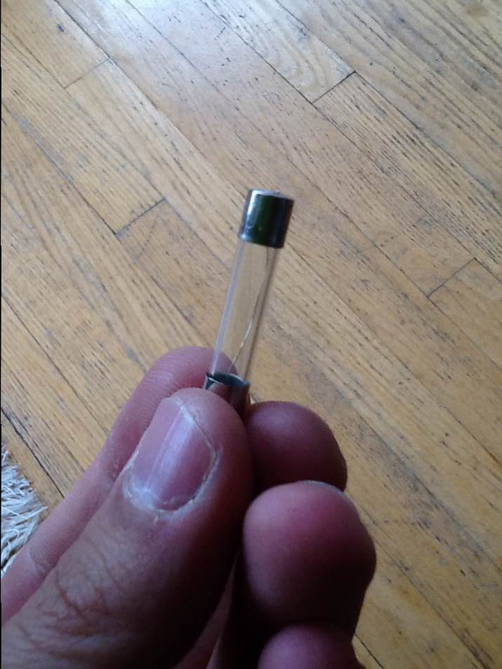

Won't turn on anymore. Was working before but I guess I need to change the fuse? I don't know much about electronics so let me know what you think. If it is the fuse anybody know where I can get one? thanks.
can you see if that fuse is blown? The metal strip in it would be burned/broken if it were.
Before you panic, run the wiring, make sure everything is tight, etc.. Fuses like that are available at any good hardware store.
I have changed the fuse and it still doesn't work. It turned on yesterday briefly before crapping out. Could it be anything else beside the fuse?
ok weird stuff happening. When I plug the enlarger into the Safelight socket of the timer it works, but when I plug it into the Enlarger socket it doesn't. I've tried in Focus and Timer mode and yes pressed the Red button. Any ideas?

When you say it works when you plug the enlarger into the safelight socket, are you saying that the timer turns the safelight off when printing and then back on when the time expires?
