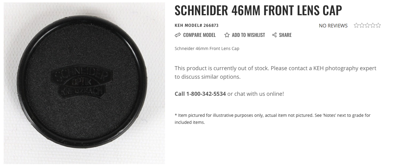

I have not come across a Schneider lens cap other than a plain push-on type.
But of course you can use a screw-in cap. These seem rare, but you could use a filter instead.
Or a snap-in cap.

I never use lens caps with my enlarging lenses. When the lens is mounted in the enlarger, it's not prone to collecting dust since it's facing downward, and enlarging lenses get less handling in general than camera lenses. I keep my lenses in re-usable food containers from the grocery store when they aren't mounted. Since the 6000 doesn't have a removable board (apparently), you could store the lens in the bubble case if it came with one. If you didn't get a bubble case, Rubbermaid, Glad or similar food container jars work well, and come in lots of different sizes.
As for lens caps, as AgX says, I've never seen any Schneider cap that wasn't a simple, plastic push-on cap usually embossed with their logo. New ones are available, or often camera shops have drawers full of random used ones.

Only 1 of my Schneider's came in a "bubble" container, that the lens screws into - hence no rear lens cap. As @bdial said, the front ones have Schneider on them, but any 43mm lens cap should fit or, as previously suggested, store in a Glad bag or another suitable container (the Sista system is a good one - they come in a variety of sizes.)
The 105mm Schneider I have is a much smaller, older version that I picked up online - no "bubble" just its original box and front "push on" cap.
And the 150mm has no box or push on cap at all, but I found an old Canon cap that fits perfectly and I use a Schwarzkopf Styling Gel container that I cleaned up to store it; works perfectly!
