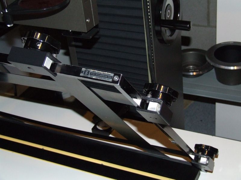

Sharing my fix with the group...
I have an easel with two blades that move properly and maintain square. The other two blades are very sloppy and do not hold square.
I removed the blade and adjusting mechanism completely from the easel.
I removed the adjusting knob mechanism from the blade and then pulled out the spring found under the adjusting knob.
I traced an outline of the shape of the spring after I pulled it out versus the shape after I adjusted and reinstalled (scale is in mm).
Blade sloppiness has been eliminated.
"Saunders instruction sheet states to always lift the blade assembly before adjusting the blade positions to help keep blades square."
All the best
Todd
So, it appears the spring gets compressed and allows the blade to flop around; right?
if so, good knowledge to share! I have a couple that are getting a bit loose and this is timely information.
Yes, that is what I found.
The easel is new to me but I do not know it's history, I can only speculate that the springs lost their shape due to the blades being adjusted without lifting the blade assembly.
I have Saunders easels 11x14, 16x20, 20x24. The only one with issues is the 11x14. When adjusting the arms, i now check if they're square with a steel ruler.
Indeed, lift the whole upper section before adjusting the blade travel. Then check them with a small reliable square or draftsman's triangle when down. If any blade is out of square or loose, there are screws adjacent to the knobs which allow it to easily be re-squared. I have several of these easels, but none in which the springs per se seem worn out. Rough shipping or abuse can lead to the need to correct the squaring, even on units bought new. I alway check such things regardless.
Most darkroom workers just beat on those easels, like they're an old screen door on the back porch. They will last a lifetime if they're used properly... glad you found a fix for yours!
Good job fixing that! New easels can be very expensive these days.
The larger Saunders easels have coil springs instead of the spring steel bands. The principle is the same, if the springs are weak the blades will be wobbly.
