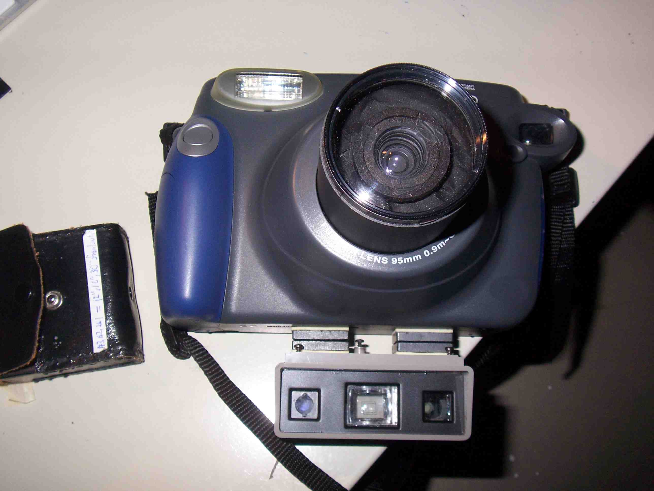

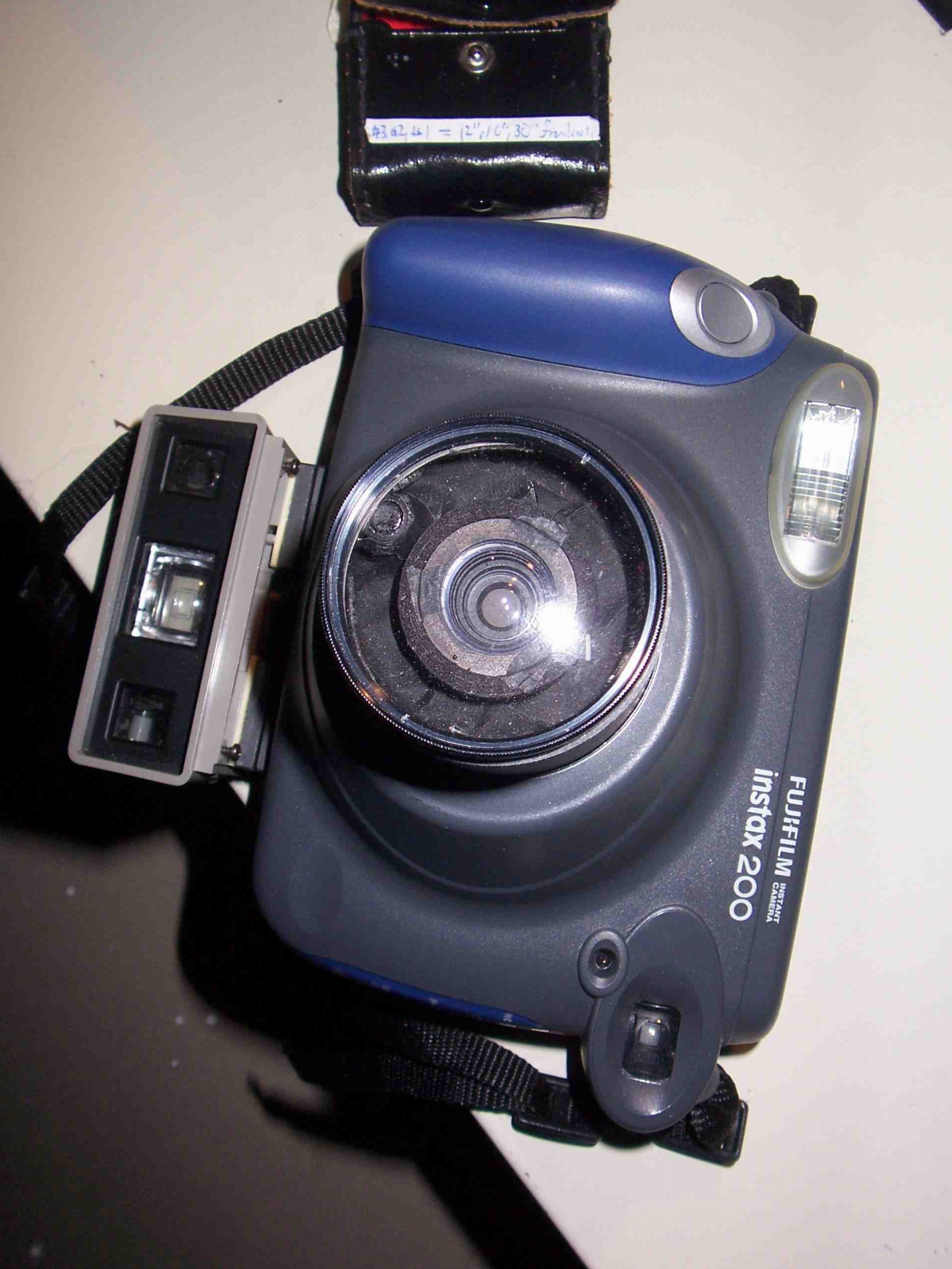

instax is superior image quality to polaroid--I have hadan instax since it came out...I hacked on an aux viewfinder/rangefinder from another polaroid and I was able to put on close-up filters...you'll notice that if hyou take apart the lens assembly front, that it's just the right size for 52mm filters to go right in there....so you can use that close-up lens set or polarizer, etc....it's just the exposure then you have to fiddle with--I do this by selectively taping off parts of thesensor in the front---when you take off the front assembly, the neutral density that goes over the light sensor comes off, so you then have to obscure parts of it to get proper exposure--it's a hassle at first, but onece you get it, it works great...all parallax corrected and eveything...the rangefinder set for all +1, +2 +3 close up lenses
here's a pic with aux polarooidd viewfinder/rangefinder and filter installed...notice tape over tiny light sensor and extra light protection around lens periphery---take it apart and you will create new light leaks due to the outer housing now being gone.....
