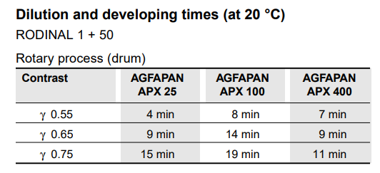

AFGA's time for FP4+ (64) in Rodinal 1+100 is 15 minutes for a contrast index of 0.45. Agitation is continuous the first 30 seconds, and then 5 seconds every 30 seconds. 20 minutes is for FP4+ at 125 for a contrast of 0.50.

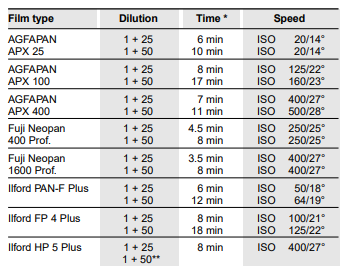

Based on the datasheet, normal contrast at 8 minutes is achieved using 1 + 25 dilution. If you get N at 8 minutes with 1 + 100 dilution, it suggests to a potential experimental error. The way to remove doubt is to retest.

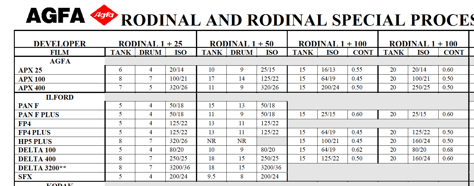

The chart Alex posted corresponds with a publication I have from Agfa Canada from the late 90's. It shows a blanket 15 or 20 min in Rodinal 1+100 for almost all Ilford films, 15 min rated 1 stop under box speed and 20 min at box speed.
It has a note that this is in small tanks, with agitation every 30s.
