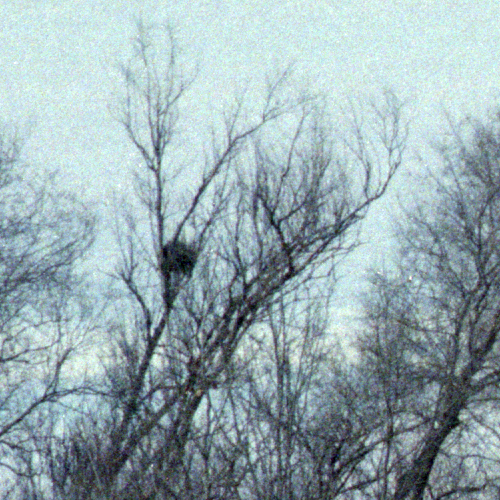

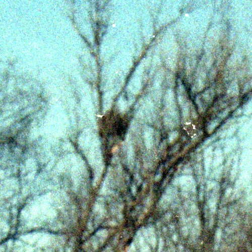

K1000 with 50mm f2.0 prime lens f16:
This one above was taken with the lens set hard to infinity. When comparing with the control image below it appears a wee bit softer to me, but when viewed as a whole image on the screen, there's really no difference. The image appears normal when viewed normally.

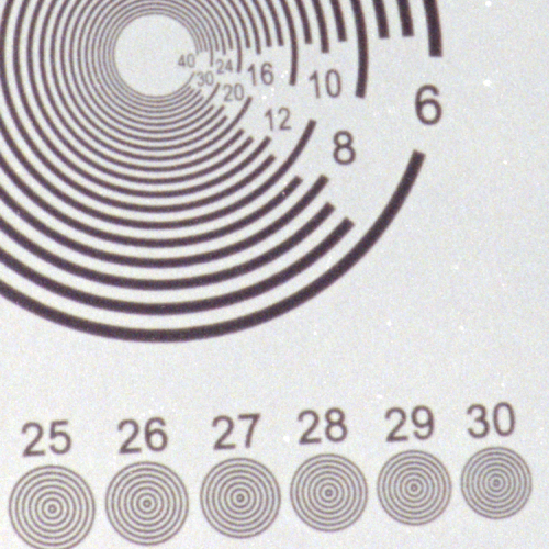

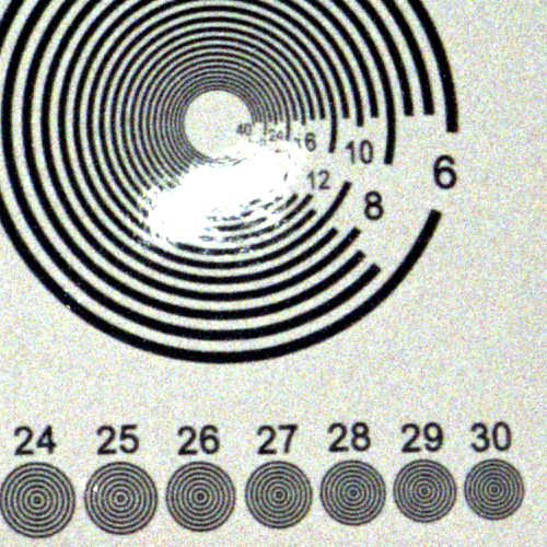

Test target 50mm f2.0 prime lens f16:
This is the test target at maybe 6' or so, f16, daylight, manually focused (I did wear my glasses!) :smile:. It looks very normal to me.
K1000 with Takumar-A 28-80mm zoom:
28mm f16:
The shot above was at 28mm with the focus set hard to infinity. Comparing it to the control photo and the prime lens photo above, it appears to be to be somewhat softer. When viewed at a normal size on the monitor it still looks quite normal.

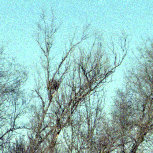

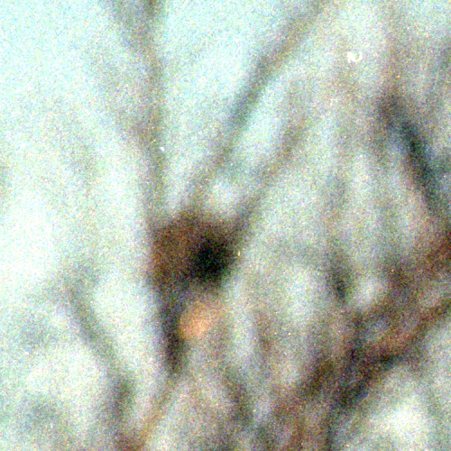

80mm f16:
This shot above was zoomed out to the max with the focus set hard to infinity, f16. To me, this looks unacceptably soft. When viewed on the monitor it's normal or near-normal, but a 8.5x11 print does appear soft to me.

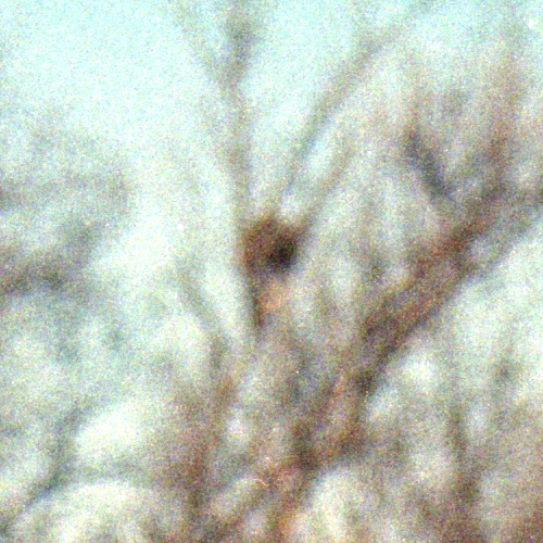

80mm f5.6:
This is overexposed. I wanted to see what it would do in the middle of the f stop range so it was f5.6 at 1/1000. The softness is REALLY showing here! :sad:

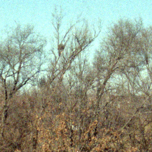

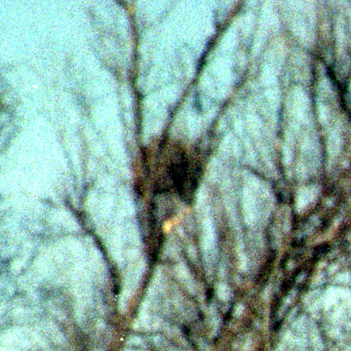

K1000 Ozunon 28-135 zoom:
I'm not posting the 28 or 50mm Ozunon shots since they look near normal but when I zoom it way out to 135, the softness is unacceptable at f16 and UGLY at f5.6!
135mm f16:
135mm f5.6:

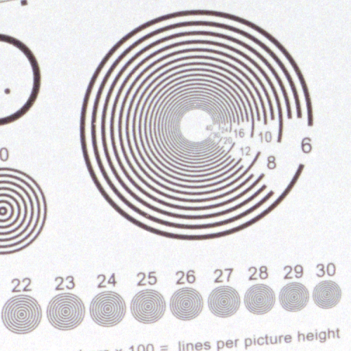

Test target:
The shot immediately above is with the Ozunon zoomed out to 135 at about 10' from the target. It looks normal to me. It was carefully focused while wearing glasses.

"Control" photos:
Not the same roll, obviously, not the same light, and not the same day. These were taken with the Mamiya SD rangefinder, match-needle exposure on the outside shot, exact exposure not remembered but something like 1/500 between f11 and f8 or so. The test target was done indoor with fllash some time before.
