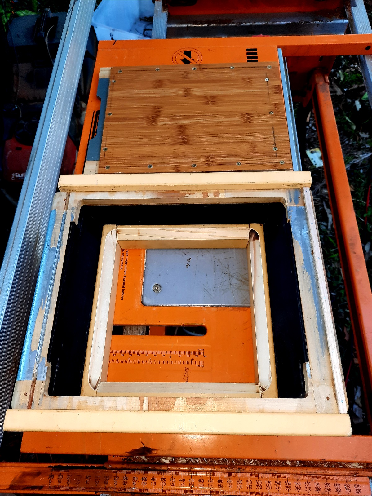

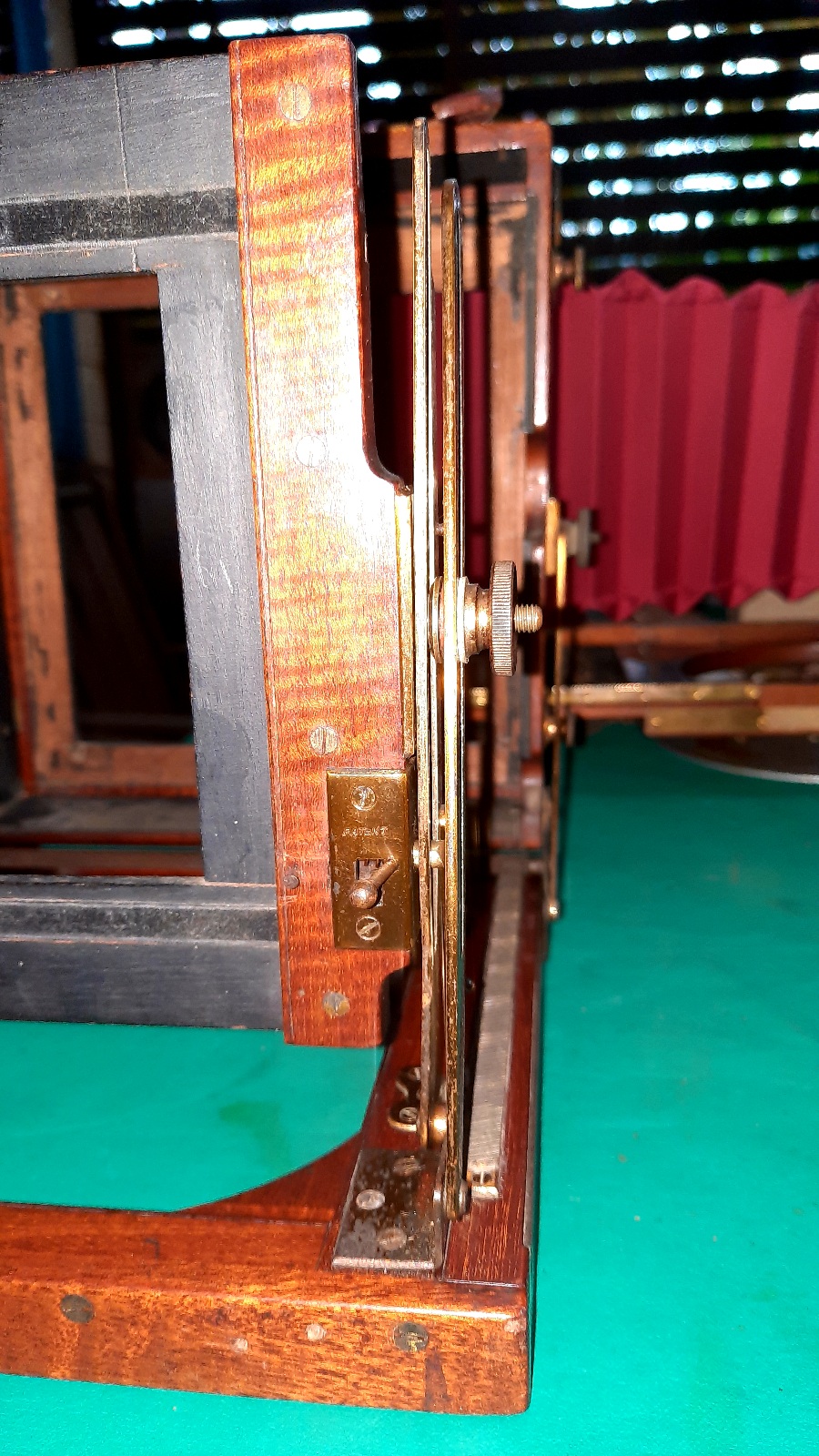

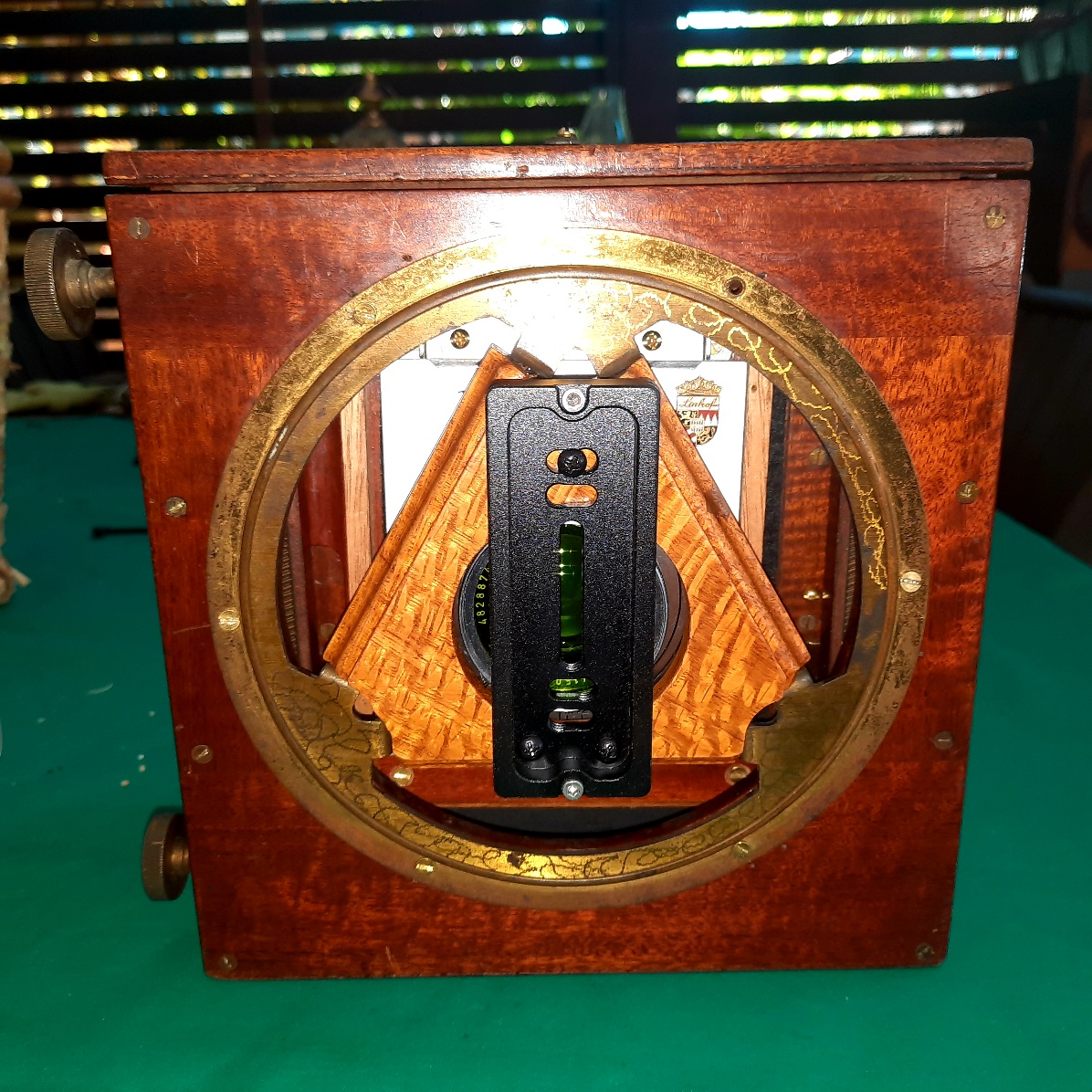

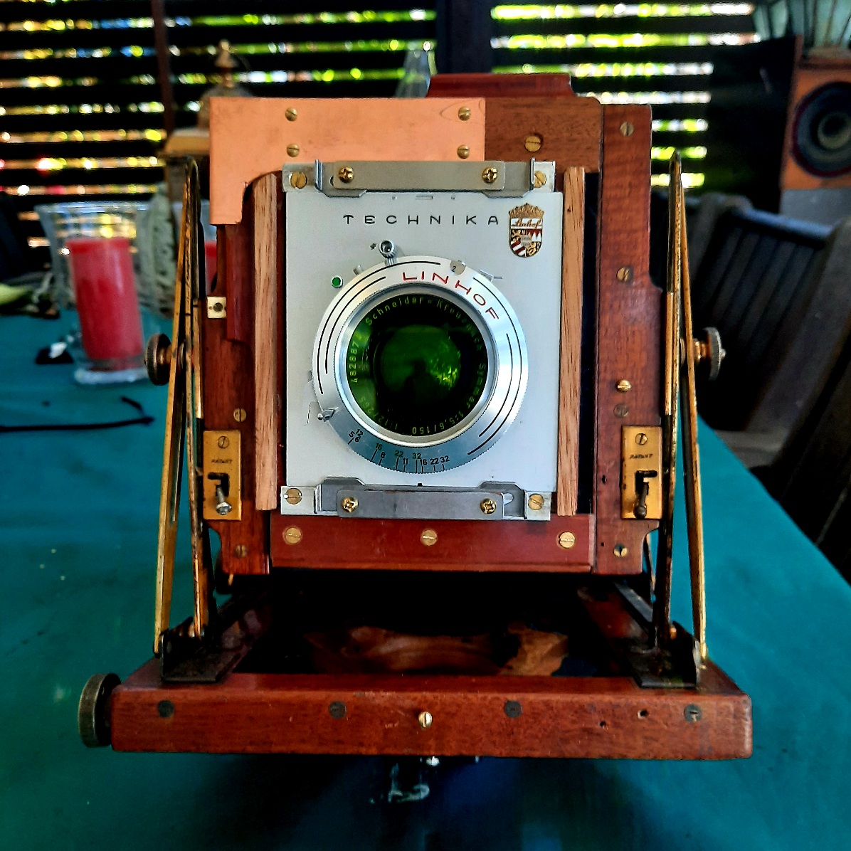

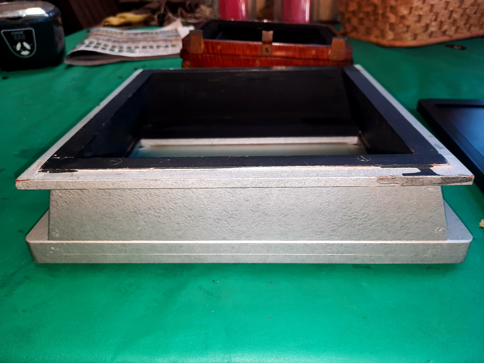

Not only that Ron, its very light. Think I can keep it to the 1.5kg mark, excluding lens, when finished.

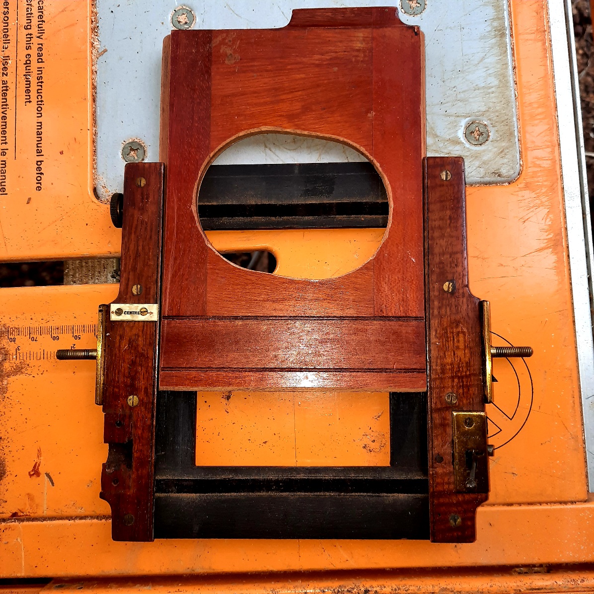

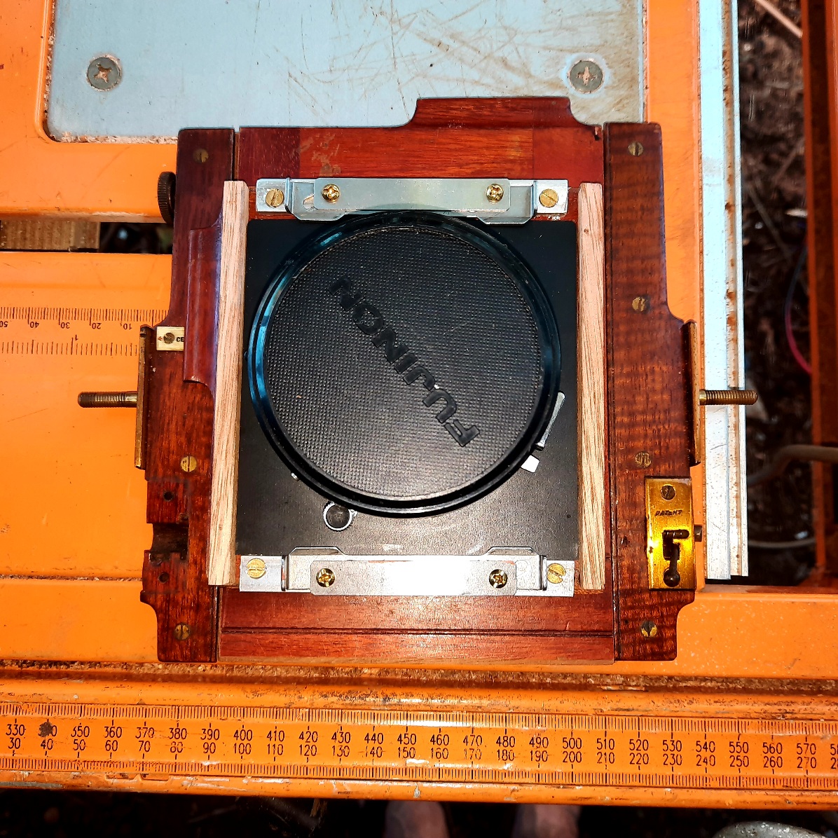

Made a rise and fall board from an old half plate dark board, just needed a slight trim and some backing ply to thicken up.
Made the lens board holder from another dark slide and some parts I robbed from an old copy stand.
Just need to make the lens board slide for a little left and right shift, then make it light tight and tidy up.

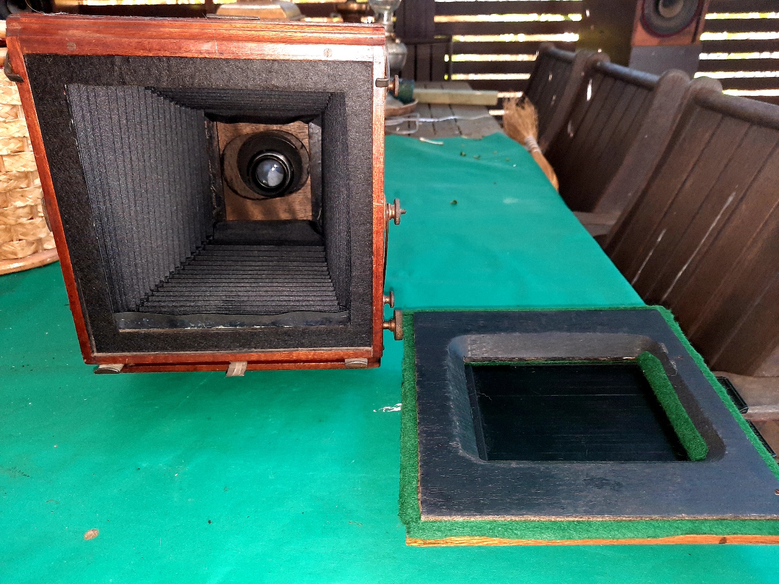

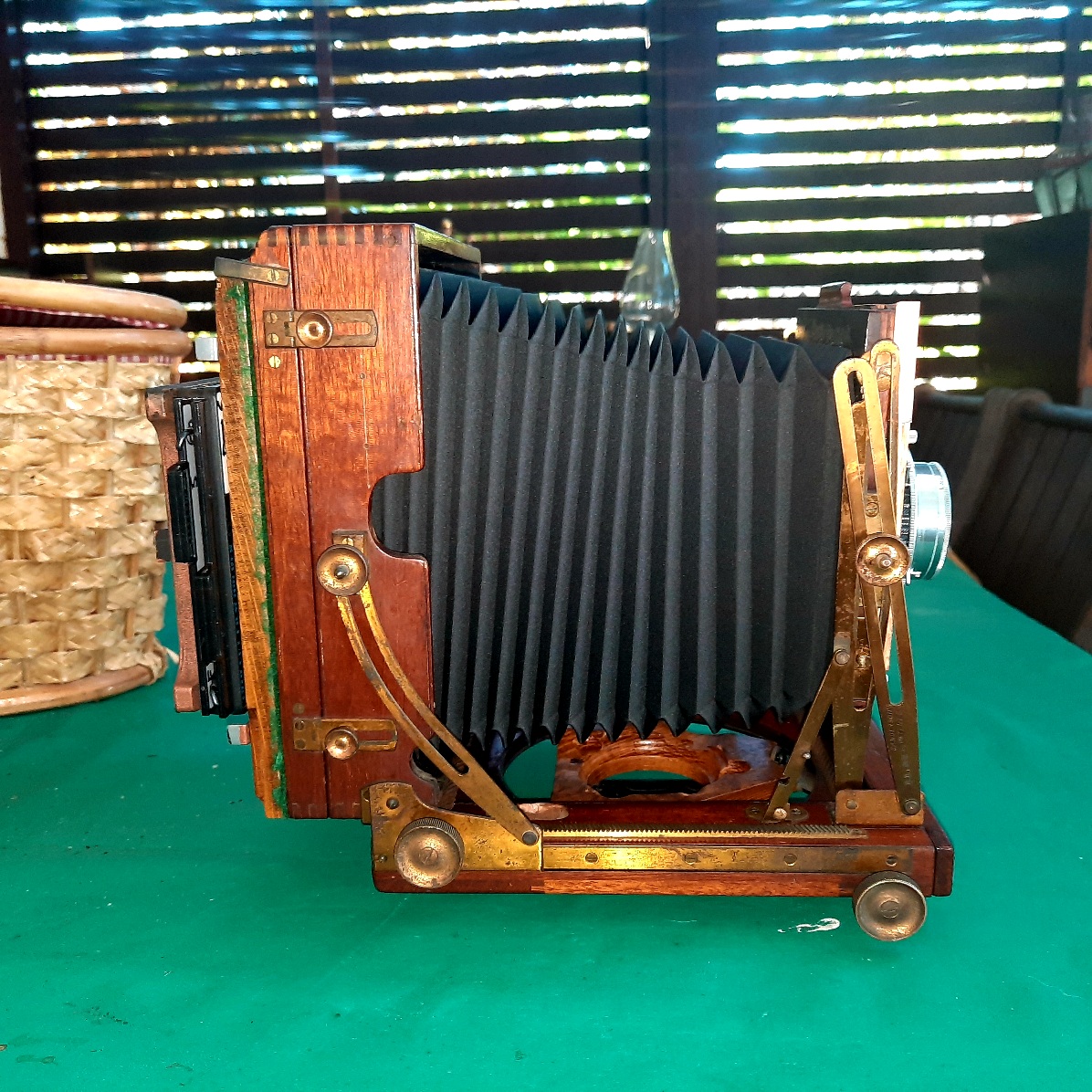

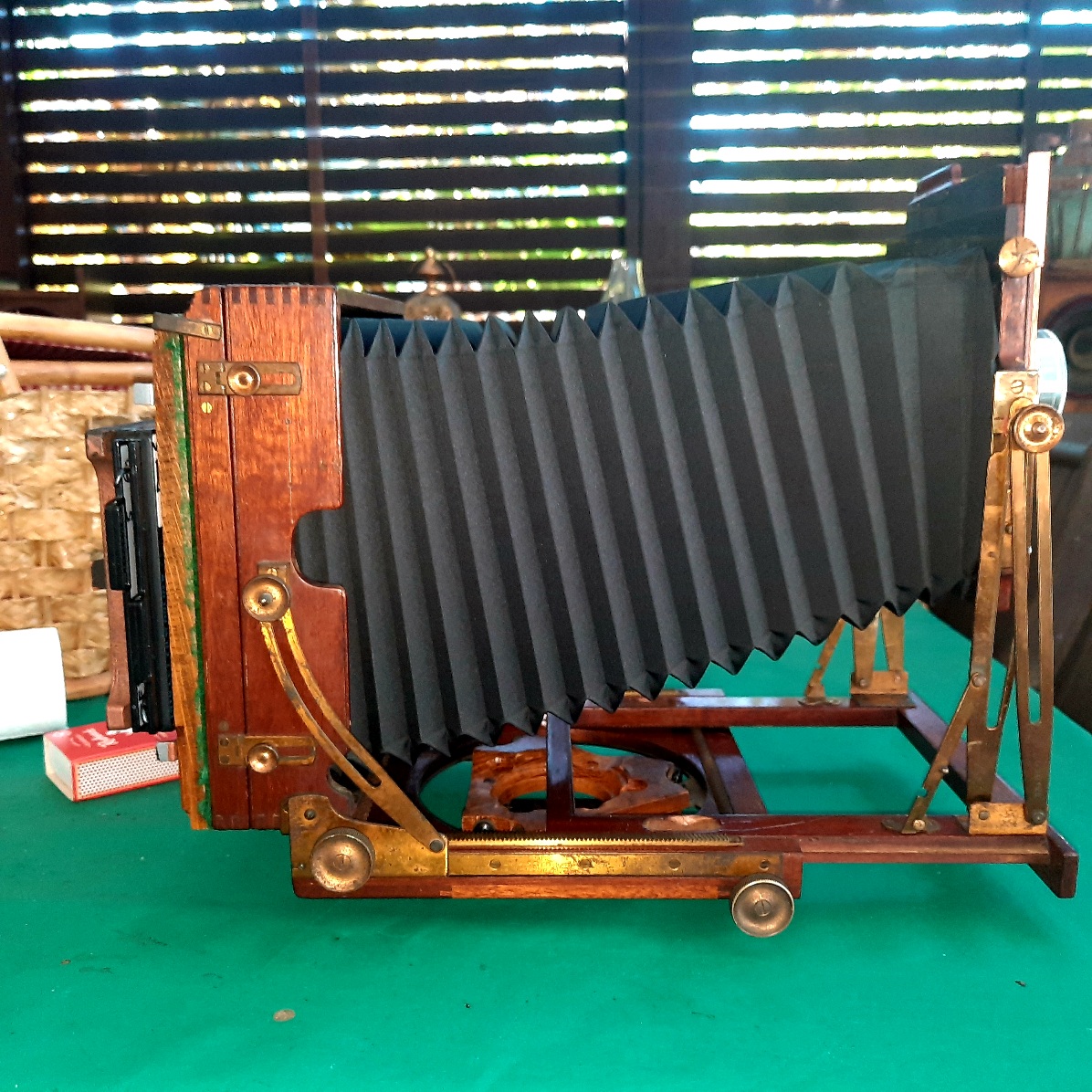

very nice bellows; where from or self made?
I had them made for me, took a bit of communication till they understood what I wanted, but in the end they got it right and were delivered in less than a week. I did a better job installing than I did with my Victo bellows, its a bit easier once you know how. Just need to tidy it up once I finished testing and know everything is working.
Weight worked out at around 2kg without lens, not bad. Wil make a nice cheap field camera.

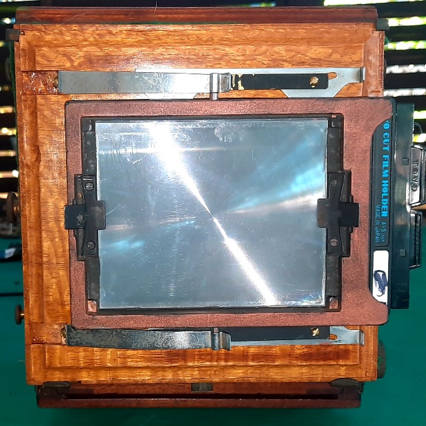

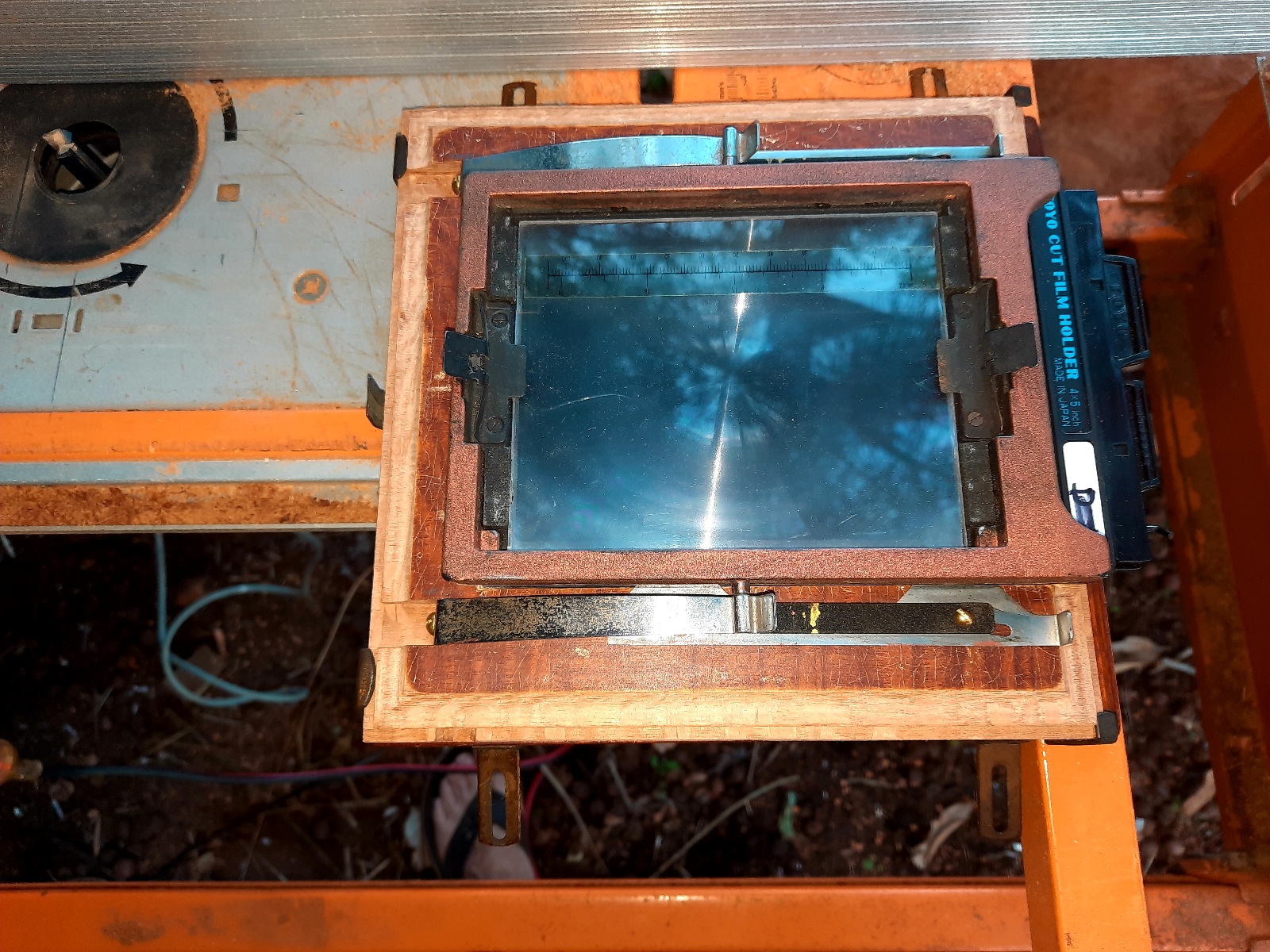

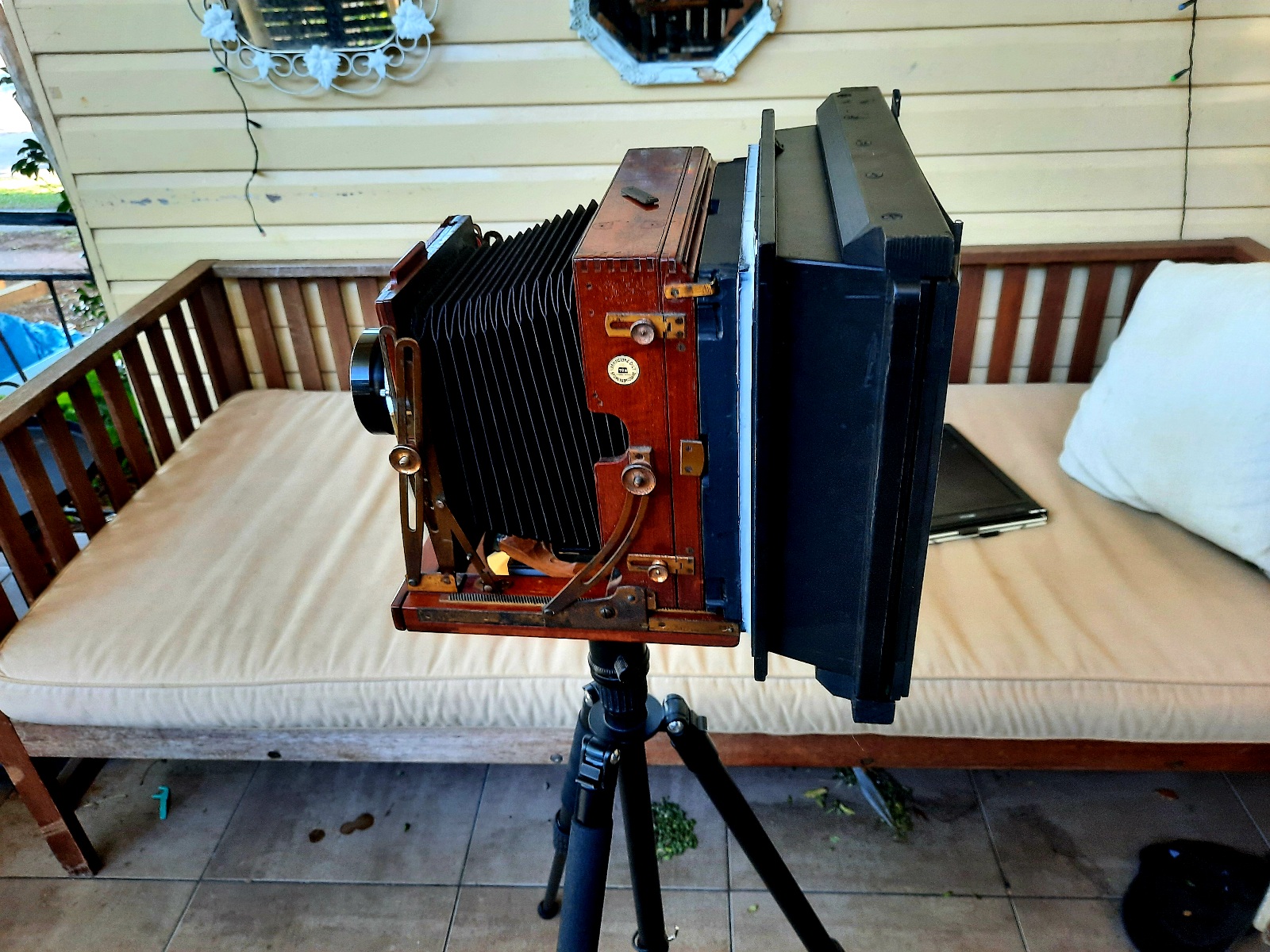

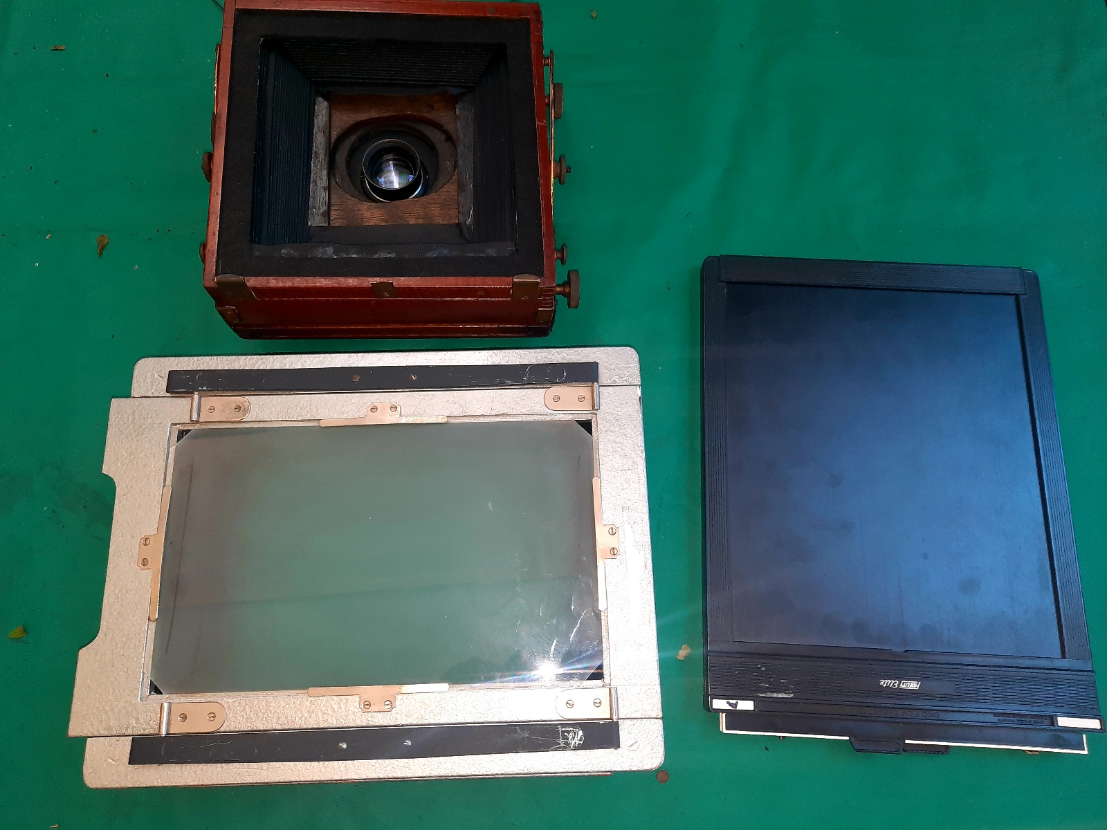

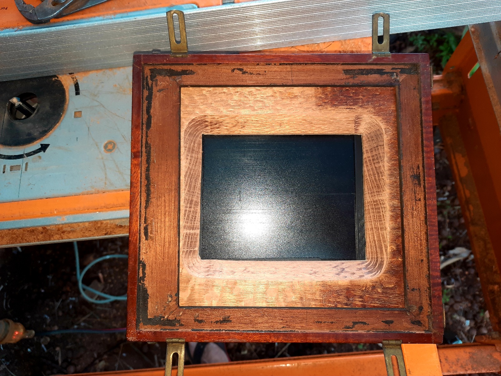

Made the adapter, cut to allow 8x10 film holder, made the pressure plate. Just need to cut a 8x10 window for the ground glass, make a 8x10 ground glass and paint....fix light leaks.
awty
Jul 24, 2016
3,659
Australia

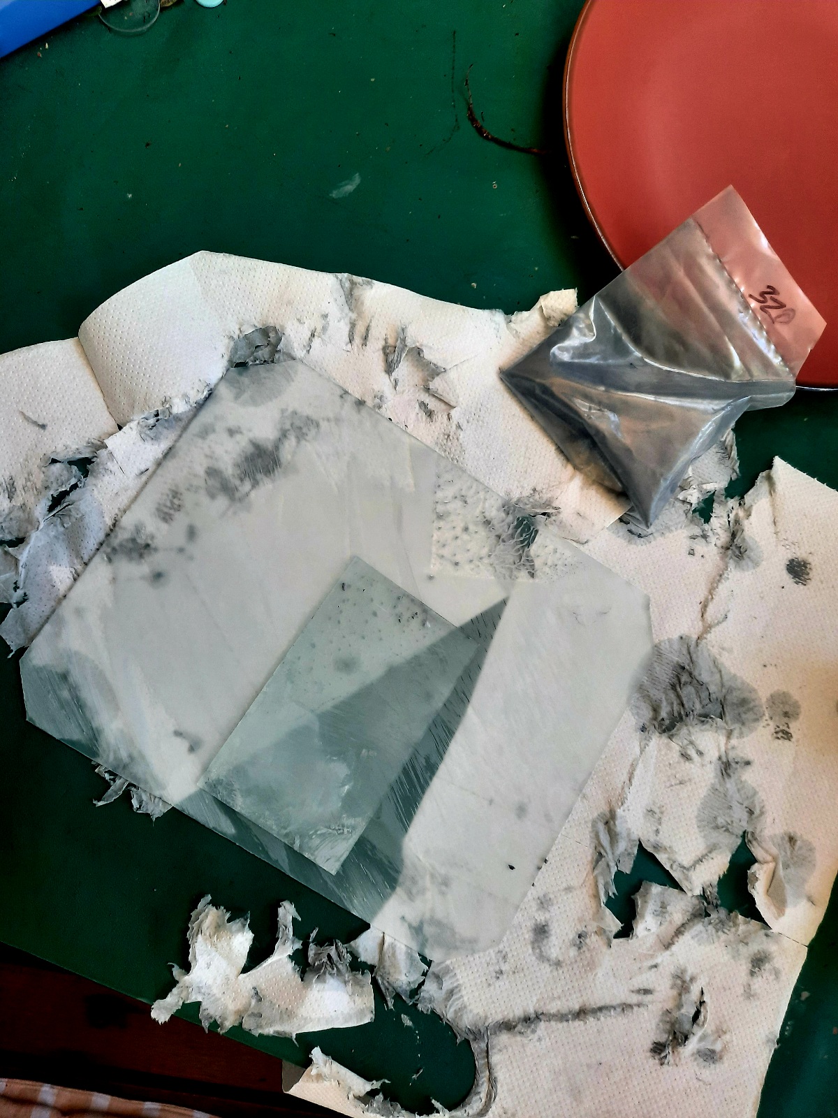

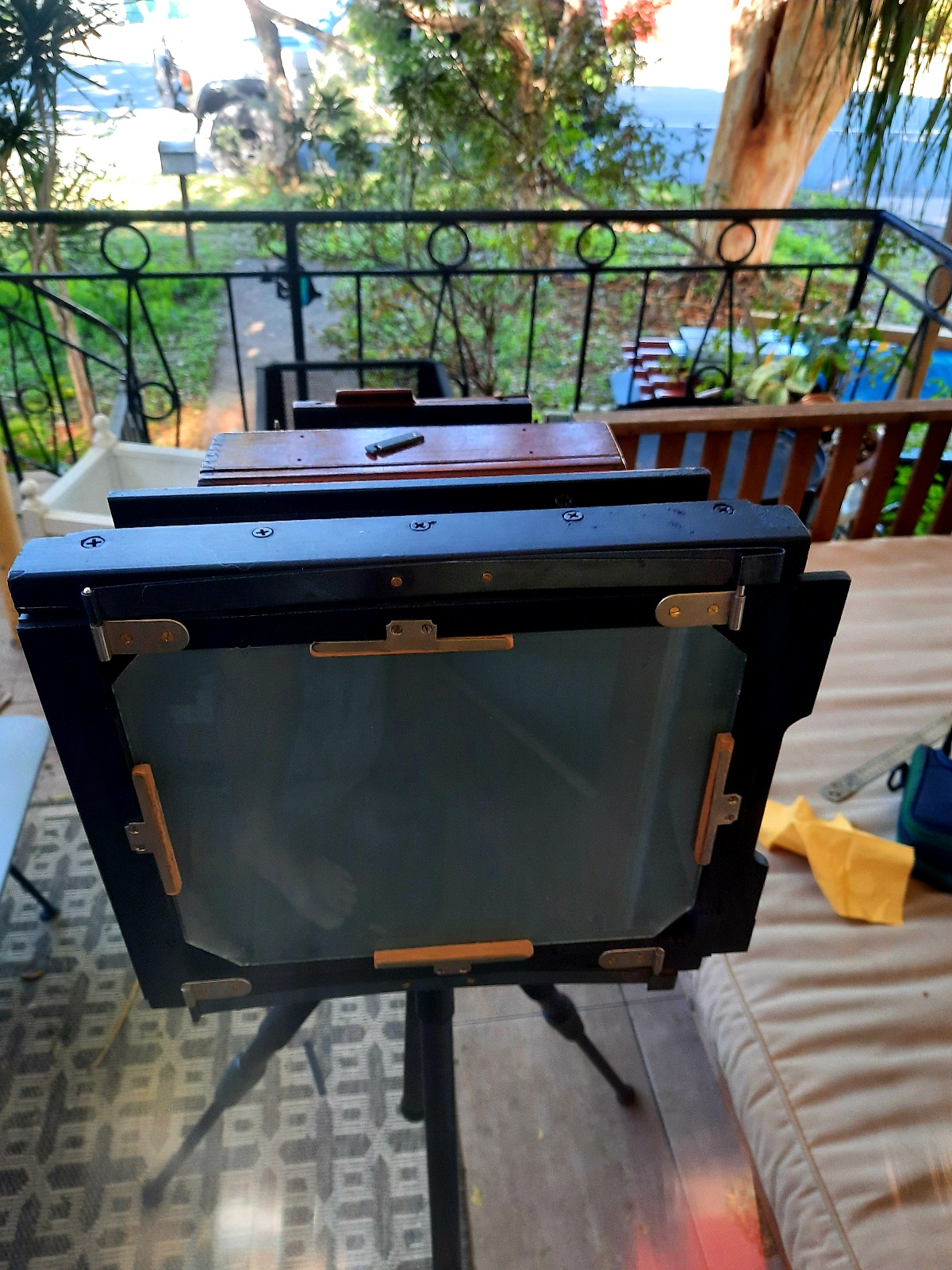

Made a 8x10 ground glass.
All finished, the focal length of ground glass to infinity seems correct, cant find any light leaks. Can see lens on all four corners.

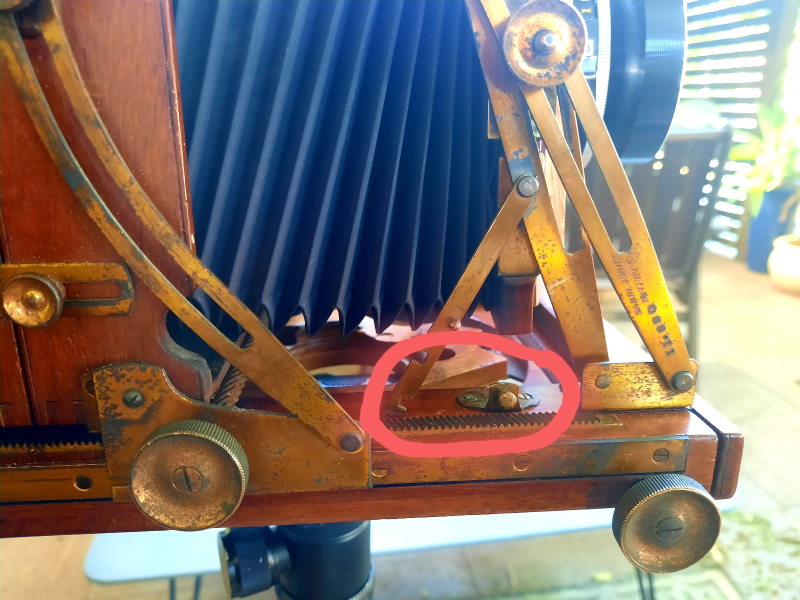

Just need to make a new fixing for the front standard to lock in @ 250mm infinity. Luckily the front standard can swing backwards to achieve.
