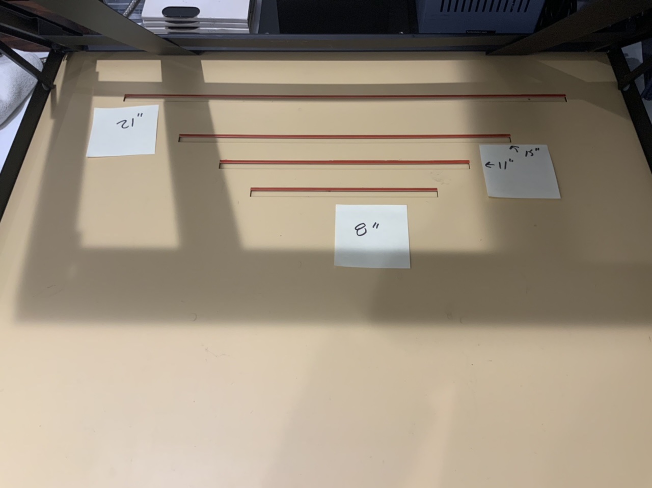

So is this easel meant for some weird paper size or maybe for using as portrait orientation?

20", 14", 10" and 7" paper edges - no mystery.
The slots are longer than the paper edges they are intended for, plus they permit use in portrait orientation for some paper sizes.

sruddy
Aug 31, 2018
341
CA
All right then, I guess it threw me off because my smaller Sanders easel has slots that match paper sizes with just a skosh more room, no more extra like this one.

Paper in rolls is almost exclusively what the photofinishing and photolab industry uses, so probably accounts for 98% of color paper. I don't know about black and white. But those kinds of systems have automated cutters and exposure systems, so don't use traditional easels much anymore. I have some Saunders easels with slots 8", 11" 18", 21", and 26" - all an inch over the paper sizes of 7", 10", 17" (rare nowadays), 20", and 24". For bigger paper still, I've my own vac easels.
