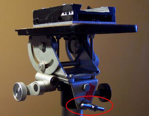

Murry here is the 3 way geared head on my Samson. You can find one if you know what to look for. This head was also made in two way versions so make sure you find one that has the 3 way tilt as circled in red. This will give you some side to side tilt.
I have added a large and stout Quickset quick release to the head. I took this off another fluid head that was otherwise useless. The actual head platform is 6.5 x 8.5 inches so its very nice for big cameras.
Quickset is still in buisness but their prices are very high. In fact I doubt you could get a new Samson for less than a Ries. I inquired about a new quick release plate and the cost was in the hundreds! However on the used marked they are very inexpensive.
