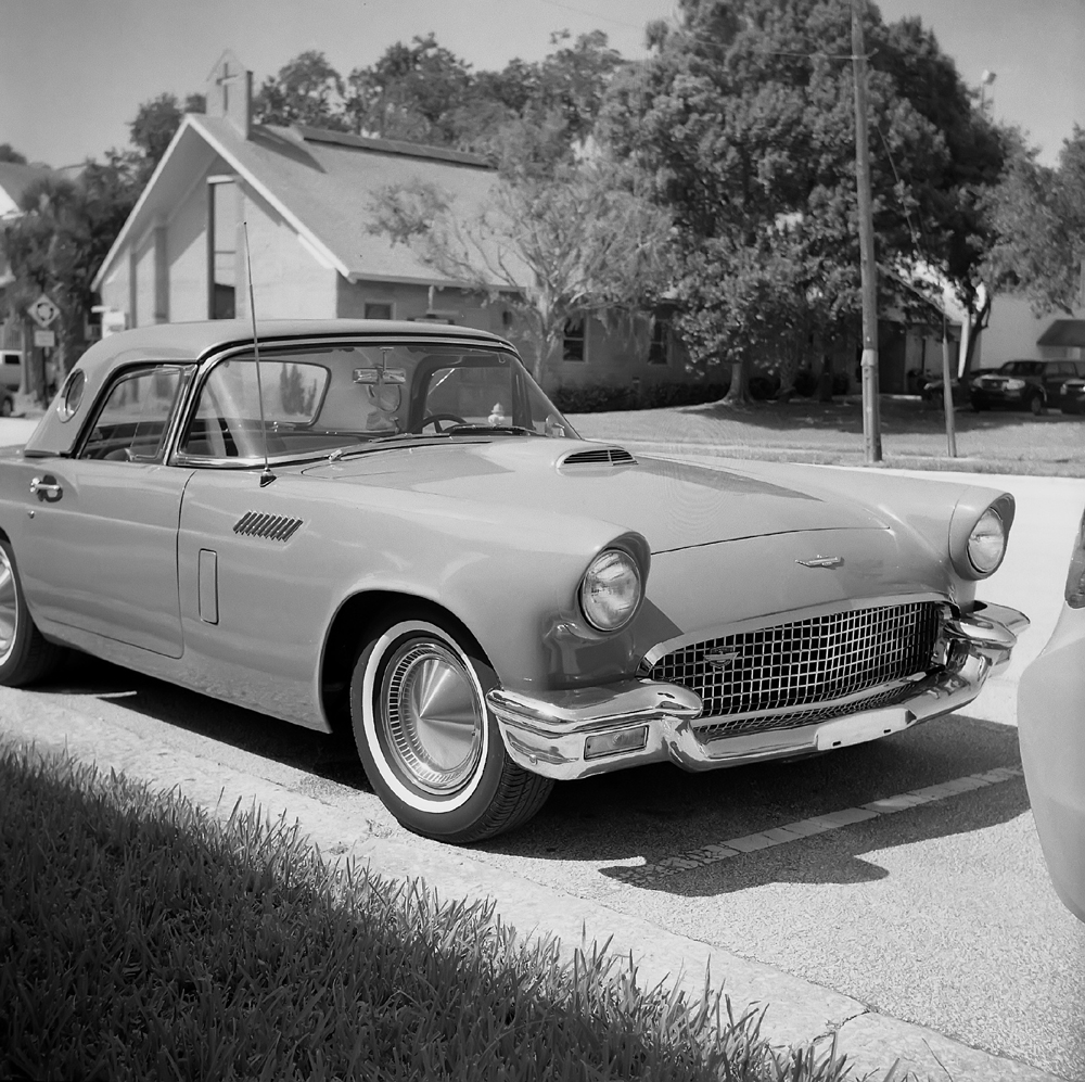

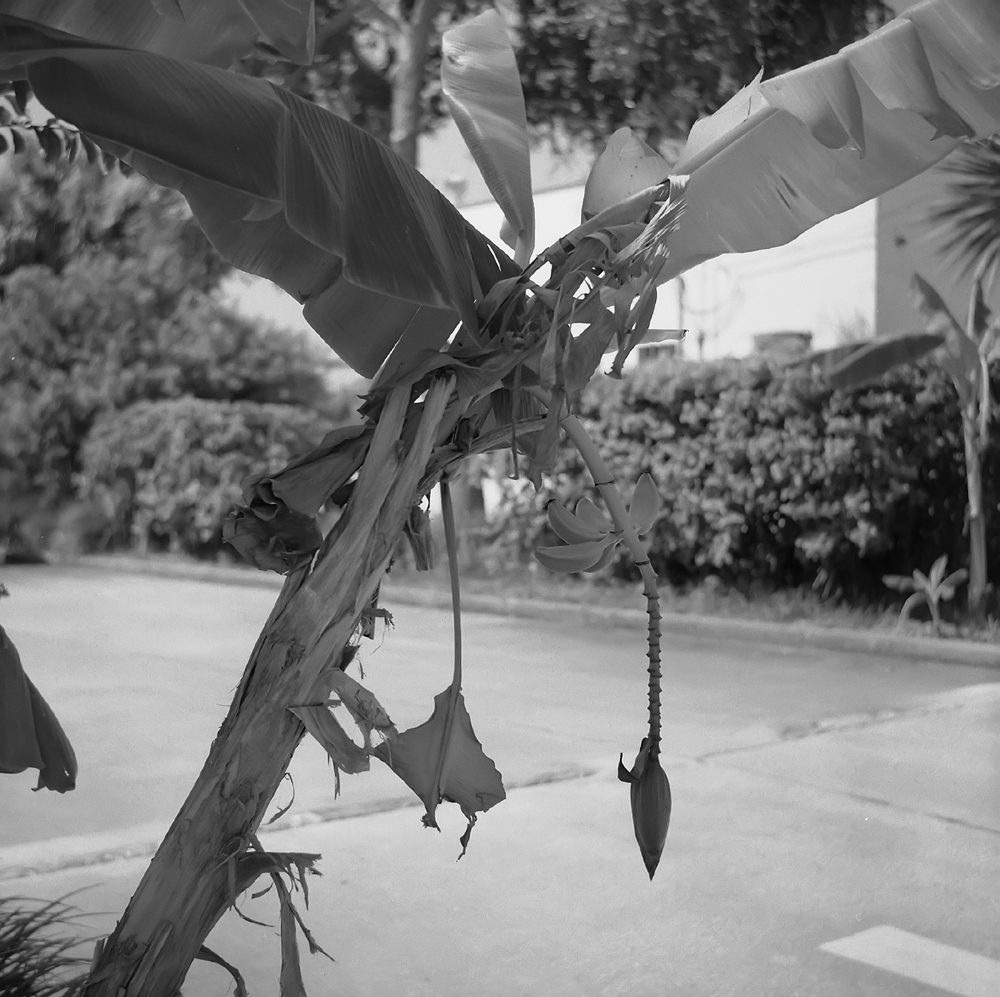

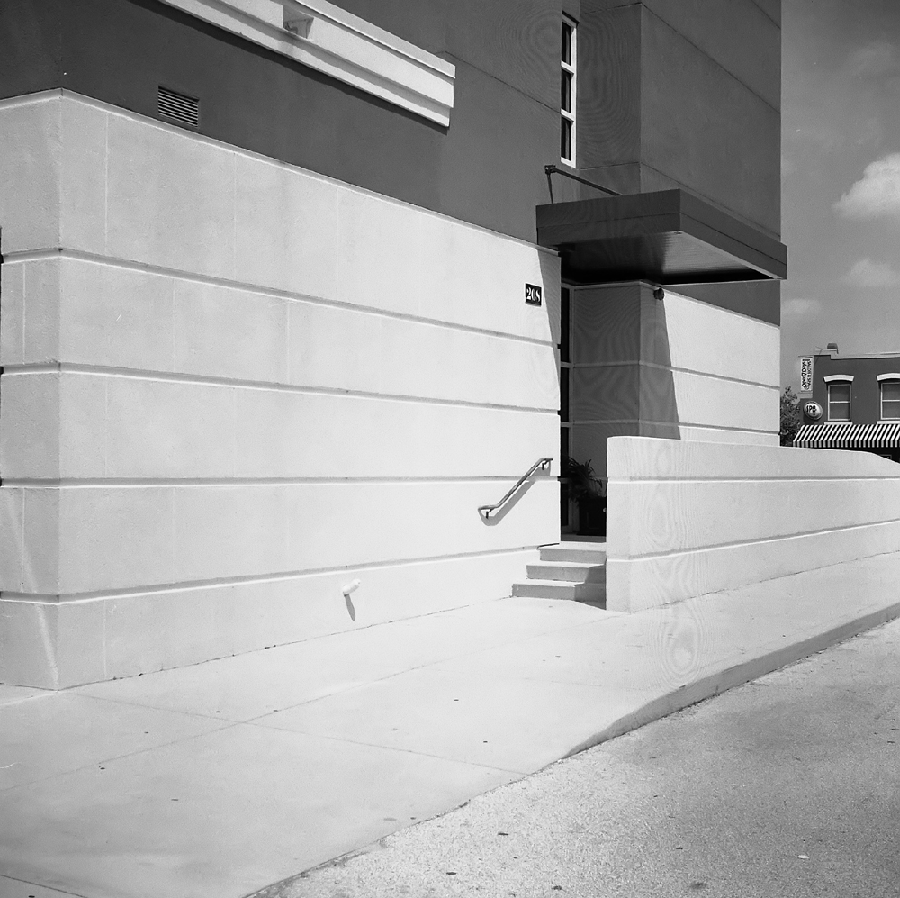

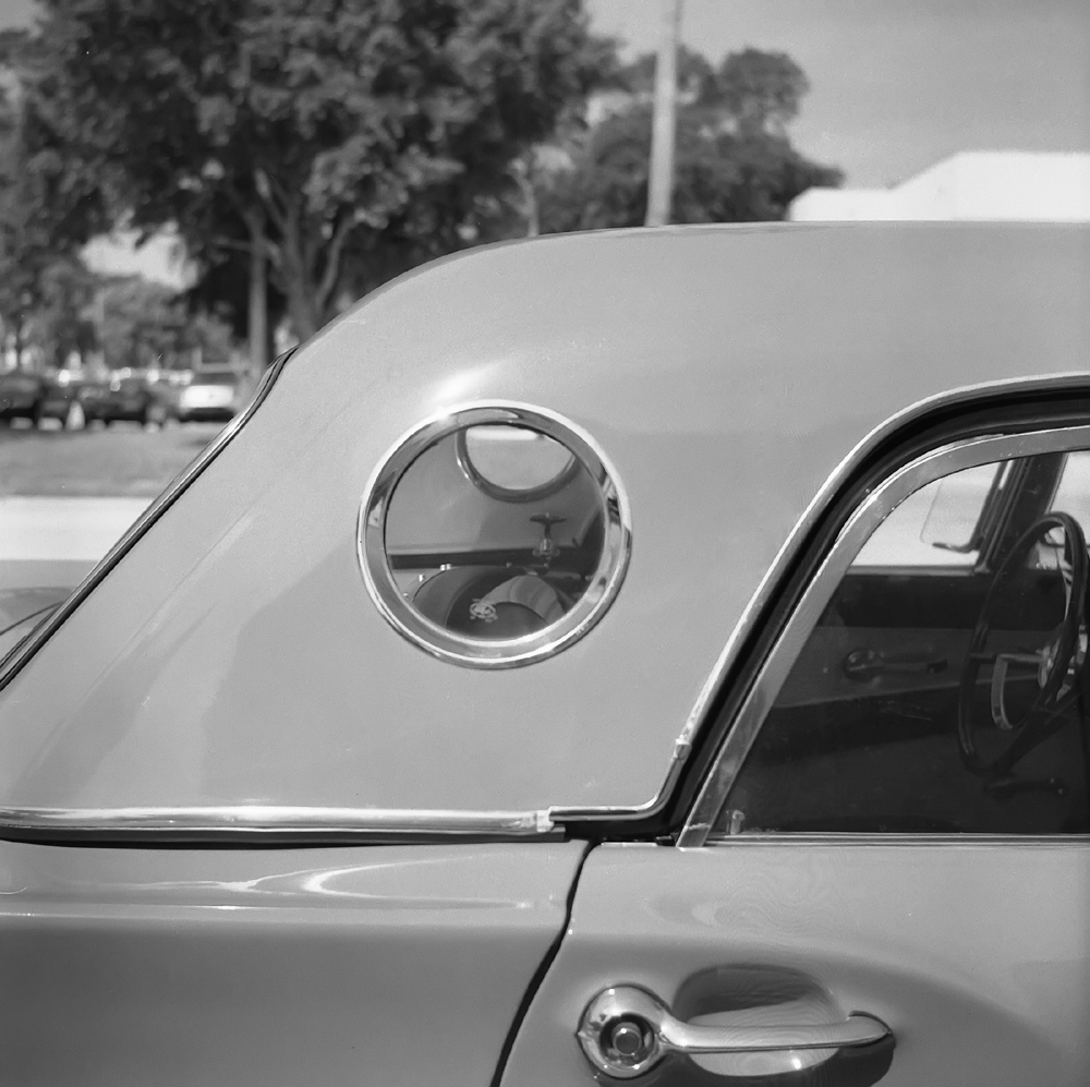

Here's what the contact prints look like from the first roll that came out of my Argoflex TLR. The camera looks like this:
Film was Tri-X shot at 125 ISO w/ a yellow filter, and it was developed in Rodinal at 1:25 dilution for 7 minutes at 68 degrees. The contact prints were made in Dektol and I have no idea how long it took because I had to do it several times. First time I ever made contact prints actually, so that was interesting. In the past, I just made trial prints w/o making contacts.
The lens is an Argus Varex 75 4.5 triplet that is not that bad! It has unusual f stops of 4.5, 6.3, 9, 12.7 and 18, which made metering a little challenging. All in all, a nice $20 Bakelite camera that gives those big, beautiful 6x6 negs. The only downside is the shutter. It's self cocking, and difficult to fire w/o shaking the camera, but practice may help. Also, I may be getting a little shutter bounce at the highest speed of 1/200. Shots taken at that speed were blurry, but the shots you see here were made at 1/100 and they look fine. The camera takes 620 film, but 120 loaded right in, and I let it spool onto the 620 spool that came with it.

Those are nice shots. I'm shocked the Argoflex produces such sharp images. I have one and never used it because I figured it had a dog of a lens--guess I was wrong.
summicron1
Jul 28, 2010
2,920
Ogden, Utah
working in a museum with negatives from the 40s and 50s shot with consumer cameras, I've come to have a great deal of respect for those old boxes. Within their limits, they did a very fine job.

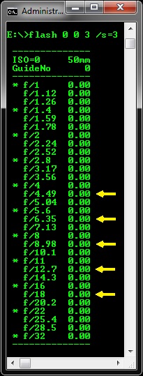

What an odd setup. Those are each 1/3-stop higher (more closed down) than the standard full-stop progression. Here's a small annotated chart from an old-school utility I use to generate subject-to-distance tables for various flashbulbs. I've left out the flash-specific info, just displaying the fractional f/stops (to 3 significant digits):
Does anyone know why it would be done this way?
:confused:
Ken
The so called "standard full-stop progression" is a relatively recent phenomenon.
There is a certain amount of logic behind having your aperture settings start at maximum and then progress one stop at a time.
