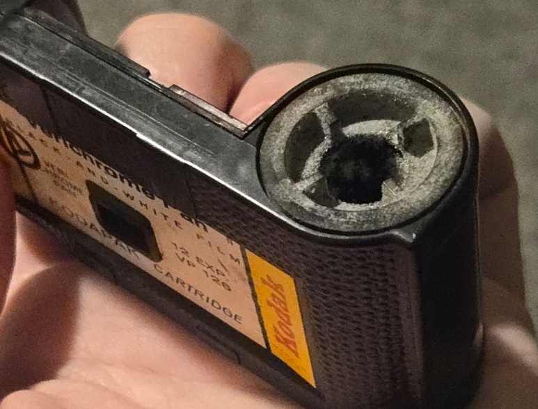

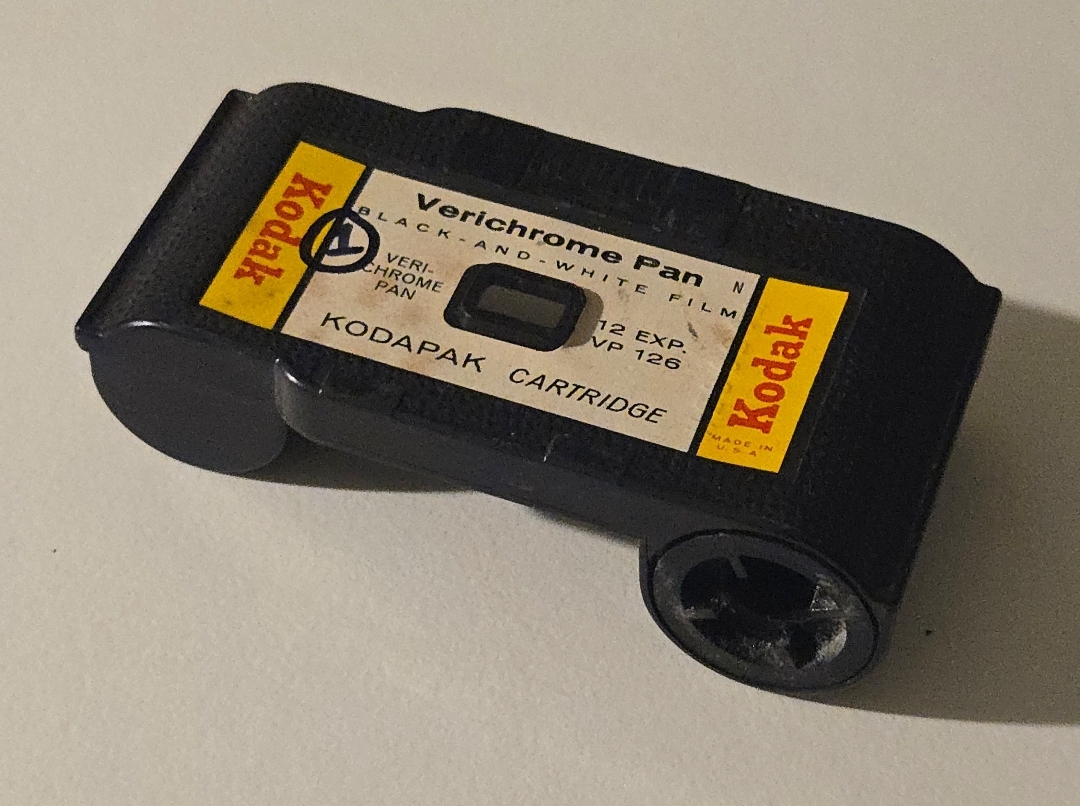

Hi all,
Long post ahead, and I hope some of you can offer some advice and problem solving.
I have inherited my father’s photographic legacy: negatives, slides, super8 home movies, and some undeveloped film. It was a hobby he picked up in the 50s and he passed on to me his curiosity for it. It would be extra meaningful to successfully develop the rolls he left behind.
I know getting anything off these rolls is a long shot, but it would be really meaningful to my family to turn up even a couple coherent frames.
[Please don’t say “just send them to a lab,” as I have explored those options and found it to be cost-prohibitive for such a large amount (19 rolls) of poorly stored film that might be unsalvageable anyway.]
Developing this film presents a plethora of challenges, and I have scoured these forums and other sites for relevant discussions on this film type, expired film in general, benzotriazole for fog, rodinal vs d-76, etc. But there are some unique challenges I haven’t found to be specifically addressed. Rather than pepper the forum with all the angles of it, I wanted to lay out the whole situation in one post.
I don’t mind experimenting and will document my process, but if anyone has insight on the following issues, I would be so grateful!
1. Film was exposed likely 50 years ago
To start, I’m looking at 6x 12 exposure 126 cartridges of Verichrome Pan likely shot in the early 70s, and never developed. I’ve attached a photo of one of the cartridges for fun.
A lot of what I have found about developing expired film is focused on how to develop film someone purchased unexposed. I turned up some “found film” advice but not quite enough for me to proceed.
How do I determine the developing time for the film? I have seen snip tests that dip the film slowly a few seconds at a time per section, I’m not sure how that would translate to a longer process like stand developing. Which brings me to my next point.
2. Stand develop in Rodinal
After doing some digging, I determined that stand developing with Rodinal is likely to be successful on this sketchy material as well as being the cheapest first stab.
I have no data on how this film was shot, and as far as I can tell it was just stashed in the basement of numerous houses over the decades.
D-76 and HC-110 were other options I considered, but Rodinal seemed safest. Any objection?
3. Fungus Amongus
Questionable storage and age has caused a pretty grody fungus problem on most of the rolls.
I found examples of film that was affected by extensive fungus, which had been undetected until the film was developed. In this case, it’s so extensive as to be visible on the outside of the cartridge. See the photo I included.
Unless this is some mysterious “cartridge onIy” fungus, I expect a lot of damage has been done to the film in all these rolls, and I will need to do some post work on anything I successfully develop. Again, these are potential long-lost family mementos, so any success counts as success.
How do I handle this kind of fungus going into the developing process? Is a pre-wash and a prayer sufficient? Add something to the wash? Alcohol pad swipe in the changing bag before loading?
4. To Benzo or not to Benzo?
I’ve seen that a few drops of benzotriazole is useful for eliminating base fog on negatives, but can also demolish shadow detail (which was possibly lost to fog anyway). Again, a lot of the info I found referred to shooting unexposed expired film, not developing film shot fresh and left to sit for half a century.
Is Benzo even necessary with stand development? Is the fog that’s there just the fog I live with?
Is it possible to test this ahead of time?
5. Backing paper stuck
Any tips for dealing with the backing paper being possibly stuck to the emulsion while I’m loading the film onto the spool? Does a pre-wash help loosen some of that gunk or am I just screwed?
6. Loading advice
Any other advice you can throw at me for how to handle physically handling the cartridge and loading this film onto a plastic reel is welcome!
Thank you all for reading this far and offering any help you can! I have a limited amount of film to experiment with, and I’d love to approach this puzzle armed with the best possible practice.

Thank you all for your feedback! I've been mulling it all over since I plan to do an initial test roll this weekend before I dive in during the upcoming holidays and I have some follow up questions.
I'm not sure how to reply to multiple people at once on this forum, so you'll have to bear with me.
Donald, thanks for the tip that the mold probably indicates the film got wet. Do you agree with Paul's assessment that soaking the film for a while can help to remove any debris?
Paul, how important is the stainless steel tank in this case? I have both, but prefer the handling on some of my plastic tanks. Thanks for your great suggestions.
Matt, the aprons sound like a great idea. I don't have any on hand, but I'll dig in my community darkroom and scope out online, especially if this first roll gives me grief. I do have a single roll of 616 to develop.
And the big question for all of you is back to the developer. I'm surprised to see the suggestion to go with "normal" developing recommendations over Rodinal stand developing. My plan was to do one roll in Rodinal this weekend since I have both the time and the chemistry to launch this project.
Can someone give me a technical explanation of why it still makes sense to use the typical developing specs from the Verichrome Pan data sheet, even in these conditions? The data sheet only provides information on using Kodak developers, and Massive Dev Chart/Digital Truth gives the Rodinal data for 120 Verichrome film as 1+50 ASA64 10 minutes @20C
What I don't understand is how to determine an appropriate developing approach using Rodinal, or why using standard (kodak branded) developing time and chemistry would still be a viable option. Doesn't the age and condition of the film warrant some kind of special treatment?
Thanks so much!
Albo
