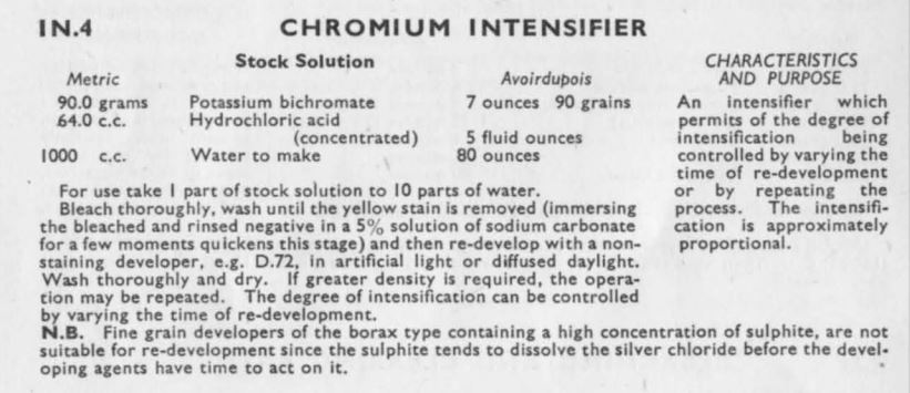

I concur that chromium intensifier provides a lot more significant intensification than selenium or sepia toning. Based on actual experience. I also had to salvage important negatives that were under-developed (like, C.I. 0.4).
I found out that to achieve truly proportional intensification --and complete clearing after the chromium bleach-- an intermediate bath of sodium (or potassium) carbonate was necessary. I saw that information only in the old Kodak Formulary.
FYI, sodium carbonate is the pH+ stuff used for pool maintenance: easy to beg a few grams.

Chromium intensifier increases the grain size by clumping. FIlm developers such as D-76 or HC-110 do a better job with bleach and redevelop. I believe potassium dichromate is likely to be the one included in a sepia kit. At any rate, it will work for bleaching and redeveloping.
If as you say there is detail in the negatives, but they are thin, I would use sepia toner which can give up to a 2 stop increase in highlight density, and some increase overall.
