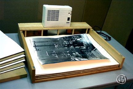

It was Salthills blotter stack dryer that inspired me to clone one for myself, using Light Impressions blotter paper and a low heat blower to push air thru the stack of corrugated board and blotters.
Prints are ...flat..., but I also discovered that sepia toned prints have a softer emulsion and tend to pick up some blotter lint unless I turn the prints frequently for the first 30 minutes or so. I can dry 10 16x20 or 20 11x14 prints ...flat... in about 1 hour.
If prompted, I could post a digi-snap of my set-up...

Having been encouraged...
Here's a snapshot of my clone of the Salthill blotter stack type print dryer.
For the full story, see my TechBlog at:
http://www.classicbwphoto.com/Blog/A40AA6E8-A280-11DB-9B69-000A95E8D0C0.html
I originally bought the blotter paper from Ligh... Impr...s, but they are rapidly shifting away from being a supplier to the film based community. Their hot button is drifting toward the DigiJunk crowd.
For an acid free blotting paper, go to Dick Blick at:
http://www.dickblick.com/zz104/22/
Or use a synthetic non-woven textile (Pellon®, or Tyvek® are examples of polypropylene filament sheet goods that won't absorb water) instead of blotting paper.
Have fun.

[QUOTES=Reinhold;416978]
"I originally bought the blotter paper ..."
I've often refered to my stack dryer as a blotter stack dryer. Now,
" ... instead of blotting paper."
As you suggest, use hydrophobic separator sheets.
So now it's a Corrugated Board Stack Dryer which uses non-woven
hydrophobic sheet separators.
www.forestry-suppliers.com/drilldown_pages/view_category.asp?cat=601 - 51k -
www.acornnaturalists.com/store/Plant-Flower-and-Leaf-Presses-C122.aspx -31k -
www.pacific-papers.com/products/plant_presses/ppk_detail.ldmx - 6k -
The above three suppliers have complete stack dryers and supplies
for same.
I bought 12 corrugated board A flute Ventilators from
Forestry Suppliers and a yard or so of what's called liner
material from a local fabric outlet. The later I cut to size.
Total, about $15.
That's it. Alternate all that with prints, weight on top, and
allow a few days to dry. If in the way it's easy to shelve. I've
some 8x10s and 5x7s drying at this time. One more day and
they'll be out. I only sponge dried this time. Usually a short
air dry is given after the sponging. Photo Grade Sponges
are still available. Dan
[ Dan
I must be missing something here. If you use hydrophobic separator sheets, where does the moisture go? Wouldn't a waterproof separator trap the moisture in the paper you are trying to dry?
The separator sheets, called interfacing at any fabric
shop, is of non-woven polyester and very permeable to
water vapor. After sponge drying the prints are sandwiched
twixt two separators, a ventilator corrugated board top
and bottom. The stack can be built of as many
sandwiches as one would care.
Hydrophobic materials do not blot; do not absorb water.
So, I no longer call my dryer a Blotter Stack Dryer.
If you'd like prints dry and flat in one operation using a
very compact, extremely light weight nearly free method
and are not in a hurry you've found it. Dan
