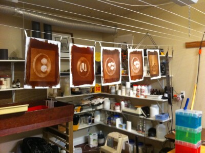

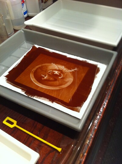

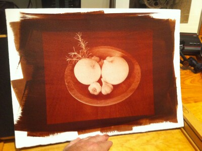

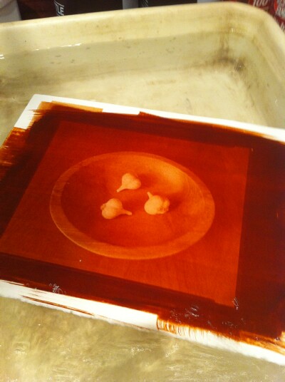

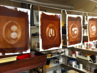

I agree with Loris. One thing to consider however is you can have some contrast control by using dichromates as highlight restrainers. adding a drop of 5% or 2% solution can have a substantial effect on the contrast. Try working with what you have first. It could get you into the ball park of a touchy-feely kind of process.
I just finished a large number of (a type of) salt prints. Here are some pictures of them.
