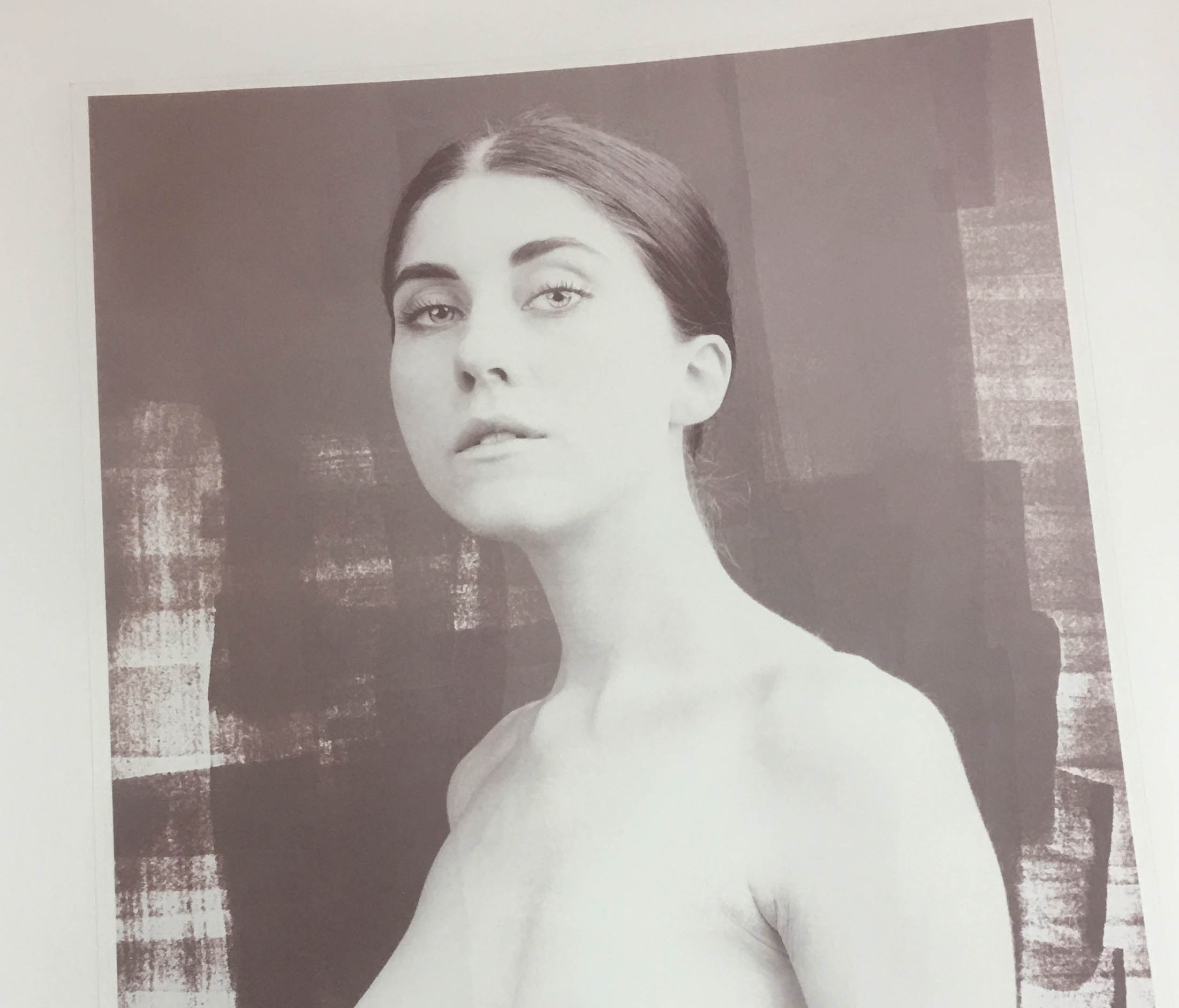

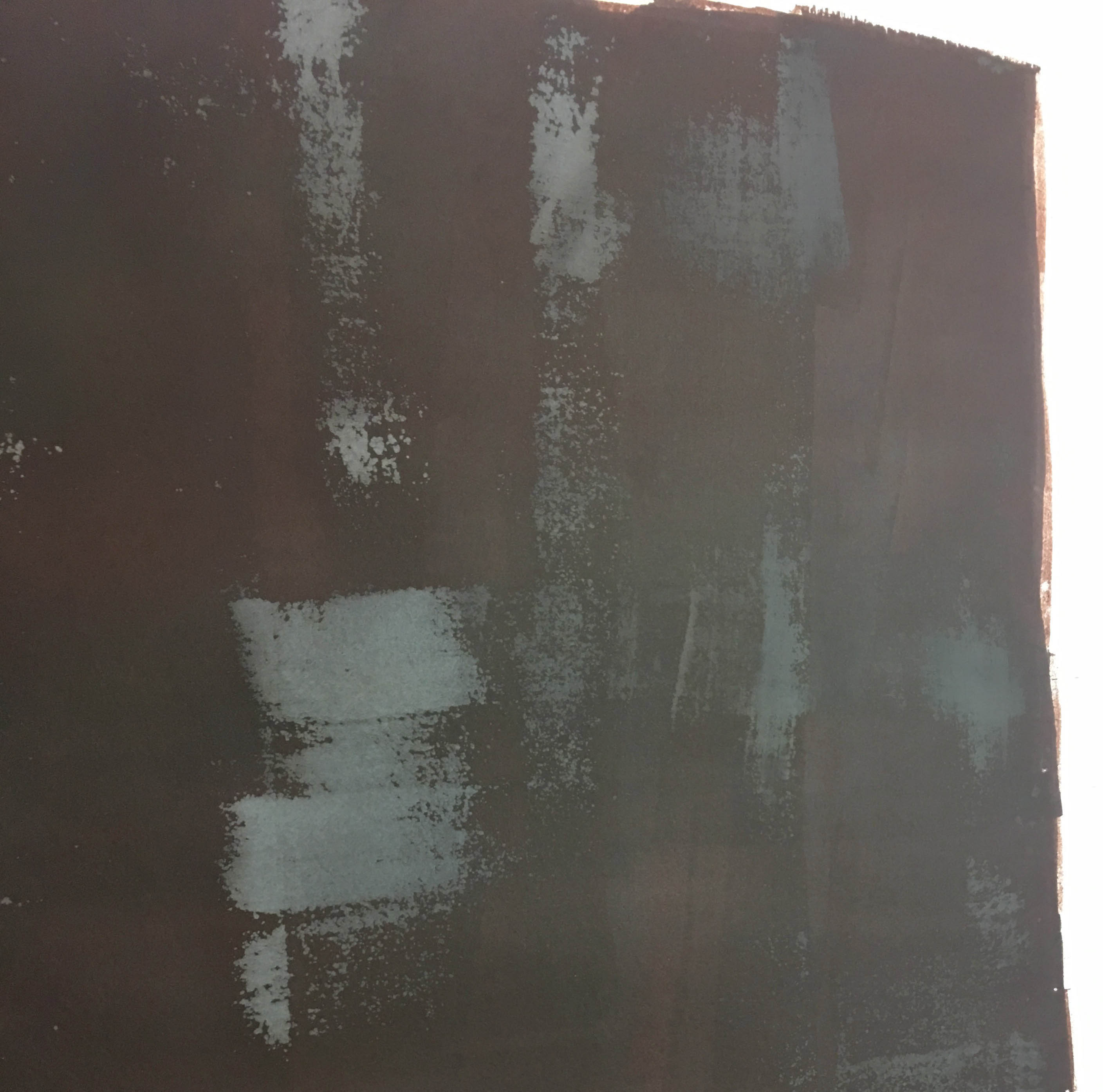

Helau hello... I am glad I found that information. Ok after reading a lot about salt printing and spending a lot of money on silver nitrate and trying out different formulas... I have now a few questions regarding citric acid using with silver nitrate. Yes I need the citric acid and I use a 10% solution in a combination with the 12% Silver Nitrate solution. I mix them 1:1 and contrasting color are amazing. The only problem is the coating. I sometimes end up with kind of strange coating marks (see picture)... I don't have that when I don't use the citric acid at all. For salting solution I use 20g Ammonium Chloride with 20g sodium citrate and 7g gelatine and 1 Later of water. Any suggestion? Thank you, Jan

I've seen this problem many times when working with arrowroot sizing, but not as often when working with gelatin.
It is caused by too little silver nitrate in relation to the amount of salt in the paper. The light areas ( nearly white ) are areas where all the silver nitrate reacted with the salt, leaving no excess. There must be excess silver nitrate for the process to work.
Note that when you mix 12% silver nitrate with 10% citric acid, you end with 6% silver nitrate and 5% citric. 6% silver nitrate is pretty weak for a salt print sensitizer.
Here are some possible solutions:
1) start with 24% silver nitrate and mix it 1:1 with your 10% citric acid. ( I recommend this, it is what I usually do )
This will be 12% AgNO3 and 5% citric acid coated on the paper.
If you do not want to mix stronger AgNO3 ( maybe you used all your AgNO3 to make your 12% solution, or maybe you purchased 12% solution, :smile: ), here are some options:
1b) use stronger citric acid solution and add less of it. if you make 40% citric acid, then you can mix 7 parts 12% AgNO3 with 1 part 40% citric. This will dilute the AgNO3 less and still have 5% citric in the result.
2) after coating your 6% silver nitrate, let the paper dry in the dark for about 20-30 minutes, then apply a 2nd coat ( or increase to 3 coats if this is not enough ).
3) after coating your 6% silver nitrate, let the paper sit in dark for 20 minutes, and then WASH it in several changes of water. This will remove any excess salt. Then let the paper dry completely ( I usually wait at least 6 hours, and have never tried to hurry it with a hair drier ), then coat again with a 1% solution of silver nitrate, let dry again, and print.
The 3rd option takes longer because you have to dry the paper twice. The second coat of silver nitrate assures there will be excess. It often works in situations where everything else fails, but I've found it can also be difficult to get the strongest possible darks with this method.

thank you for your long answer! I mixed new silver nitrate as 24% solution and my problem is gone!! Thank you so much for your help on that. Another APUG user had a similar idea about my coating problem.

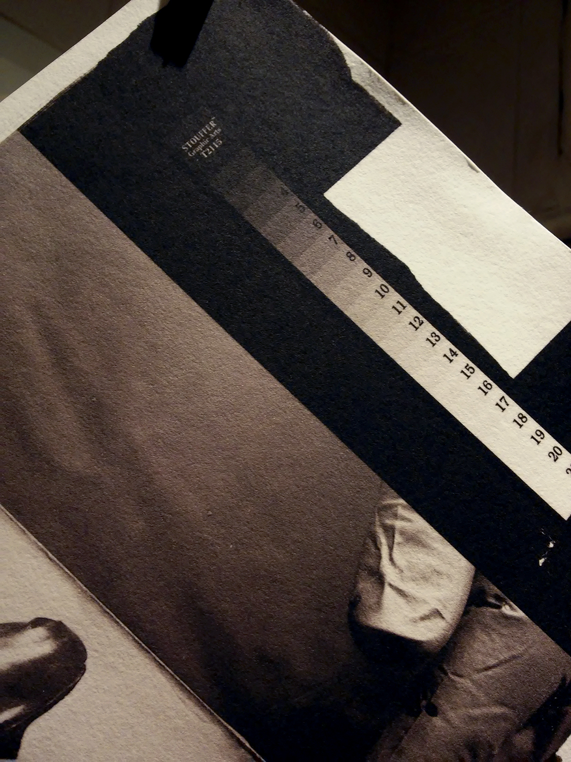

To test if there is visible fog, or some light sensitive silver left in the paper I have left the papers under the UV for 30 mins when they dried.
I am confident this is a fog free method.
