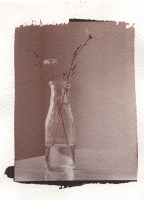

FWIW I abandoned using Arches for any alternative process print long ago as the sizing did not seem to be consistent. The emulsion would not take evenly and lots of round and ovoid areas of different densities appeared during processing.
I'd suggest you try a different paper. Perhaps Cranes Cover, Cranes Kid Finish or Strathmore 500 plate.
Can you post a scan?
Blochiness is usually the result of uneven drying (and hence sensitivity) before exposure. But it sounds like post-exposure your print did not suffer from that effect but rather turned late in the processing.

Here's a low-res scan, you can see the blue-ness at the bottom of the image..

I do not have the problem. My processing differs in several aspects from yours, but I believe the main one is that after exposure the print is soaked once again in NaCL solution. This seems to help probably by uniting all of the silver with the Cl radical rather than leaving some with the NO3 radical. This gives me more intense shadows and thus improves the contrast.
