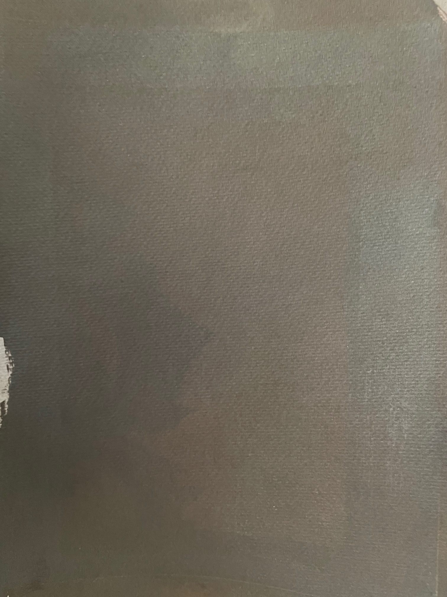

I've been attempting to use the salt print process using the Bostick-Sullivan kit. I've made three attempts, following the instructions to the best of my ability, and every time the print seems okay throughout the entire process: developing, fixing, etc. But after I leave it to dry, every time it comes back looking like charcoal. Like it's entirely overexposed. Seriously at a loss here as to what could be happening.
Here is a photo during fixing:
Here is a photo once dry, after a 20 min wash.
Please help.
Your negative has far too little contrast. There's virtually no separation between highlights and shadows. Due to the dry-down effect, the entire image will sink into an indistinguishable mud pool.
There are issues with dmax in your process; perhaps the paper you picked up will help. If not, post back.
But you'll need to fix the problem with your negative first. If you're using an inkjet printer to produce a negative, try experimenting with two parameters:
1: ink density; particularly Epson printers allow this parameter to be manipulated. You can often go to +20% or so to get denser highlight areas.
2: color combination; print a rainbow onto transparency material and then print that using the salt print process. Note which color(s) create the highest density and then use that/those for making your negatives. Back when I did this I ended up using yellow + black.
You may find your printer is simply not capable of producing the density required to make a full-tonal range salt print. This issue is still overlooked by many; if you can't make a salt print that has both pure paper white and a very, very deep brown (that tones in gold to pure black), then it's about 95% sure your negative is not up to the job.
