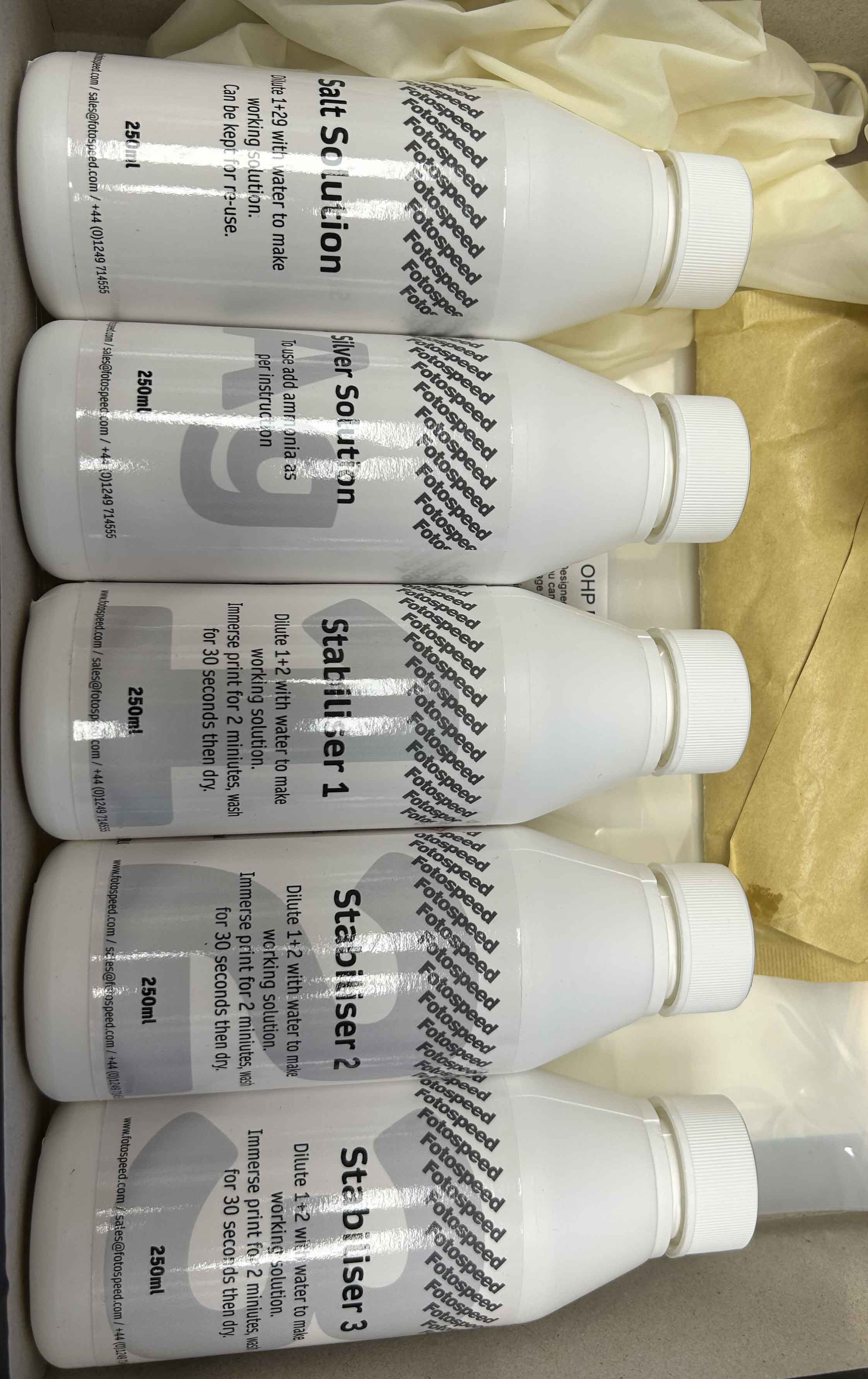

Just wondering if any of you lovely people may be able to advise on something. I'm a Photography Technician at a school and where I've dabbled in the past, I'm not well versed with alternative processes. I found these two brand new kits today (see below) and having googled the processes I'd love to give them a go. My problem is that they're both very much expired. The Salt Printing kit has a date of 2021, and the Gum Bichromate a date of 2018. I was wondering if it's worth the effort to even attempt using them because of this, or if they should sadly be disposed of without even opening. Thanks in Advance!
It's not like you have anything to lose (except your time) by trying them. Of the two, salt printing is easier. Basic salt printing is (1) coat a sheet of watercolor paper with a 2% solution of salt, let it dry. Then (2) coat the salted paper with a 12% solution of Silver Nitrate and let it dry. 3- contact print a negative under UV light source then wash in water followed by fixing. These kits usually make the processes more complex than necessary.
Both will likely work OK. The only thing that may have expired is the gum solution; you'll notice soon enough if it has grown mold etc. Probably it contains a fungicide that has prevented it from deteriorating.
