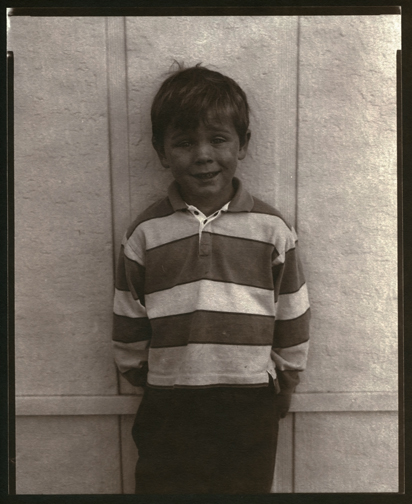

Well. managed to get a couple decent prints, only one worth framing up.
Bryce
Scanned salt print
8x10 negative -- blue sensitive x-ray film developed at the hospital's lab
