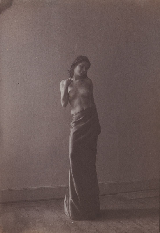

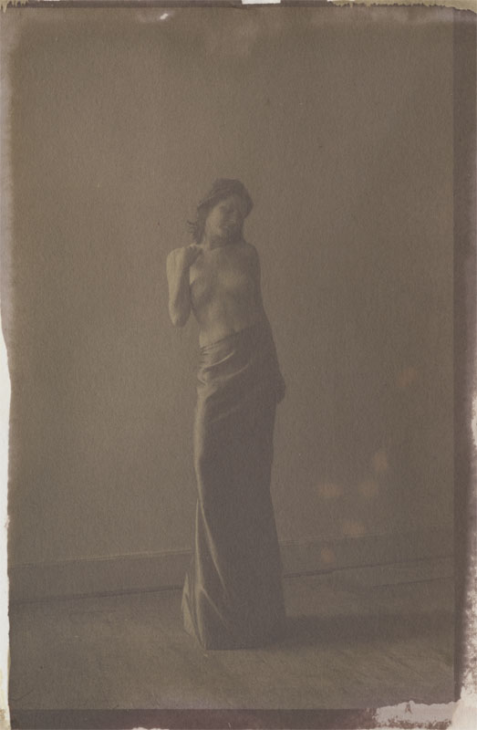

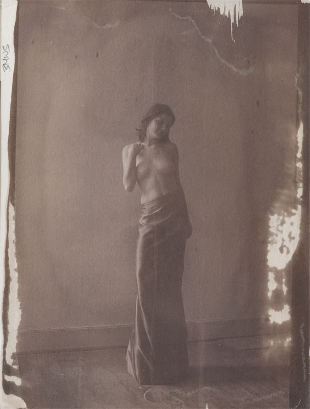

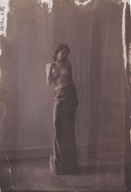

For exposure I use a facial tanning studio (£20 off of the auction site :tongue:) which I find really controllable. I generally use it at 30cm from the print. This is NaCl, fixed in hypo on archers plantine.
ok so....
salt 1st test copy - Brush coated test print. this is 2 minute exposure. Very low contrast.
salt 2nd image copy - Brush coated test print. Better contrast - 3 minute exposure - still not enough though.
salt 3rd test copy - Brush coated test print. 3 and a half minutes. about right contrast and exposure for this print for me.
final image - Rod coated final print. 3 and a half minutes. Fixed for 4 and a half.
Don't click on the thumbs if nudity offends.:smile: Hope this helps a little.
Best wishes
Ian
