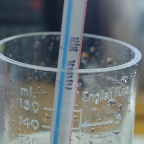

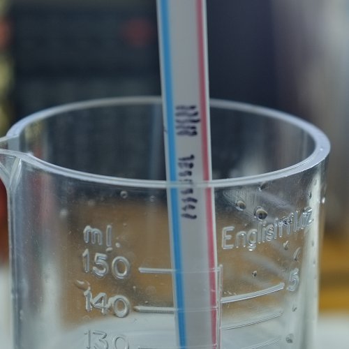

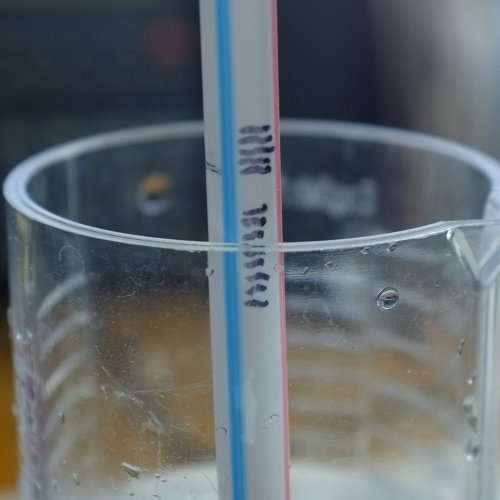

Hi Everyone,
In the spirit of the article that crisasenbrey pointed me to, and in keeping with the spirit of what I'm doing and my knowledge of chemistry, I made the hydrometer using a straw and playdoh. My bottles of mysterious salt water and distilled water were in the same closet, so they should be very close to the same tempertature.
Here is 100ml of distilled water:
here after adding 2 grams of salt:
here with a total of 4 grams of salt:
and here is my mystery saltwater:
I'd say it looks like my mysterious saline solution is a little bit less than 2% salt. It certainly isn't 6 or 8% salt and it is not supersaturated.
