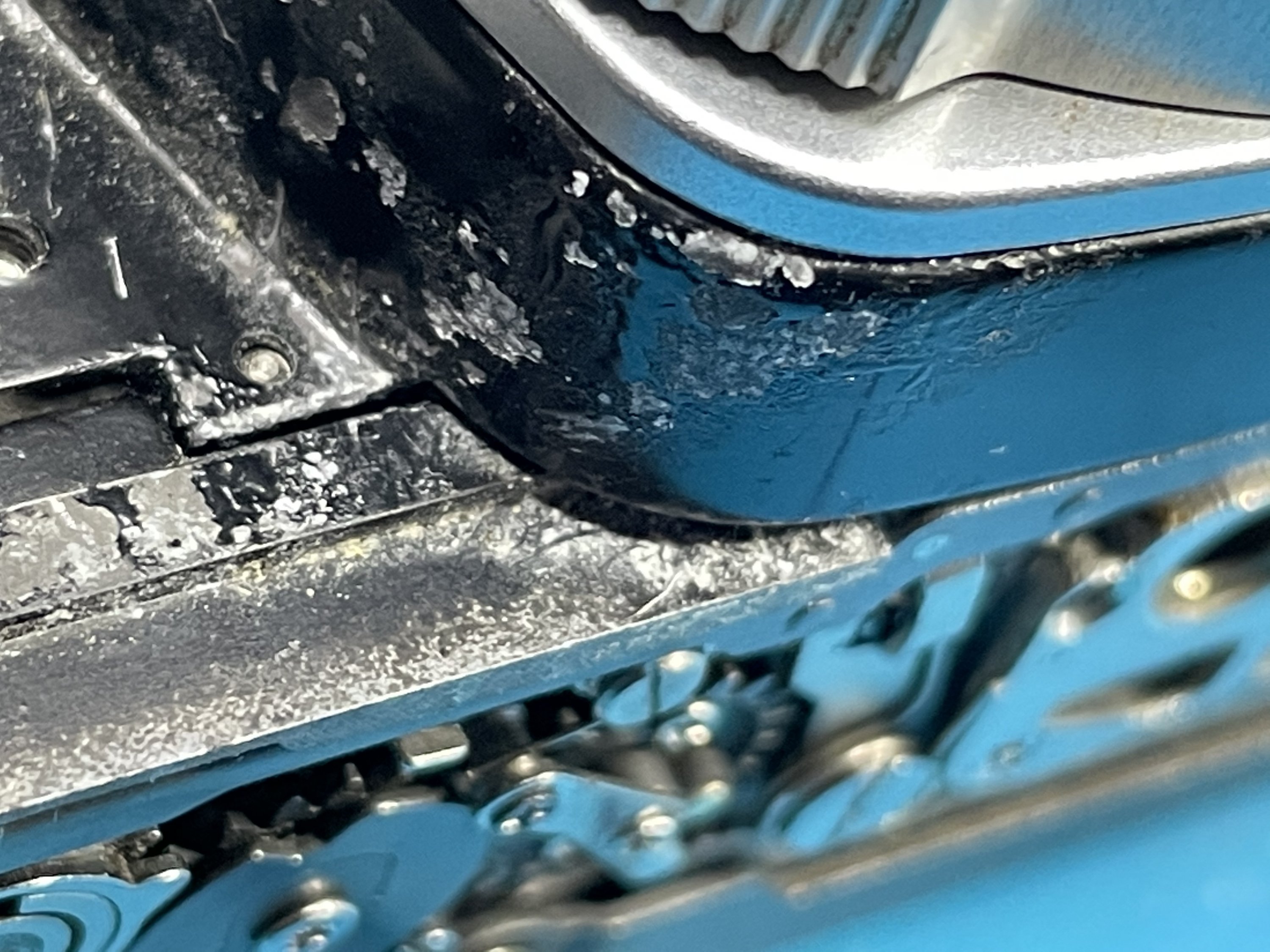

The key word here is "crusted". Seems like a corrosion problem, hence the success with penetrating oil. If you want to get the camera working again, you will almost certainly need to strip it down and clean the parts; corrosion gets into everything! In the meantime, could you post a photo or two of the camera? (A picture is worth a thousand....)

Thank you. I’ll take a closeup of the offending contamination...

As promised, Some remaining crust after cleaning...
