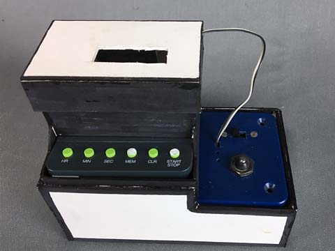

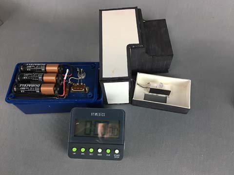

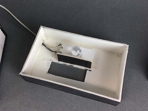

I have used a deep "box" over a timer with a small light source inside and a small hole to peer through. That pretty well avoids stray light, although I won't claim it's convenient. Rev 1 was a cardboard tube about the diameter of a mechanical stopwatch that I installed a neon bulb inside with a fairly large resistor to keep the brightness minimal. That was in the 1960s before LEDs. Rev 2, much more recent, is a battery operated kitchen timer which can do count ups, count downs and Zeus knows what. I put a battery holder and some switches in a plastic "project box"and made a kludge out of scrap mat board to hold it all together. It has a red LED inside and there is a momentary switch for just pressing to read, plus an on-off switch that will turn it on continuously.
My main annoyance is there are too many buttons across the front edge. Having been using it to time X-ray film development under a Wratten #2 safelight, I have dabbed white acrylic paint on the two buttons needed for normal operation. If I get to using "real" film, I will add a strip with cutouts so the non-normal buttons cannot be pressed without special effort. It beeps at the end of a countdown, so for my limited use, it works.
Illumination ...
Exploded view ...
