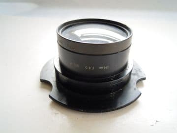

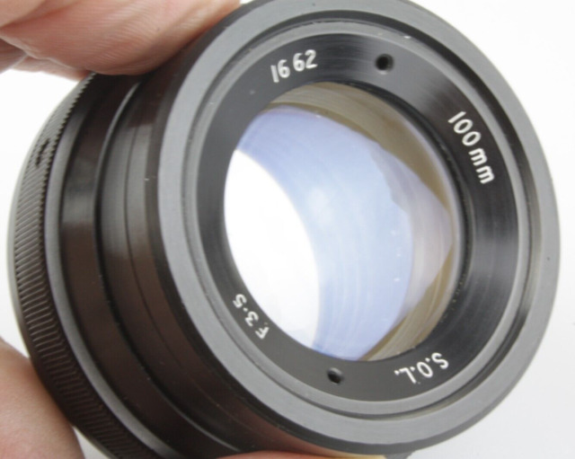

I have seen for sale with this description:
A rare British enlarging lens, S.O.L. were part of the Rank (Taylor Hobson) lens making facility, likely from the late 1960s / early 1970s ... Mounting thread is NOT the usual 39mm, this is a 1 3/4" (Imperial, not Metric) thread
I can't find specs. I guess this may be a Tessar scheme?

Interesting. I've found no evidence that Taylor Hobson had anything to do with S.O.L. I wonder why the seller thinks so.
removedacct2
May 26, 2018
366
the seller is a trader of used photographic equipment, shops in Liverpool and Manchester. Told me the owner has extensive knowledge of british lenses, but currently away on holidays. I had a look at Wilkinson's lens vademecum but found not mention of "SOL" or "S.O.L."

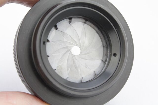

Not Taylor Hobson as far as I know - worked there from 79 to 92 and never heard of these? also worked for Cooke. maybe related to dallmeyer there is one photo I found on the net of an s.o.l. lens with a Dallmeyer lens box next to it with Dallmeyer crossed out and s.o.l. hand written in. Could be a decent lens though, just judging by the number of iris leaves.
Also looks like modern-ish anodised aluminium finish.
indeed, what caught my eye. Hence the idea it may also have more elements/groups than the ubiquitous tessar.

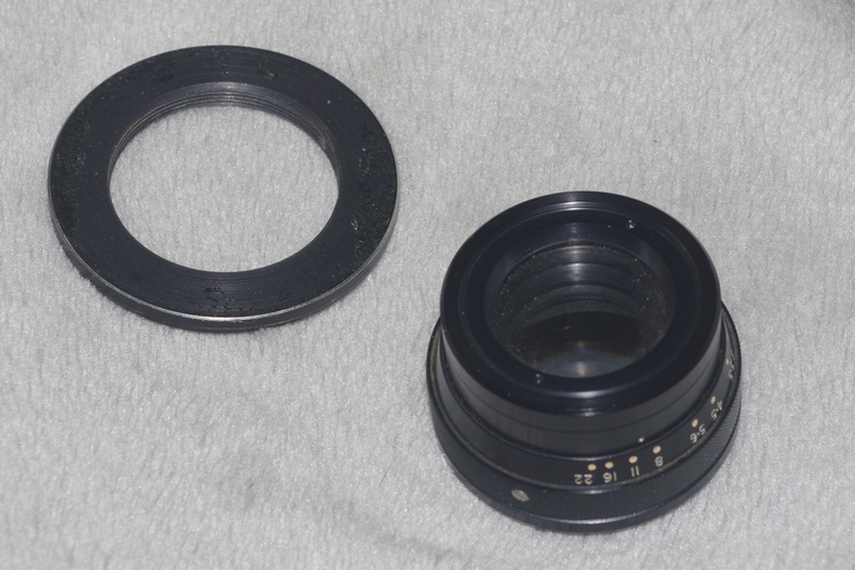

I think the unmarked lens I got yesterday Might be the same one, the aperture ring knurling differs & mine has no nameplate.
However the overall similarity was good enough I did some more investigations into SOL. I think this might refer to Scientific Optics Limited.
I've not been able to confirm if the mount on mine is M44x1 or 1 3/4" 24tpi, it does seem to share the same 12 bladed iris & 4 element design. The front element size does calculate to a focal length of about 100mm/4"
Do the experts here think it's likely to be the same lens?
