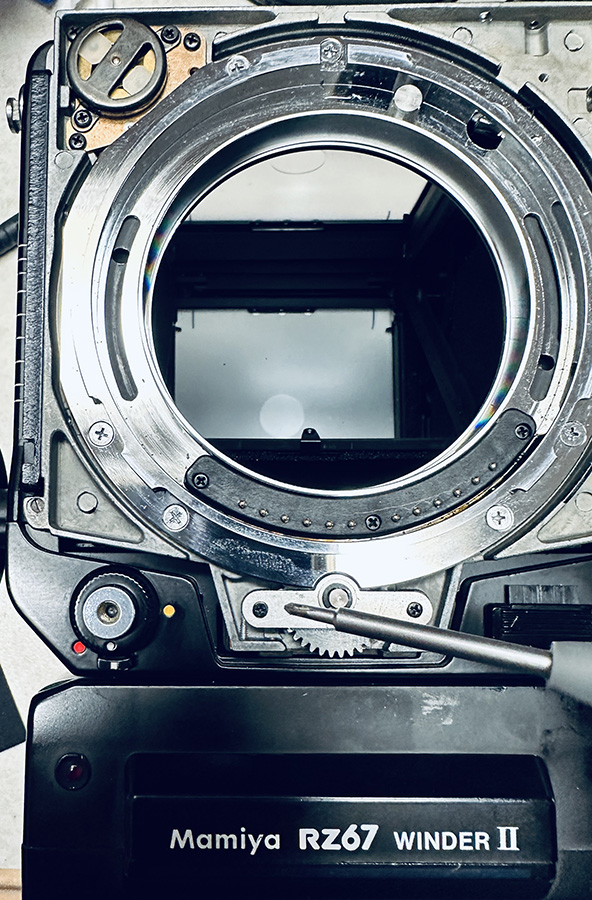

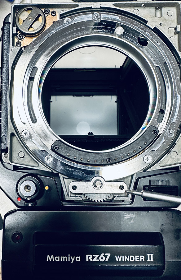

Hi, I know this is an old thread, but I had the same issue on my RZ67 and figured it out. This happens on my 90, 140, 150mm lenses but not on my 50mm. I ended up removing the front lens cover and loosening the gear mechanism cover just slightly and that was all it needed.
