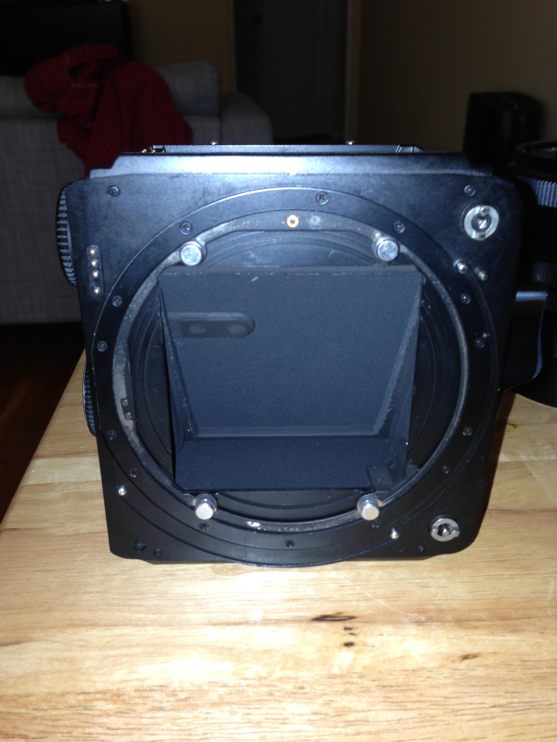

Hello all!

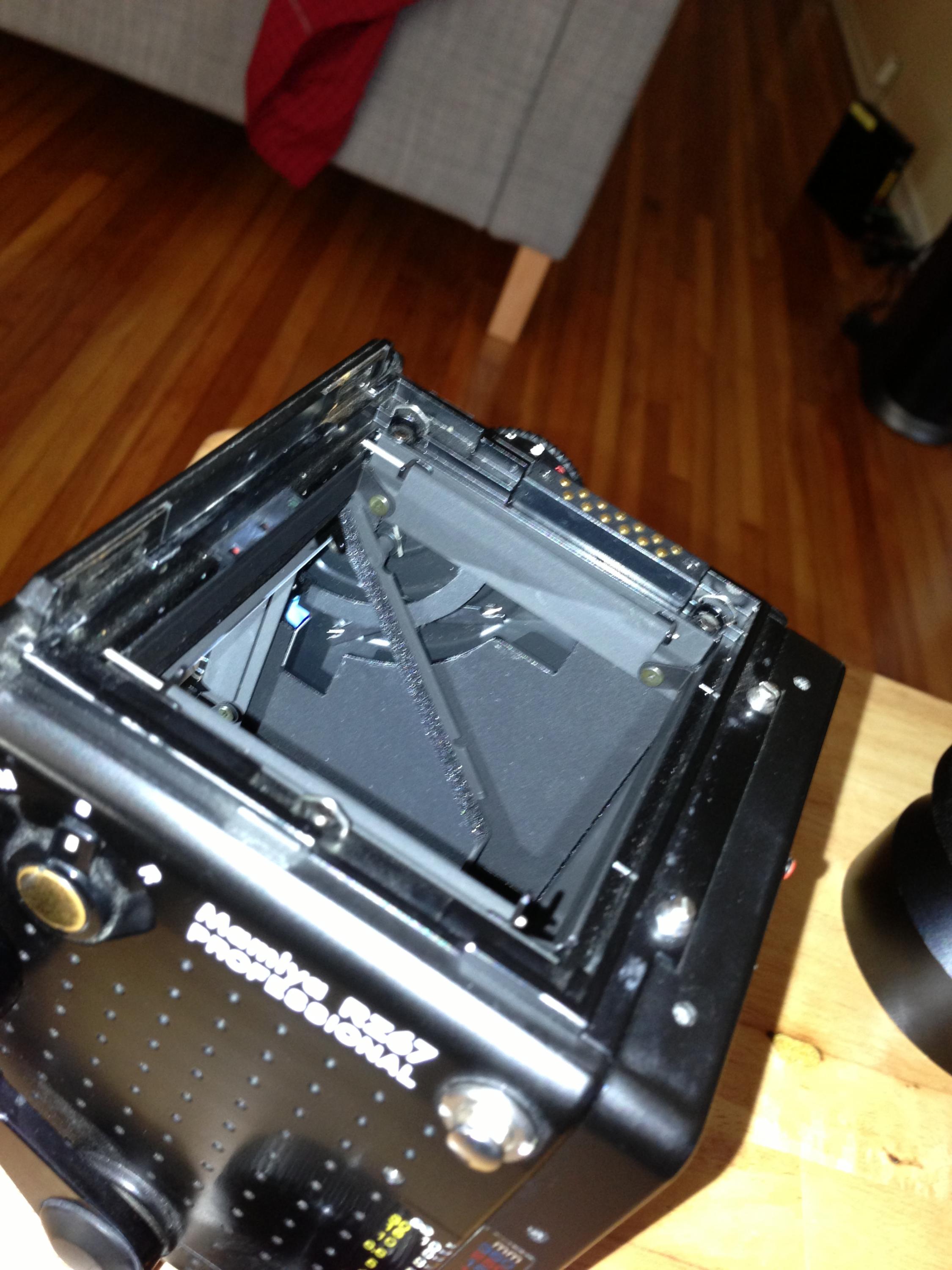

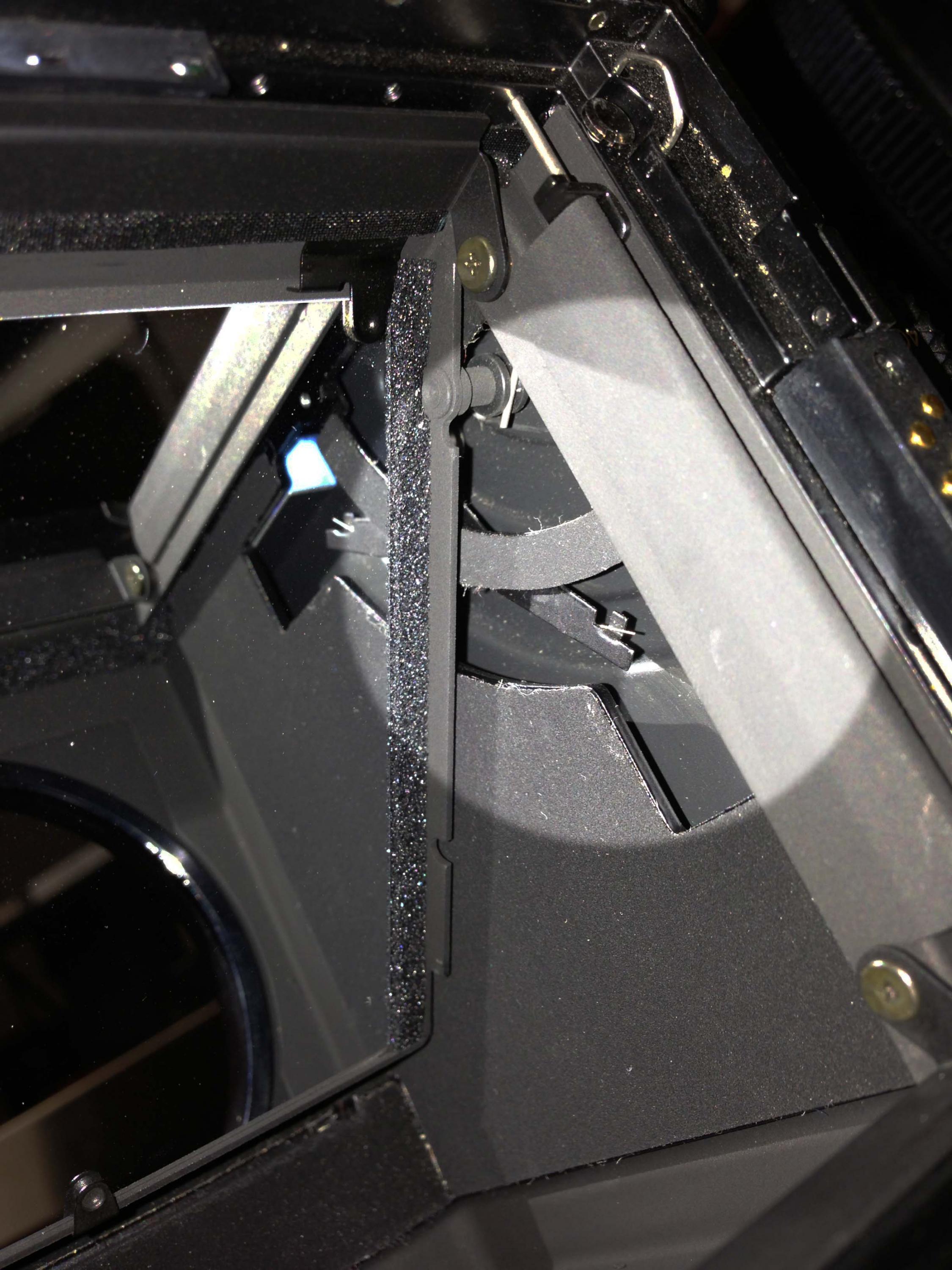

The other day I went to cock my RZ and noticed the lever wasn't 'cocking.' Upon further inspection I realized my mirror and light baffle were not rising. So, my issue is that upon completely cocking the RZs lever, the shutter is not cocking nor is the mirror being set. Haven't dropped it nor (hopefully) mishandled the body. I've tried different lenses and backs (Polaroid, 120) to see if that kicked it into gear somehow (newbie desperation moves!) to no avail. I do notice something by the mirror that I am unsure of being normal or not; two little arms within the body wall seem 'unhinged'. I attached some photos of the body field stripped and of two metal 'arms' that make me raise an eyebrow.
Any input is greatly appreciated! Thanks all.

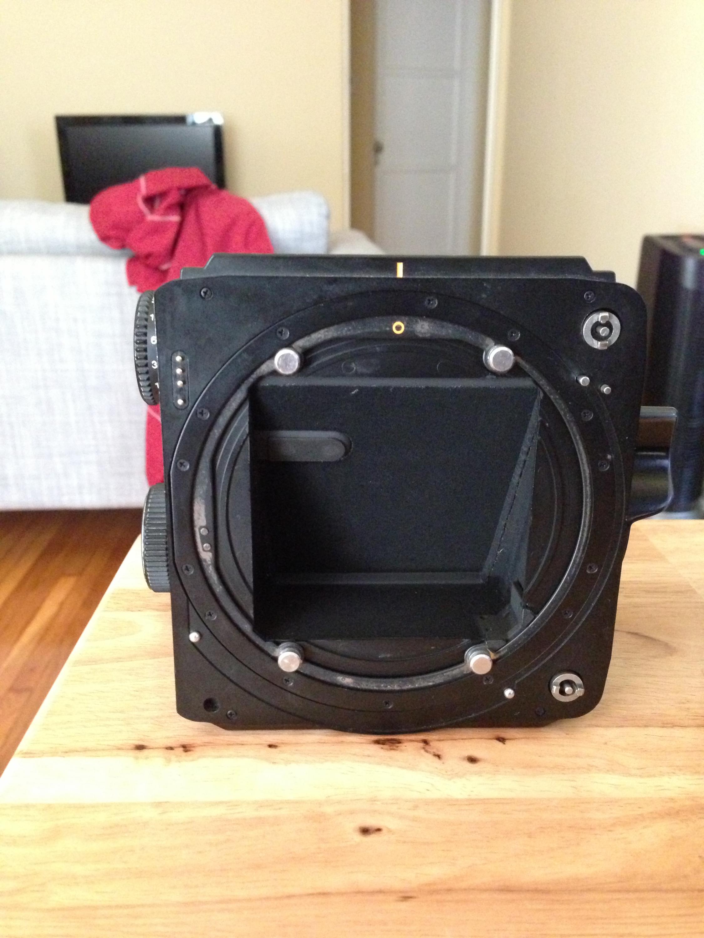

Yeah, tried firing the lens manually. There's plenty of advice online regarding the mirror being stuck open but little if any of it stuck closed. I wish I had more experience with this guy. Lever works fine, shutter release button also depresses fine, just can't get the darn mirror to cock! :sad: I tried this with different lenses and my Polaroid back (knowing the absence of film-forwarding mechanics on it allow me to cock and expose at will as opposed to a 120 back) but no luck. When I advance the cocking lever forward I can see the film advance coupler moving freely, too.
Oh, and I can manually lift the light bellow/mirror with my fingers and they move to the open position fine.

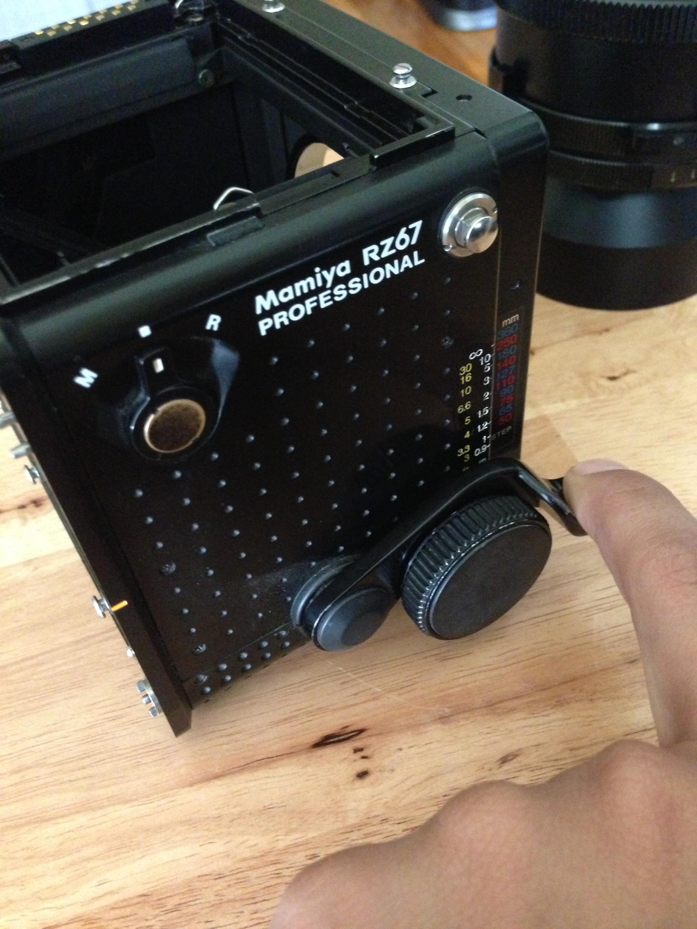

Ok! Read my battery with a voltmeter and I'm only getting two volts from the 6v that I JUST purchased. I'm not getting anything from the monitor lamps either. Could that be the culprit? What gets me is that even without a battery I should be able to shoot at 1/400. I'm gonna get another battery and cross my fingers. Thanks all.
Can someone with an RZ reference their own based on that last photo from my original post? Those two little arms just seem askew somehow. Would help a bunch if they looked the same on a working RZ.

While the battery may well be dead, as you say the camera will work without. You need to put it on the orange dot to make it fire though...
Polygot. You beautiful, beautiful soul! I got it to fire! I didn't realize you had to turn the collar stop level for emergency firing operation. It's firing! (On emergency mode.) The baffle sounds a little weird when I cock it but the sucker fires! Will report back with new battery. Thanks all!
