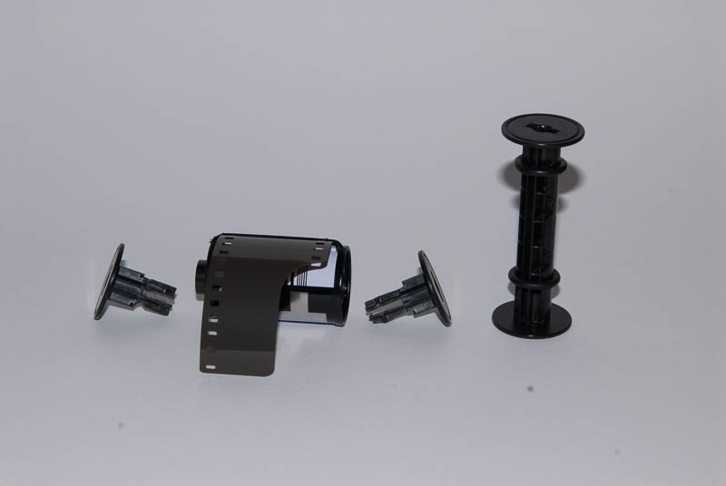

This may be a little out there but please humor me. I’ve seen 3D printed components that can take a roll of 35mm and allow it to be shot through a medium format camera. Has anyone experimented with using such a hack to create panoramic images on 35mm? I’ve looked a bunch online but haven’t found anyone talking about this. I’d love to try this out but I’d save some headache, heartache, and film if anyone knew exactly where to mask off the viewfinder. Would the ratio be anywhere near that of the XPan? Besides that I wonder if the backing plate would be an issue since there’s only the thickness of the film and not the paper. I guess I should mention that I’m not ready to part with the money it would take to dive into the XPan market (I know there cheaper alternatives). I’d just love to experiment with the wide format aspect ratio to see if I even have what it takes to meaningfully compose in such a way.

Don't spend your money on an XPan unless you have plenty to go around. I would find a old 220 back for a trial. The 220 backs sell for CHEAP. XPAN is a neat camera. Very expensive with no spare parts.
Try it with whatever back you have. Xpan is something like 24x60 mm.

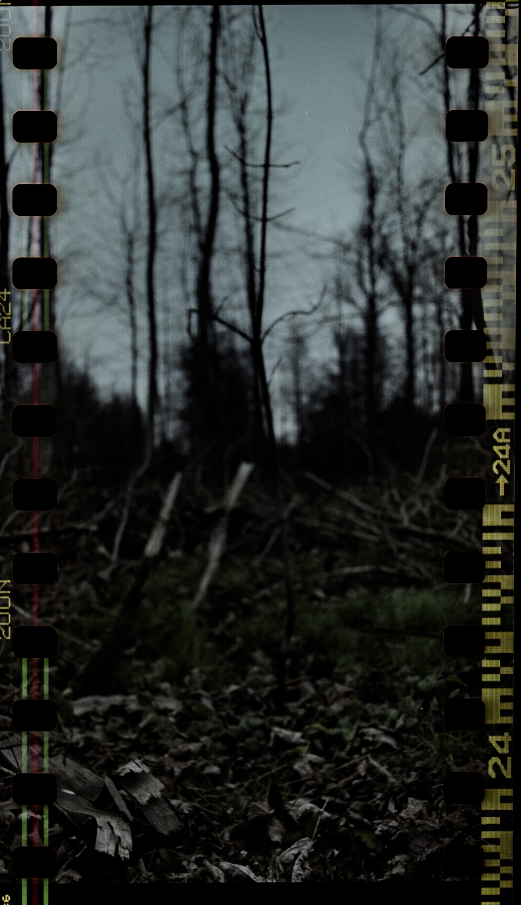

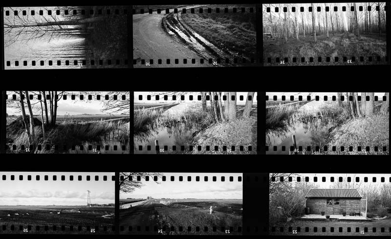

You can 'hack' any format to a RZ67; 16x70mm, 26x56, 35x70, 46x70 (or even 9x12cm, well not so panoramic but doable) Make your own (takeup)spools in what ever your size you wish from old 120 spools.
Draw a thin line in the middle on your mask as a artificial horizon & after that its a bit of guessing
https://www.flickr.com/photos/77846450@N00/27185894158/in/dateposted-public/
https://www.photrio.com/forum/threa...4-exp-weird-problem.95043/page-2#post-2164815
https://www.flickr.com/photos/77846450@N00/18048569815/in/dateposted-public/

i have a rz67 proii and have been also interested in trying to shoot pano in my camera. i found this video: they use a rb67 and use the 3d printed 35mm spools. i asked about its use in the comments.
regarding the mask you just get a cardboard and cut out the aspect ratio. You will get around 24x65/70.

What camera did you use for those shots, Hendrik? They look very cool!
The thread title and the home-made adapters illustrated at the beginning of the post suggest to me that it was an RZ67, although the adapters look similar to the ones I've tried out in my RB67.

6x7 proii, I have also a 26x56 back but then the sprockets aren't visible

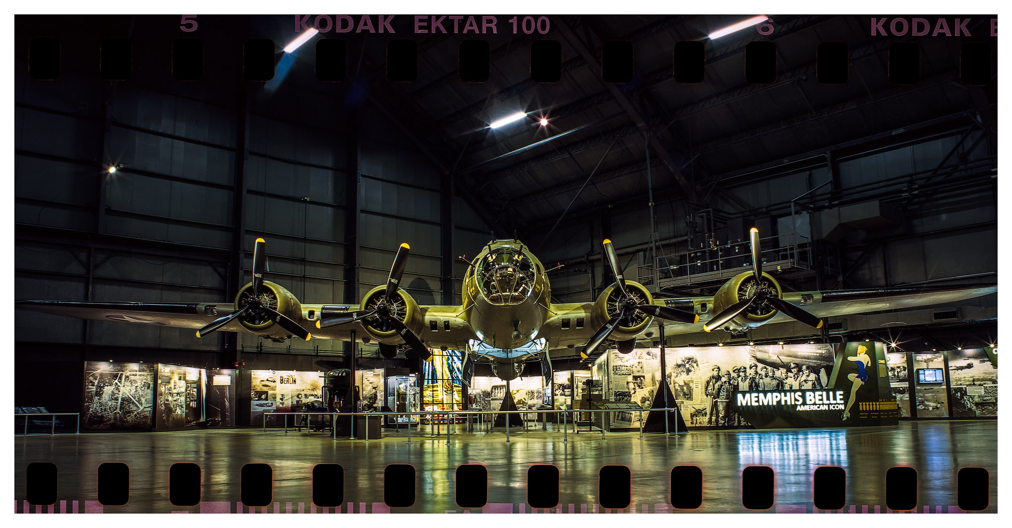

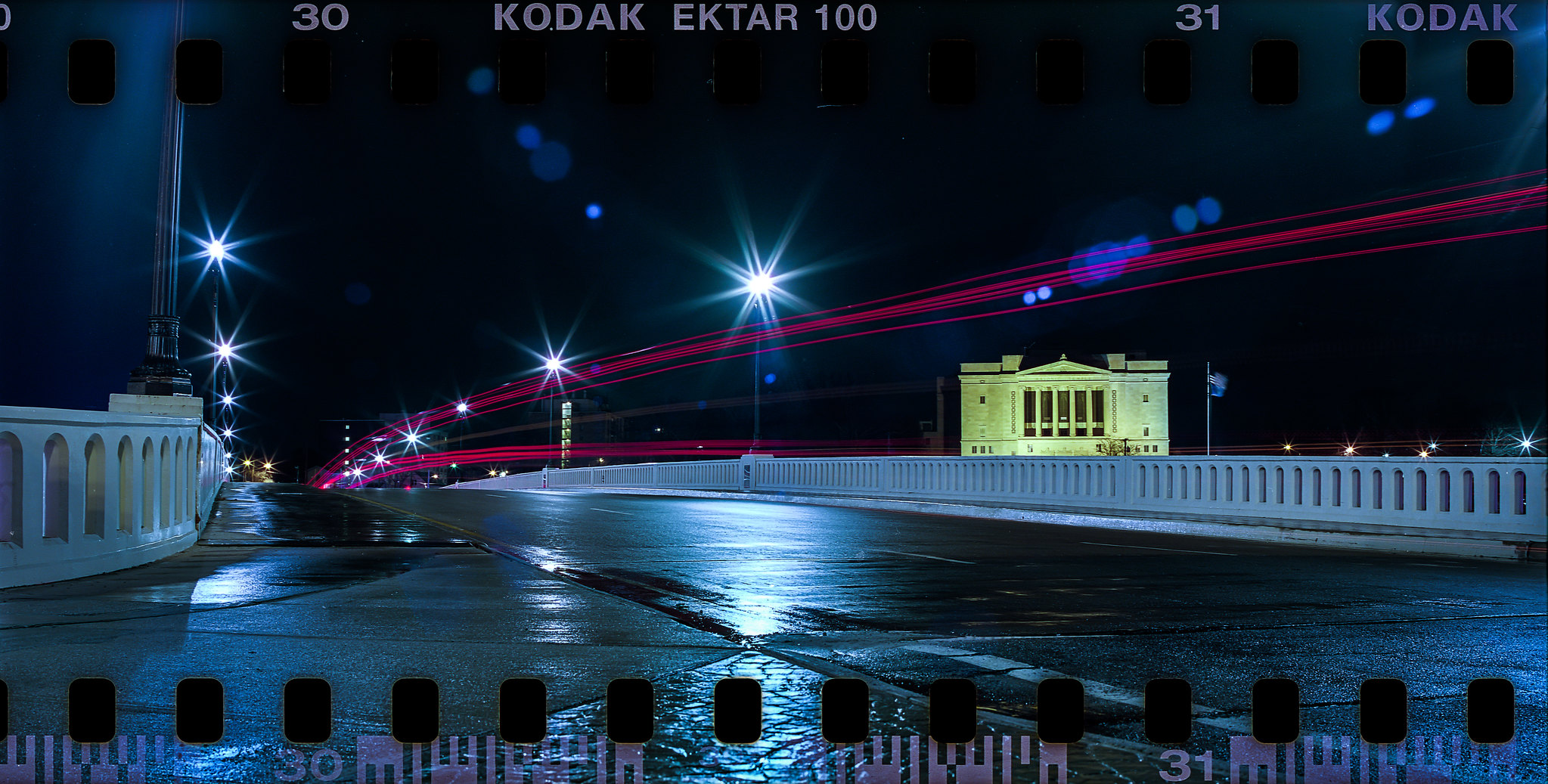

First post here, have been reading the forum for a while but wanted to add to the conversation. I've shot many 35mm pano images on my RB67 ProSD with a set of adapters I bought from eBay and a 220 back. Typically I get around 17 shots per roll of 36exp 35mm film. I had to do a little modification to the back so that the counter works properly but other than that its basically plug and play. The only drawback, if you could call it that, is that once done you just have to put the back in your bag or pack and then later when at home in a dark room or changing bag you can remove the roll and then develop it. Since there's no provision for take-up once shot.
