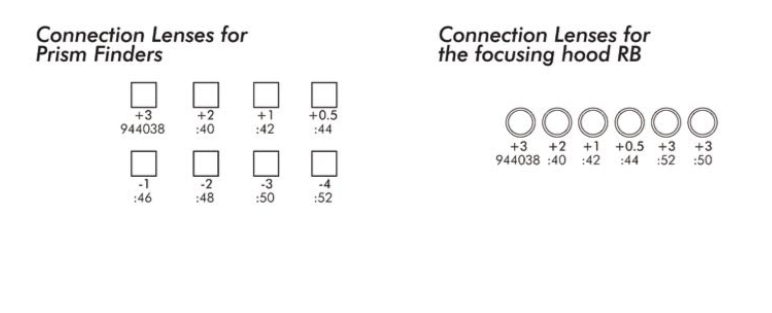

There were followig diopters for the focusing hood and for the prism finders (from the RB67 Pro SD System Chart).
I guess with the help of your optometrist you should be able to find the right one. If you can't find the right RB67 Connection Lens maybe the optometrist can fit another lens into the frame.
