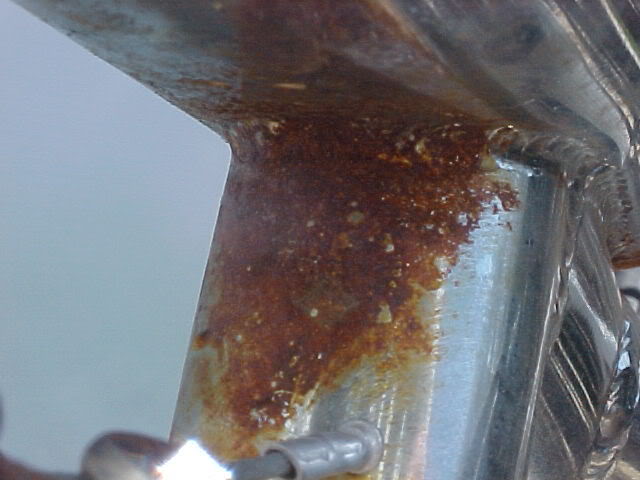

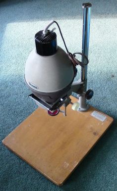

I just got a Bogen 69 Special enlarger in excellent shape ... but the column has a considerable amount of rust on it. The bellows is excellent as are the negative carriers (35mm and 6x7), but the rust on the exterior is annoying, at best, to look at. This does not affect functionality at all but I am wondering who knows the best way to get rid of this rust? Is naval jelly the best here? Thank you. - David Lyga

Light surface rust comes off with WD-40. I'd go with naval jelly for more severe rust.
An example of naval jelly on chrome, (not mine) from the internet:

Yes, the rust is rather severe. And, if and when rust has been removed. should the bare metal be coated with anything? - David Lyga

From this picture, it looks like the column is chrome, and in that case, we hope the chrome will remain, rather than bare metal. WD-40 protects chrome but also gets sticky, which may alter free column movement. If the column is really bare metal, it was probably originally coated with grease (or should have been :wink:) to prevent rust.
I'd think good design chrome column should not have metal-to-metal contact. It should have nylon or other plastic in contact with the chrome. In that case I'd probably not put anything on the clean rust-free chrome.
Can you tell if there is metal-metal contact between the column and the head?

The column seems to be chrome, but a worn chrome, tending towards bare metal. Of course, the column supports the head and that head glides along the column as you turn the crank. The actual gliding contact is via plastic washers. - David Lyga

I would just replace the column with a new length of chrome pipe, ought to be able to find one on the internet. My first thought was that you could make the column taller, but Bogens columns are not off set or slanted so you can only raise the head to the point that the head cuts of the projected image.
