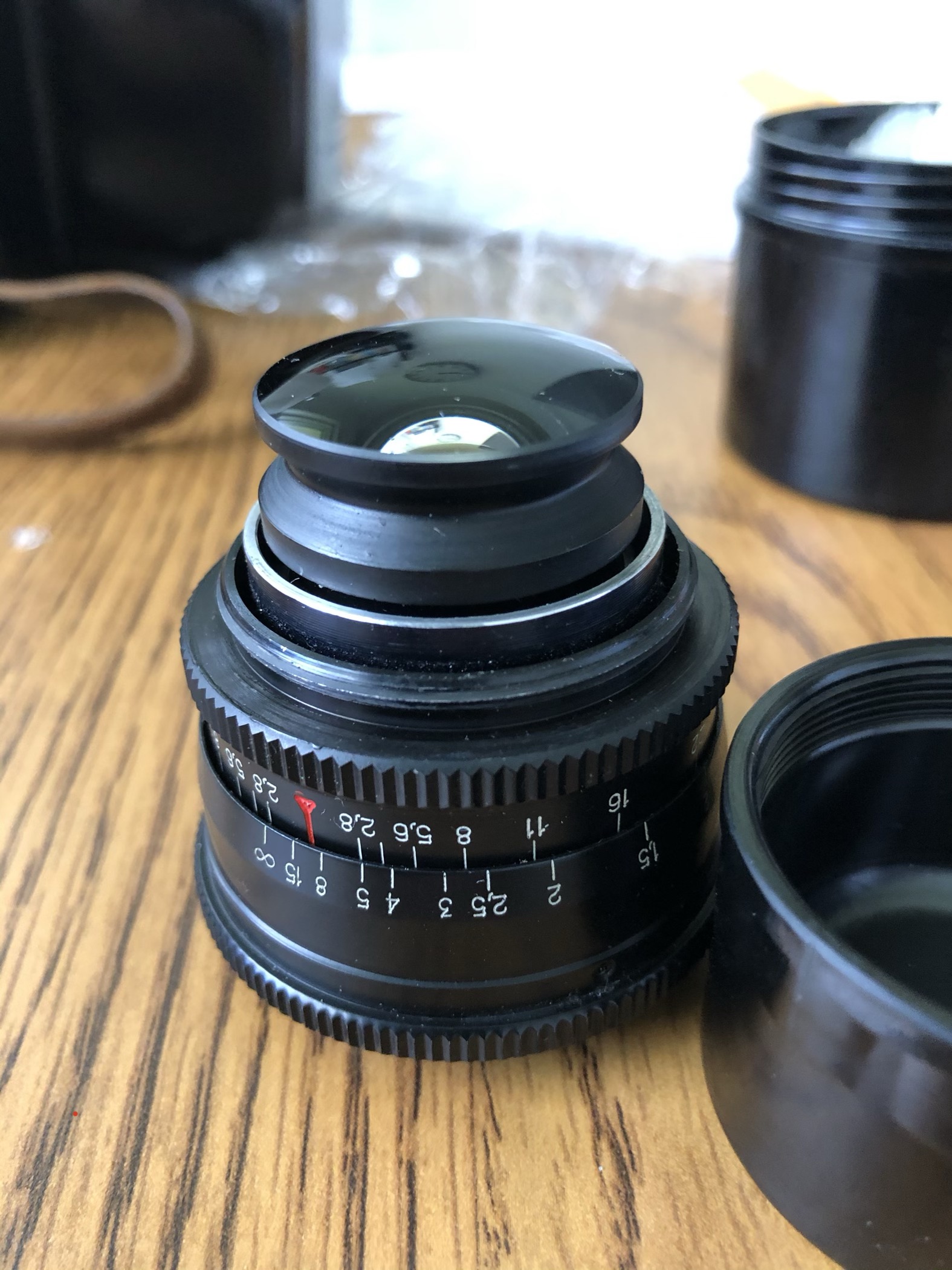

I just received a Jupiter 12, but the rear element hits the shutter on my M9. Has anyone been able to use this lens on an M9? My summaron 35mm with eyes went missing along with a 90mm and a 50mm :sad:

Hi Brian, welcome to the forum :smile:.
On digital Leica many older lenses will not work, for example DR Summicron is also one of them. All lenses that are deep in the body will generally have problems on digital Leica, either touching the shutter, or having color fringe. I never had digital M body, this is from what I have heard from other M users.

Darkosaric, thanks for your reply. I’m going to gret a Voigtländer 35mm with M mount and return the Jupiter. It was an interesting experiment.
As a curiousity, I wonder if the smallest extension ring between the camera and lens would “work” or whether it wouldn’t focus correctly.
I’ve tried to find an article on how the rangefinder overlay image for focusing works with the focusing ring.
In other words: If the images line up in the RF viewfinder, is it in-focus or does the extra extension make it appear in-focus in the viewfinder, but it’s actually out of focus?
What I wrote probably doesn’t make sense.

I think that extra extension ring will bring all outside of focus. Once I got Orion lens with 39mm mount, and use it on M3 with adapter. But it was some strange version or the lens, not for Zorki/Leica, and even when my M3 showed focus was ok - all was wrong. Sold the lens as defect.
