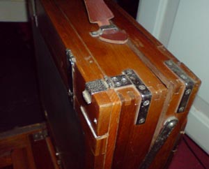

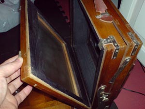

Here are two pics of what it looks like. I am searching for a replacement normal 8x10-back to fit to it as well. It should be easy to do. (If I only could find one in my price range.)
/matti

thanks matti, people confirmed the possibility of horizontal/vertical shots

The back on these cameras only take the supplied plate holders. There is nothing wrong with them but they don't take normal 8x10 film holders. When I use 18x24 cm film I have to use 3M-sticky spray mount or jam as Ole (I actually use honey). It works but it would be more convenient to use ordinary film holders as well. I already bought a 5x7-back that I plan to mount some day.

You can also use sheet film adapters - thin metal sheaths that you slide the film into. I use these for all sizes up to 18x24cm, so I know they exist. the jam trick I only use for even bigger, floppier sheets - 24x30 and 30x40!
