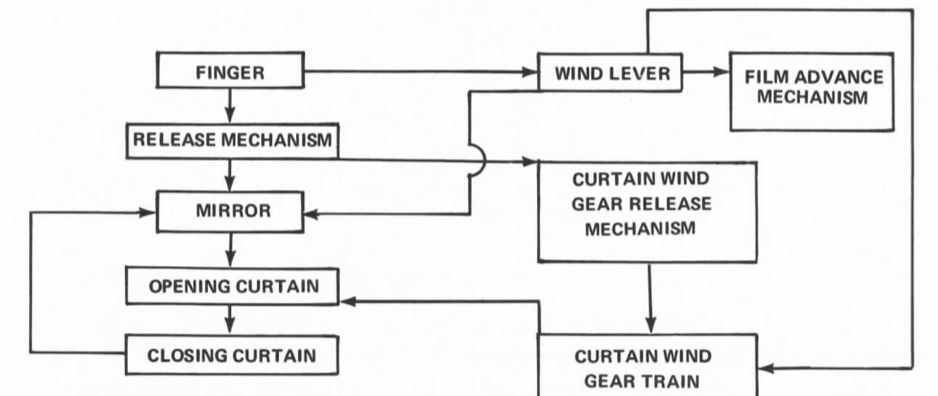

The activation sequence in many 35mm SLR cameras is similar.
