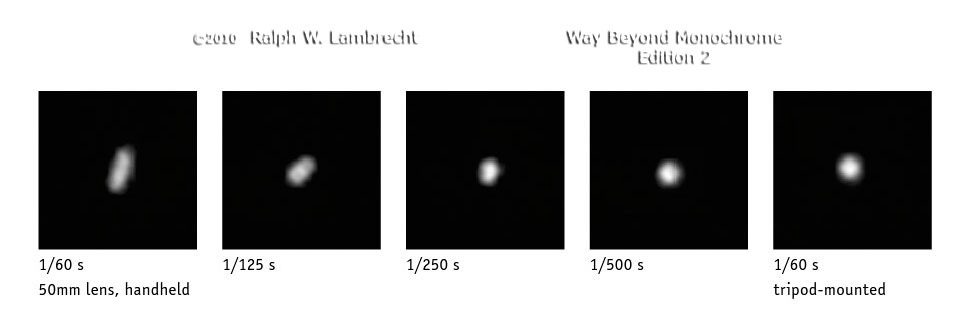

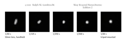

As Ian said, this is a 35mm rule of thumb, and it works for images when sharpness is not critical. But, to get the highest resolution possible, the use of a tripod is essential, and the rule-of-thumb, requiring nothing less than the reciprocal of the focal length as the maximum exposure time, is inadequate. Attached is an enlarged picture sequence showing, from left to right, the results of photographing a point light source, at a distance of 5 m, with a handheld 50mm lens, at 1/60, 1/125, 1/250 and 1/500 of a second. The suggested time of 1/60 s is far from adequate. It took as little as 1/500 s to eliminate camera shake completely. But, the tripod-mounted camera delivered a perfect result at 1/60 of a second.
Ralph, well said and demonstrated. The rule of thumb is exactly that, and provides only a guide for reasonably acceptable sharpness under difficult lighting conditions.

Very interesting! Putting that into context, how enlarged is that shot? Also, the shot that was done on the tripod, was Mirror Lock Up used? You have me very curious!
The 'length' of the first camera shake on the left is about 2.5x the standard CoC for the 35mm negative format (2.5 x 0.022 mm). In other words, your resolution is dropping to about 18 lp/mm. That's pretty poor.
No mirror lock-up was used in order to compare to the worst tripod performance possible. Even with mirror slap, the tripod performance is about the same as the CoC. This proves Q.C.'s statement that mirror slap is minor compared to hand-held camera shake.

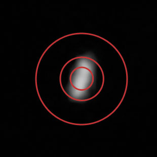

After thinking about it a bit more, I'm not so sure that it really is a 35mm rule. I remember my Dad teaching me this rule at a time when we used nothing but medium-format cameras. Could it be that the rule is an older medium-format rule of thumb and was carelessly carried over to 35mm?
The smaller the format, the more critical camera shake is.
The attached sample shows the 1/60s exposure with a 50mm lens again. This time it also shows the standard CoCs for 35mm, 6x6 and 4x5. Judging from this shot, I'd say that 35mm needs a tripod or a faster shutter speed, but MF would get away with the rule of thumb. LF has no issue at all, but a 50mm lens is unrealistic for LF.

The really interesting point is that your father taught you this for MF. Historically, the rule of thumb was developed [pun intended] for MF and then in the 1960's and 1970's at the photo stores I worked at*, we started telling the customers to use the rule for 35mm cameras.
Steve
* one was Baker's Photo on Wisconsin Avenue Washington DC NW
That's what I thought. Thanks for setting that straight.
As the attachment in post #12 shows, moving the rule from MF to 35mm was a leap of faith, but, as others have pointed out, it's just a rule of thumb anyway. For optimal resolution, a good tripod and solid ground are essential.
