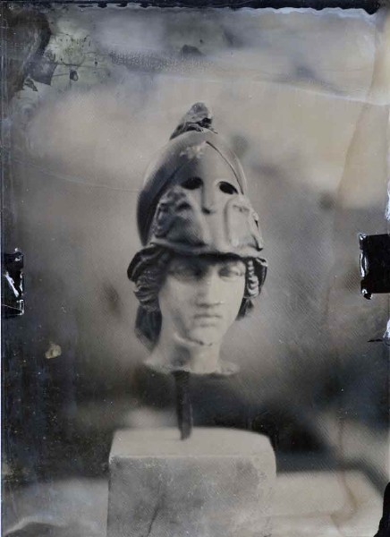

I would love to duplicate the bokeh on this Ruby Ambrotype
by Richard Mellor.
I will be using a 8x10 camera, any recommendations.

My guess
Judging from the detail in the background in the upper left of the ambrotype, it appears to me that the whole backround was too sharp and the photographer applied some type of treatment to the negative to mush it out.
My impression is that the bokeh is not the result of a lens. It is unlike the other images in the group.
But like I said, that is just a guess.
Vaughn
Looks like a Petzval type lens, most of the collodion-crowd use them, but I can't be sure. Note however that the funky background is mostly a result of it being an ambrotype, and would not be replicable with regular film; there was no "treatment to mush it out".

JG is being modest! He is an excellent wet plate artist as well as daguerratypist (sp). Also check out the APUGer's galleries here as there are several wet plate artists among us--Kerik, Allen Friday, and even me although artist is a stretch for me! You ought to try it as there are some excellent teachers out there including Kerik, JG and Erick Taubman in NYC there. It is well worth the effort to learn as it is a medium that is full of magic, petzval lenses and all!
Hope you get a chance to try it some day as it is so much more fun to make an ambrotype than to dublicate the look of one!
