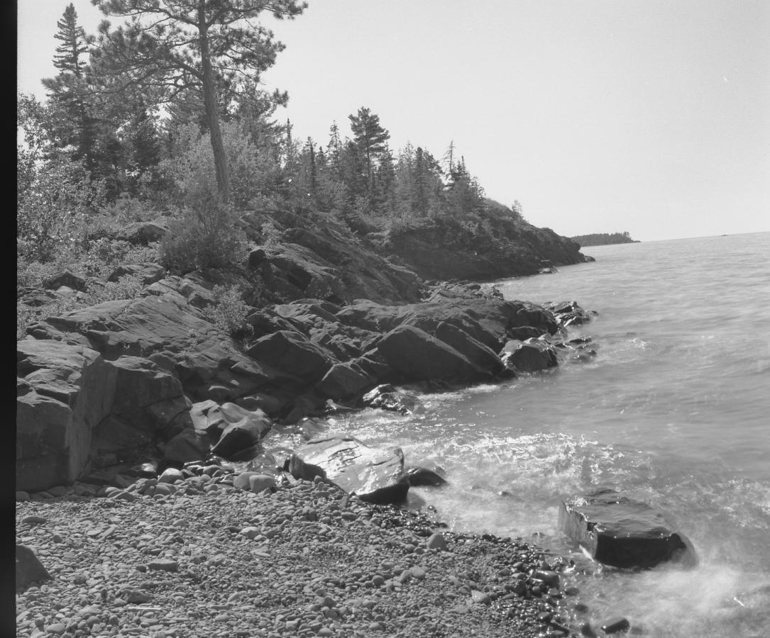

Relatively new to 4x5, but took a couple of shots several weeks ago. Turned out OK, nothing esthetically great, but technically good.. if you overlooked the dust. That's when I understood what folks were saying about cleanliness while loading, etc. Anyway, developed them (TMAX 100) in D76 straight in a Combi tank and all was well.
Took the camera up on vacation with us and took some holders loaded with TMAX 100 and some with 400. Going to sleep the night after taking the first two shots it suddenly dawned on me, I forgot to close the preview before pulling the dark slide. Duh! Oh, well...
Took a number of shots using up both the remaining 100's and then the 400's. I started developing them today and started with the 400's. As careful as I was, I still managed to load two sheets into the same slot in the Combi... kiss those two sheets goodbye. I used D76 1:1, 12 min. Boy, talk about terrible. Not sure what's wrong. Muddy and lack contrast. Back to school I guess.:mad:
Thankfully I took some 35mm cameras with me. At least those shots are OK.
I know some folks have had good success with the Combi, but I do see how some dislike the time it takes to fill/empty. Seems like they could have designed larger light trapped openings.

Thanks all for the feedback. I had just done two rolls of 35mm, also TMAX 400 in a 2 reel Paterson with no problem using the same methodology. I know some folks don't pre-wet, but I always have, one-two minutes, bang it a bit to dislodge bubbles, drain and pour in developer. Used the same methodology with the 4x5 in the Combi. I did notice one thing with the development, or attempt, at doing 6 sheets in the Combi. After the pre-wet, while draining it, there was a distinct blue-ish tint to the pre-wet solution. I never saw that on the 35mm or the two sheets I had done previously. It was dark enough for me to think, "what the...?"
The chemicals were all 69-70F degrees and as per habit, agitated first 30 seconds, and then 5 sec. every 30 seconds using inversion method for 12 min. One other difference was the first two sheets I ever developed were in straight D76 for the approp. time for that solution. The negatives did look under developed to me also, so perhaps I screwed up on the 1:1 somehow. Next sheets I will go back to straight D76 as a control.
As for my newbie mistake with the preview/dark slide, my lens (Symmar-S 5.6 150) it does allow you to trip the shutter even if the preview is still open, but it will close after tripping so a test fire is probably a good bet in the future in case I have forgotten to close it. Closing it is now pretty much ingrained, but the test firing would be a good double check.

Thanks all for the feedback. In analyzing the negatives, I believe the problem is related to the development. Oddly, one negative was more or less fine, two sandwiched together because of may gaff loading them to the same slot. The others were dark/muddy with barely an image. Either I did not fill enough, used poor agitation, etc.

Round Two..what a disaster... back on track?
Not that the picture is all that exciting, but it seems I just flubbed the development first go-round. I did go back to straight D76 on this one since it worked fine the first time, but shouldn't D76 1:1, with appropriately adjusted dev. time work also. I noticed in the Kodak tech sheet info. for TMAX 100, it gave some suggested times/temps for 1:1 in small tanks. It seems the Combi fits somewhere between small and large? Anyway, should 1:1 work? It could save some chems while I'm learning.
Notice the band along the left. I'm guessing this was from not loading the holder correctly. I took an old sheet just now and I guess I should have ensured the sheet was slid all the way in before closing the hinge.:rolleyes:
At least I seem to have gotten the dust under control. The first two sheets I ever shot and processed looked like large biological slides with nano worms and other small critters showing.
Thanks for all the suggestions, particularly the dry firing of the shutter to ensure the preview is closed and encouragement, definitely not giving up.
