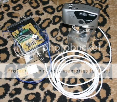

I built a basic rotating panoramic camera from an olympus compact.
I gutted it, keeping the only the shutter and film advance, and then brought wires for these things out of the bottom.
There is a small control unit with a microcontroller in it.
The camera itself is mounted on a stepper motor, and swings round, while the film is advanced past a slit.
It needs more work, and a reduction gearbox for the rotation axis, but it does work after a fashion.
(apologies for the width of this image, but it's... well, panoramic :wink:

BTW, that's me, just right of centre
The computer screen to the right of me is displaying some of the program for the camera.
Just to make it clear, this camera does shoot film, the only digital bit is the drive electronics (much like all recent Canon and Nikon SLRs)

Ben, very nice, obviously some more work needed, but a bit of fiddling never went astray.
I run stepper motors on my LASER and they have the ability to step in 1/1200" increments. This means that the beam is moved around in a stepless or seamless fashion, so to speak.
Going on my experience with a friend and the aforementioned rotating camera, try a faster rotation and a bigger slit opening for less banding. If you can of course!
Mick.
As the slit is card and gaffer tape, and the stepper is software controlled, it's fairly easy to modify various parameters of the system:smile:

ben-s,
How do you steer the rewind or wind motor. Are they originally stepper motors too, or is a potentiometer sufficient?

ben-s,
The motor in the film advance is a small DC motor.
I drive it with PWM (Pulse width modulation - skip the next bit if you know what this is)
----lecture mode on----------
PWM is a method used to drive analog devices such as motors or lamps at a variable power from a digital source.
A digital signal is either on or off, so anything connected to a digital signal source will be either fully on or fully off.
This isn't very useful for many applications, as we often require variable power.
This is accomplished by flicking the digital signal on and off very rapidly, so that the attached device is only powered for part of the time.
By varying the ratio of on time to off time, the power (eg speed or brightness) may be varied.
----lecture mode off-----------
In the program, I can vary the PWM rate (and thus the speed) of the advance motor, and I can also vary the step rate of the rotation motor.
When I reach the end of the film, I reverse the polarity to the film advance, and apply full power. This automatically flips a gear into place inside the camera to rewind the film. (The wind/rewind changeover part was originally in the camera, so I just left it there and made use of it)
