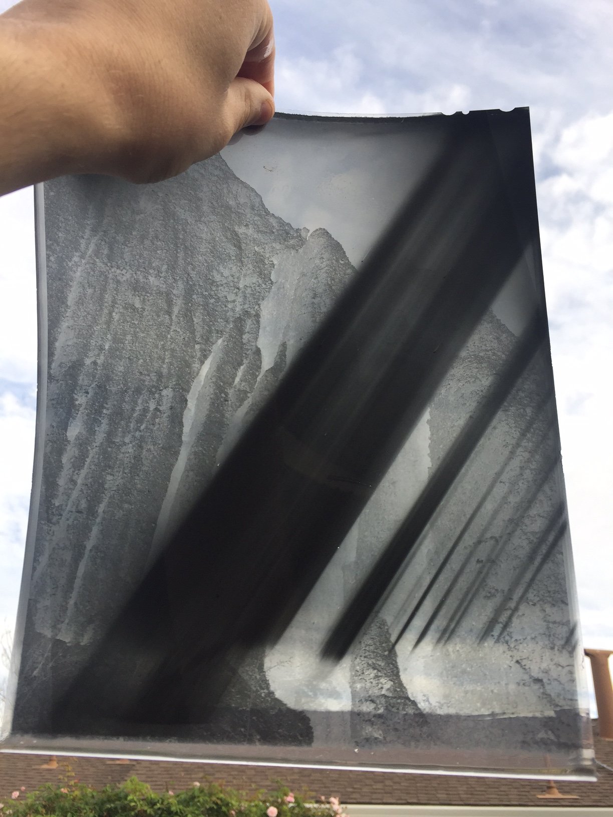

Hi all, I've been lurking on the forums for a while and I've worked up the courage to ask a question. I've run into a problem I am hoping someone can help me with.
I have recently acquired a new 8x10 camera and am switching over to a new developing regiment. I have started rotary processing with a Jobo 2830 tank and a Ilford motor base. The first negatives I developed with the new camera and processing were completely destroyed.
The corners are fogged and there are thick streaks of fog across much of the image. These streaks do not look like they were caused by a light leak in camera. My guess is something to do with my processing technique; however, I have spent the afternoon systematically going through each variable of my new workflow but everything is working fine now.
-I used a film holder that I know is light tight with the new camera. I then tray processed and the negative came out perfect.
-I suspected it could be the speed of the rotation of the new motor base, so I used a rotary tube I know is light tight. The negative came out perfect.
-Finally I used the new camera, jobo tank, and motor base. The negative came out perfect.
The final run was nearly identical to the original run that destroyed my test shots with the new camera.
The only difference is I used a prewash for my last run and did not for my first.
Could it have been the lack of prewash?
I can post a picture of the negative but I do know if it is against policy to post a d*gital picture in the analogue forums.

Please post copies of the negatives.

Light strike, loose cap on the drum? Be careful with the single direction roller , I had some "bromide drag" very light underdeveloped streaks. I would just double check your self and keep going. Somehow you got some light strike on the film. Looks like the part that wasn't fogged is nicely developed

Looks to me like light got at the film - into the developing tank?

My final attempt I made sure the cap was tightly on so I think its definitely possible the top of the jobo tank wasn't properly locked down. It did seem attached the first time which makes me a little worried to use the tank.

I agree with mshchem that you may have a light leak in the tank. I also use a JOBO rotary tank to do 4x5 sheet processing,and have had no problems. No have I ewer pre-washed film. Development times might be longer because developer needs to moisten the film emulsion. I remember reading in some Ilford literature that they recommend NOT using a pre-wash, but that may hold only for short development times. Pre-washing films is not "good" or "bad", just pick one method and be consistent.
As part of my development protocol I reverse the direction of the tank rotation every minute, as well as do a little agitation (by giving the tank a shake). Since my motor base is also uni-directional, I just flip the tank end-for-end.

Thanks for all the advice.
I ran another couple sheets through after dinner making sure that the cap was properly seated. The negatives are drying now and seem to have no issues. I ran a sheet through completely unexposed as a negative control and it came out completely clear.
I might gaff tape the cap just as insurance in the future, I didn't realize the caps could be that finicky.

How could a light leak in a tank produce such sharply edged streaks?
Also there are two levels where the streaks end, at the wider and longer streak one can see that level too.

I bet the lid (not cap) you are using does not have a light trap insert underneath. Show us a photo of the underside of the lid, looking straight through the opening.

That was my very first thought too, but I was puzzled by those sharp edges as well as the parallel orientation of the streaks.

It's possible that the red ring was not snapped down tight . There are 3 or 4 "teeth" that need to be fully engaged, it could be that this could act as a pin hole ?? Just another guess. The problem is resolved and the OP is getting good results, may just be, one of those things.

Looks like the light snuck in from the end of the tank where the un-notched end of the film was. But it sounds like you got it figured out.

I think it was most likely the teeth weren't completely locked down. Upon closer inspection the marks look very similar to how the red teeth on the inside of the cap look. The angle of them matches the direction of the sun at the time so it all seems to fit.
I am getting good results now.
I can post a picture of the inside of the cap but I checked it for light leaks in the darkroom and it seems lightproof when fully locked down.
