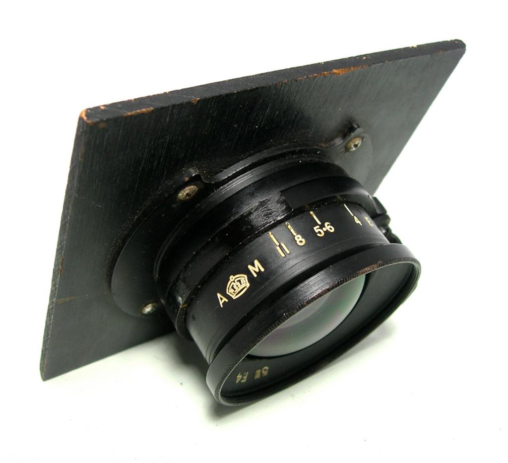

I'm actually just guessing its a Ross lens since other than the Air Ministry marking and a type number, there's no manufacturer's info.
The lens had two problems when I got it - haze between the elements and the aperture didn't work. The rear element assembly came out easily enough and by removing the set screw I was able to get between those and clean them properly - haze there is now gone.
I was able to remove the front cell assembly by removing a set screw there and was then able to unthread the aperture control ring. The aperture itself is fine but the screw between the ring and aperture is sheared off. If I can't scrounge a small enough screw, I may just try a dowel or similar to re-establish that link-up.
So, the remaining problem (sorry for being so long winded in getting to here) - there's a bit of haze between the front elements but I can't figure out how to disassemble them. Anyone?
Thanks,
Dan
